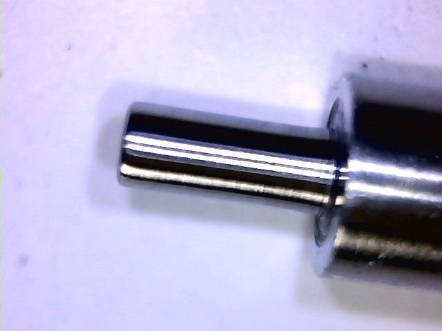

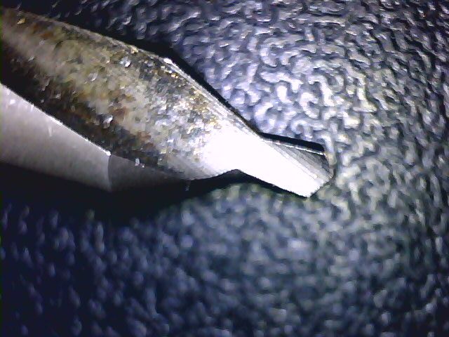

            Here is a picture of the tip of a no 2 centre drill I have just taken with one:
            .. and 50 thou diameter clock pivot:
            They are better than nothing but can't compare to a decent binocular microscope. The worst thing I found is the stand – throw it away and make a decent one.

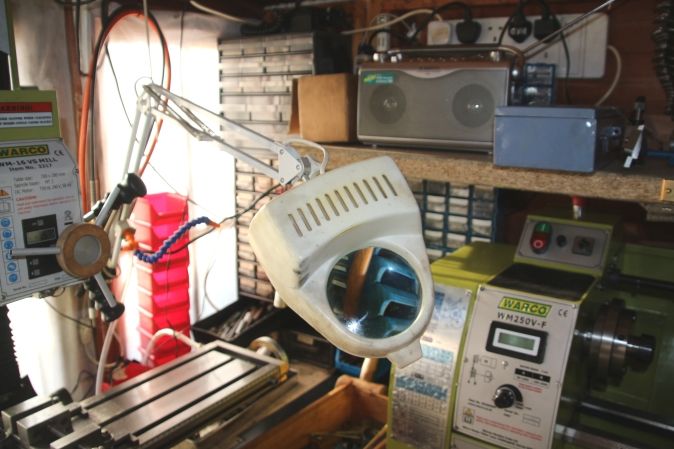

                            Someone a while back had an article in ME (I think) using a web cam as a centre/edge finder.
                            My old eyes continue to weaken as well and I am now on 4.5 for reading so
                            I use an American made Bausch & Lomb stereo microscope for very, very close work.
                            But most of the time I find this angle poise illuminated magnifier an absolute godsend.
                            Both items outrageously cheap from my usual supplier – the Sunday boot.

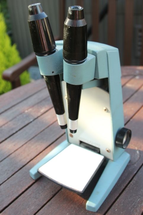

                              In the end I ditched the idea of a USB microscope and bought a lovely Olympus stereo binocular microscope off ebay in excellent condition despite being about 40 years old. These instruments are perfect for low magnification work and you don't even have to switch the computer on. There is something very satisfying about using a good quality instrument where everything moves so smoothly and precisely.
