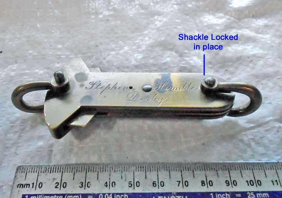

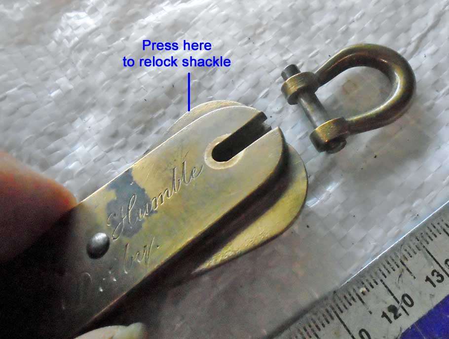

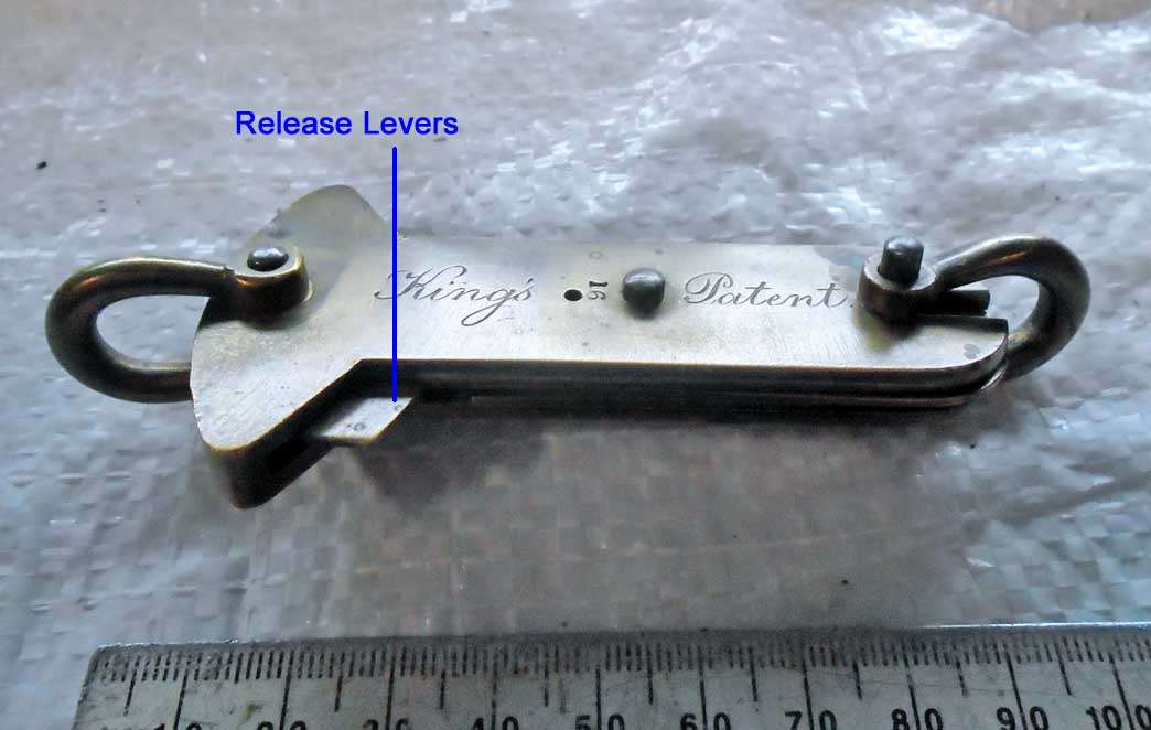

      Hi All,
      In this weeks haul was this very nicely made brass quick release for a small shackle.
      I am clear how it works but wonder what application it might have?
      Lovely script makers marks etc as shown.
      Cheers, Martin
      qrelease 2qrelease 1qrelease 3

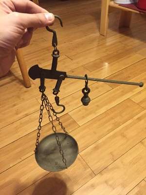

        Weighing on a scale comes to mind.  For detaching the scale-pan, perhaps on a steelyard.  The picture is of a little one, but they were often hung from a beam in the ceiling:
        steelyard

            You describe it as quick release, but another possibility may be remote or automatic release.
            If it had load on it and the body dropped into a hole, the top of it is wider so would catch on the edge of the hole and trigger the release.
            It might be useful to speculate on whether the King of the patent is a person’s name (the inventor) or the title of a monarch.
            Does Grace’s Guide or similar have anything to say on the humility of Stephen?

                  Following on from Diogenes post it would be useful for releasing a flag to change it if you could have lots of shackles. While it would work well for keys (eg for a jailor) the shackle style is more in line with a builder’s or military use. Or railway.
                  #823240
                  DC31k
                    @dc31k
                    Coincidence?
                    GB189700661
                    If we admit the connection, could the pictured item be something akin to a salesman’s sample? A model to demonstrate the principle in an office setting.

                      Looks very similar to an overwind protector, otherwise known as a detaching hook. Positioned twixt rope and cage in a mine winding setup. If the cage is wound too high the cams are pushed in and the rope comes free, the cage is then prevented from falling by some other mechanism. Similar set up shown herehttps://www.fifepits.co.uk/starter/safe-3.htm

                          See:
                          Stephen Humble's detaching hook, Min Man & Min Yr Bk 1926
                          https: //www.flickr.com/photos/28709338@N04/25357092536
                          Also, for me, putting “King and Humble’s patent safety detaching hook” into a standard Google produces this as the AI overview:
                          “The King and Humble patent safety detaching hook is a crucial safety device used in colliery (mine) winding installations to prevent accidents from overwinding, where a miner’s lift cage or kibble is drawn past the normal landing stage and up into the headgear. The hook was originally patented by John King in 1867. Stephen Humble later made improvements to the design, which is why it is often referred to by both names.”
                          That would explain the “King’s Patent” on the one above.
                          I think a lot of the overview has been derived from this page:
                          http://www.dmm.org.uk/colleng/4406-01.htm

                                  Seems like a different version of the detaching hook is still manufactured
                                  https://edwardormerodandco.com/products.html

                                    I still wonder if Martin’s version is a salesman’s demonstration item or a promotional give-away. It seems too small for a hoist part. Even if it bronze rather than brass a shackle of that size won’t take much load.
                                    Robert.
                                    #823420
                                    Martin King 2
                                      @martinking2
                                      Salesman’s item makes most sense to me also. Neat little item though!
                                      Martin
