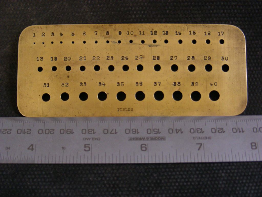

      Does anyone recognize this?
      It was given me by a (now deceased) friend with an interest in clocks. As an indication of size beyond the rule, the no 3 hole is about 0.040".
      I don't think it is a gauge for measuring pearls!

        Possibly a watch or clockmaker’s tool

          Hmm, goes against the usual convention of larger numbers representing smaller diameters. No ides

            Looks a bit like a Wire Drawing Plate to me, used for pulling annealed wire through to gradually reduce its diameter.
            Unfotunately I cannot remember how the hole numbering system works on those (age thing).
            P.S. I think there is a power tool manufacturer called Perles.

              Looks like a gauge for measuring wire size using something like BWG (Birmingham Wire Gauge)

                Bead, pearl,  stone gauge.

                    Wire drawing numbers always get bigger as the holes get smaller, because they are a count of how many times the wire has been through the die.

                      Perles being French for pearls may confirm info above 🤔🤔

                              Pearls,etc it is!
                              Thanks to those who identified my gauge; interesting that beads, pearls and stones (diamonds) are apparently measured in the same way and difficult to see what use or ornament a no 1 pearl would be.
                              John Flack: I was aware of the French word which, on checking, I see also means bead and howler.
                              The absence of a maker's name suggests that it may be shop-made.

                                  EGA, seed pearls in jewelry are going to be about size 1. If you want even sizes then a gauge is needed.
