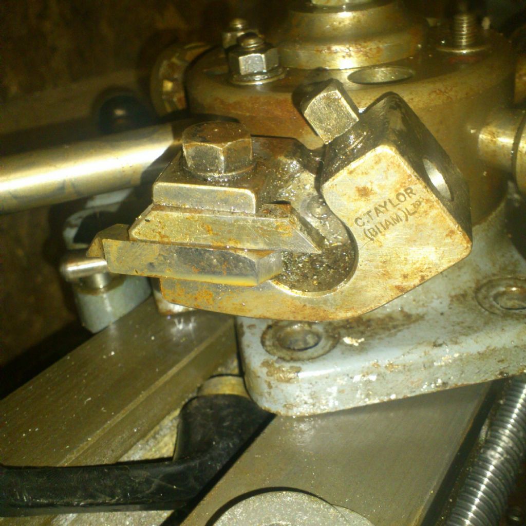

      Right. Number 1 (clueless as to what to start searching for. I think I can see what it should do but need to search for more info)

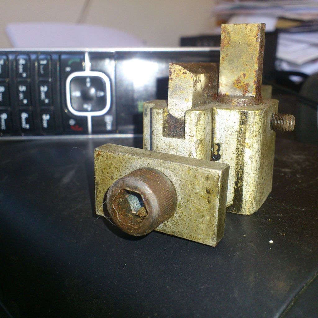

      Item 2 (Similar to one but without guide rollers)

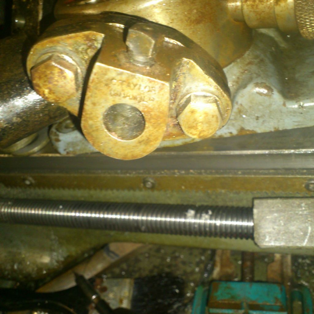

      Item 3 (I know what it looks a bit like, offset boring bar but doesnt seem to go "offset"???

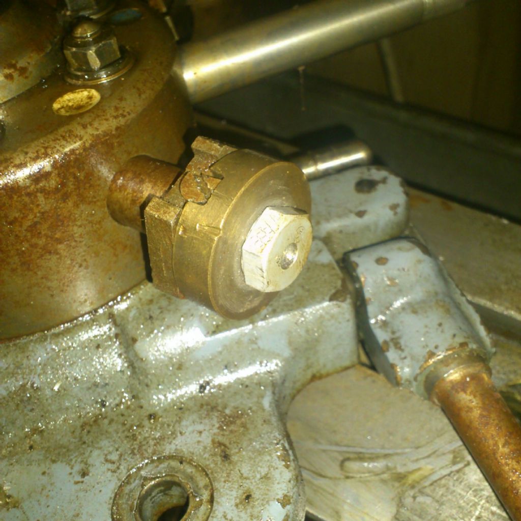

      Item 4 (Totally clueless)

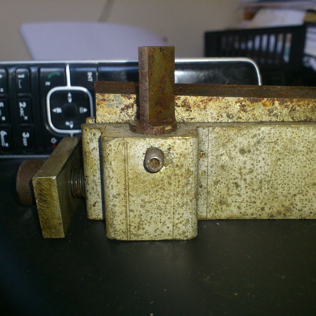

      Item 5 Well, I think it is a die holder but its complexity makes me unsure. When it pulled "out" it exposes 2 pegs and will rotate (one direction only due to the springs and rollers inside) When its "back together. The pegs stop it rotating any more.

          Looks like the following:
          1. Roller box, for reducing the diameter of stock, rollers act like a travelling steady
          2. Same as 1, presumably for short lengths where rollers are not needed
          3. Probably for holding round shank tooling, such as a Coventry die box
          4. No idea, but it seems to have some adjustment, so may be this is for boring bars?
          5. As stated, probably for holding dies; the pegs will pull out when the correct thread length is reached. The lathe is then reversed to remove the die from the work.

            1 Roller box tool
            2 could be a tangential turning tool but looks like it should have a brass bar through the round hole as a steady
            3 to take drills and reams etc. You can slacken off, clock the tool up and lock it in place
            4 looks like a boring head
            5 Holds taps and dies, I have one sa next to me.

              3 .. used for round endworking tools.. ( norrmally) two piviots allow adjustment of center height..( boring bars)..
              still used in production to this day.
              4 again drill / reamer..holder ….. hex bit is adaptor bush to fill in gap from ( looks like 1/4&quot to the holder size.

                2 Tangental roller box
                3 unsupported tool holder for chamfering etc.
                4 Adjustable reamer holder
                5 Looks like a tap holder
                6 Die holder
                #97441
