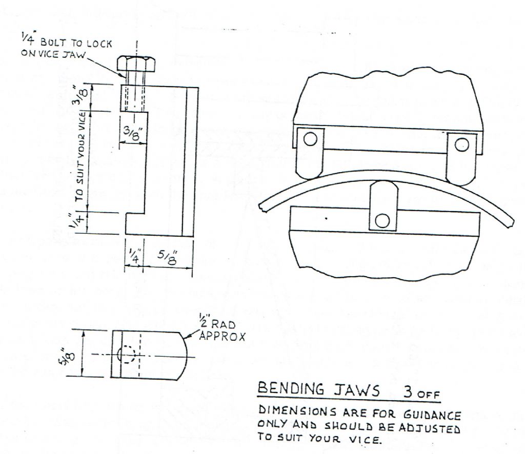

            I was thinking along these lines Jason. Do they not tend to slip sideways in use, or are they retained in some way?
            Regards Maurice
            #199603
              The ones I made clamp onto the jaws.
              #199617
                Wouldn't having the wider spaced jaws in one piece or mounted on a bar help?
                #199636
                  The vice jaw acts as the "bar" to mount then on. Being able to close them up can help when bending a tighter radius.
