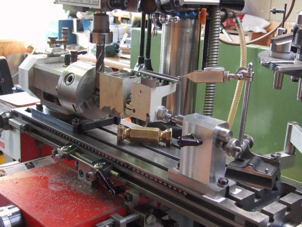

      I had a visitor to the workshop recently come bearing gifts. In the form of a much used Unimat 3 less original motor. The visitor said he had been given the machine some years ago and only came across it while clearing out the garden shed.
      If I could make use of it, then it was mine otherwise it was heading for the skip.
      After removing layers of swarf which had congealed with oil and formed a shellac work was started on stripping the machine. While everything was red with rust the bedways were in good order with some slight staining. Clearly the oil on the bedways had done its job in protecting them.
      After running a clock over the working surfaces of the Bed there as no more than 0.01 mm maximum wear.
      The tailstock working surfaces and the carriage working surfaces were not so good. while there was only about 0.05 mm wear the surface seemed to be filled with abrasive.

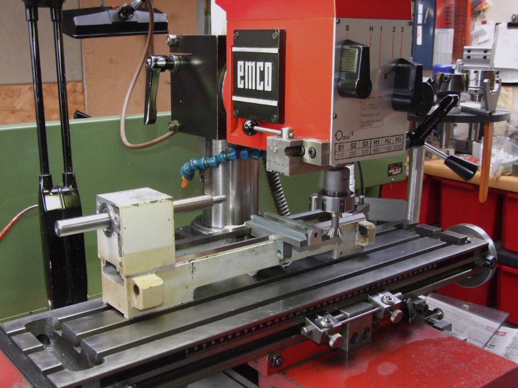

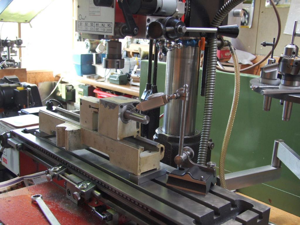

      Thus yesterday I made a start on machining the faces back to new. The Vee ways can present problems. Thus I opted for using the Dividing Head to guarantee an exact 90 degrees. Which also made machining the flat easy.

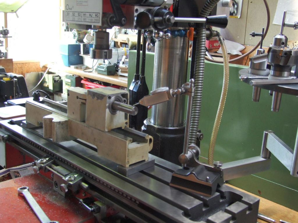

      Having the Headstock with an undamaged surface it was easy to establish what height the flat was relative to a roller in the Vee way. Machining the two items on a common mandrel ensured that alignment would be maintained.
      Before the parts were removed from the mandrel a check was done on the Bed to ensure the mandrel was true or parallel to the bedways.
      The last operation on the Headstock was to put Helicoil inserts in the tapped holes which hold the motor mounting plate, apart from painting.
      More to follow.

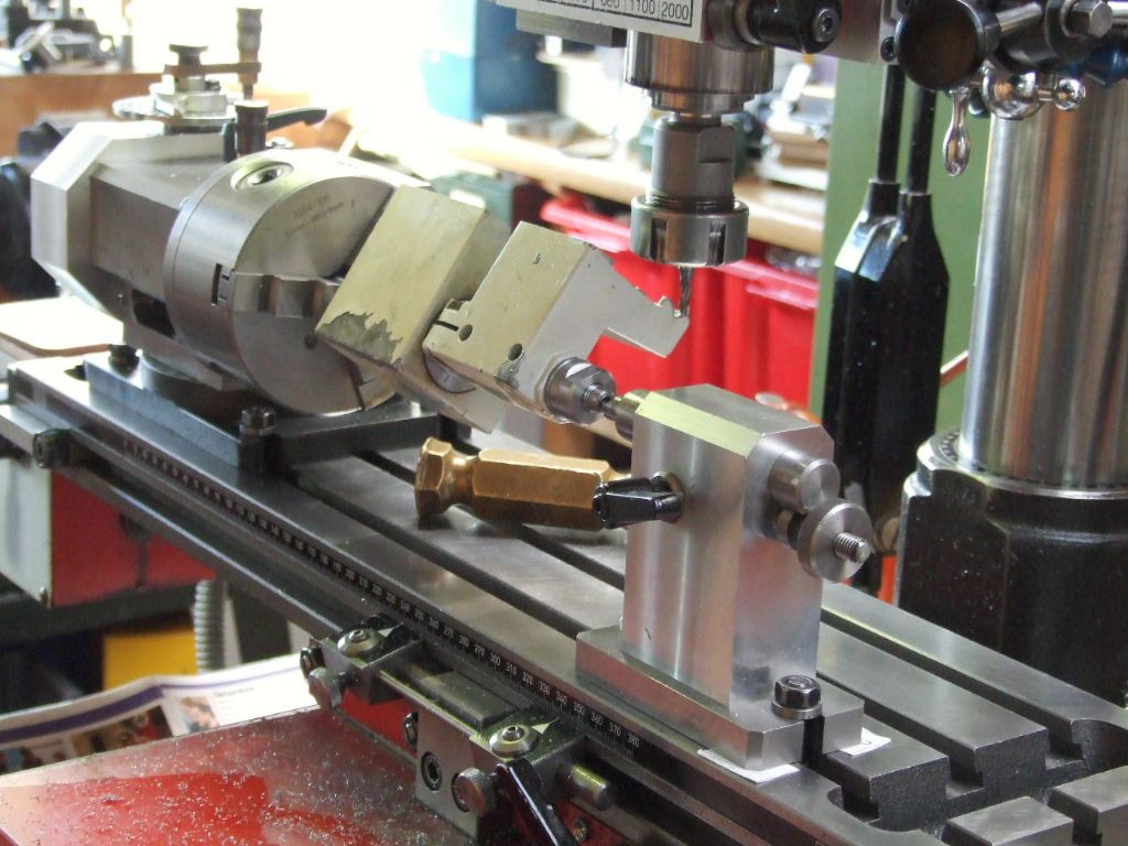

              Well after much prevaricating I decided to set the lathe up with a slight cant. It amounted to a quarter of one division on my 0.01 mm clock.
              Running a further check over a hardened dowel pin on the un-worn portion of the Master dovetail on the cross-slide showed on error. Thus I concluded I must have hit on the original factory setting, first time round.
              While the machine was on the milling table I also cleaned up the front face of handwheel boss. Just in case I need a flat face to reference off at a later date and also to remove the wear. Swarf at sometime had been trapped there and produced anything but a good running surface.

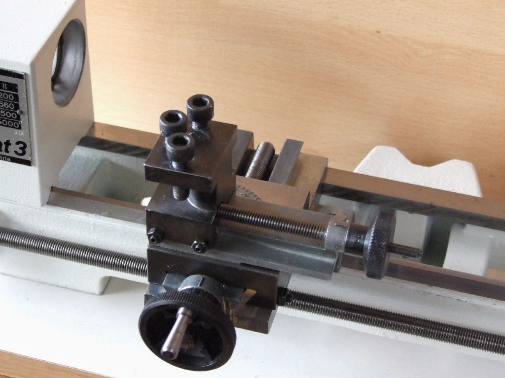

                                  On Monday the parts went to the Paint Shop, (aka the Summer House). This being warmer than workshop. I will be first to admit I am no good at paint spraying, but I am pleased with my efforts.unimat 3 back from the paint shop.jpg
                                  I have also taken a photograph of the Cross-slide and Top-slide. The Brass Gib on the cross-slide is easy to spot.
                                  Lastly yesterday was spent on a salvage scheme for the Longitudinal feed nut. The original die-cast nut had worn quite considerably with 0,25 mm backlash. The new Phos Bronze Cylindrical nut has reduced the backlash to 0.05mm. Which is not bad considering it is the original feedscrew.

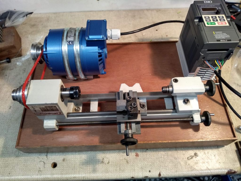

                                    Are you going to reproduce the original spindle? I made an ER16 spindle for mine using a parallel shank ER16 collet chuck, but it wasn't entirely satisfactory so have reverted to the original, but I would like to have a proper try at a complete spindle with ER16 taper and M22 thread.

                                            I was hoping that you would put a rack feed on and convert the feed screw to a proper screw cutting setup with change wheels. I could measure up my fine feed if Emco don't come through.
                                            They need a better belt drive too, I mentioned on the current SL thread how I converted mine to toothed belt drive. Poly V would be another good way to go.
                                            #569681
                                              Gray if you need it I can pull my feed apart and give you sizes.
                                              If you did want to go down the ER spindle route a plain shank/ M14 adaptor would allow the Emco stuff to be used all be it with more overhang. I got one about a year ago and have used it a few times with the 4-jaw when I can't be bothered to change the 5C to 4-jaw on the warco. It's quite nice for small eccentrics etc
