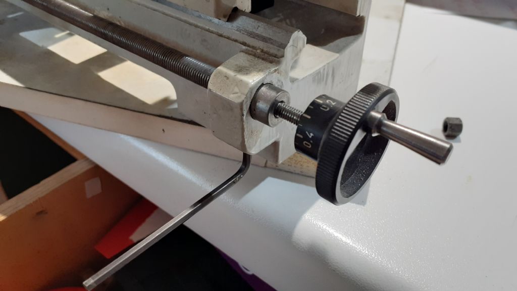

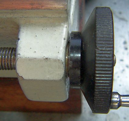

        Hello:

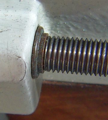

        The OEM carriage feed screw on my Unimat 3 one came with damaged threads at the end of the M5 section, where the handwheel is fixed.
        I managed to solve that problem (temporarily) by doing away with enough of the cylindrical part of the handwheel so that the nut that fixes in place would thread in properly, losing the ability to have an idea of how much I was advancing the carriage.
        The other very annoying problem it came with was that the edge of the plastic with the numbers/divisions rubbed against the end of the bed.
        This because, instead of a uniform flat surface at right angles to the bed, it has a roughly finished curved one. 8^°
        Putting a light bevel on the plastic and adding a polished brass washer made a world of difference.
        So, aside from a new handwheel, I am going to need a new carriage feed screw.

              Julius – I may be at cross-purposes, and my U3 is not to hand, at present, so what follows may be less than helpful…
              The leadscrew should indeed be well supported at its right-hand end, but it is minimally loaded an any radial direction, so a 'feeble'-looking bearing, of small diameter, is OK. What is critical, however, is that the leadscrew must be properly axially constrained, thus thrust bearings are required to react screw thrust in both directions. The thrust bearing arrangement needs to be adjustable. Emco's threaded handwheel and nut design isn't the best – in fact their feedscrew axial constraint and thrust bearings are poor on many of their smaller machines – but, with patience and bad language, it can be just about be made to work – just not very nicely. You've already discovered that it may be necessary to fettle the face of the handwheel.
              What happens at the leadscrew's left-hand end doesn't really matter, as far as axial constraint is concerned, so an apparent gap is OK.
              If this isn't clear, the point is that axial constraint of the leadscrew should be afforded by its right-hand bearing (only). Plenty of opportunity to improve things here…
              You could probably salvage the right-hand end's end (?) by axially drilling the leadscrew and fitting an extension into the hole (threaded + Loctite), and then turning it back to desired dimensions to fit bush, handwheel, etc..

                Would have been easier to counterbore the handwheel so the nut could be screwed on further and then no need to machine off the markings. Could still be done with a replacement handwheel.
                Rather than shaping the end of the handwheel and using a brass washer all that is needed to get clearance is to  slide the bush out a bit so the handwheel doe snot contact the casting. Loosened mine off to show how it can be slid out (not that much) so handwheel does not contact casting As Kiwi says let the left hand end float axially

                  Agree with Kiwi Bloke, drill into the end of the leadscrew, tap it and Loctite in a stud of the correct length and thread. My bet would be that if there is any hardening it is only on the surface, not through to the core.

                      Moving the Leadscrew Bush to the right a little would have removed any fouling problems as regards the handwheel rubbing the Bed. Rather than reduce the Handwheel a simple grubscrew inserted into the handwheel and impinging on the end of the M5 leadscrew thread would have locked the two together.
                      Emco used to use this method of locking on the Emcomat 7, Compact 8, with an additional lock nut.

                            Backlash/movement of the leadscrew is adjusted by how far the handwheel is screwed onto the 5mm thread and then locked in position with the domed nut, this sets a slight gap between the 8mm dia of teh screw and the face of the bearing. There is no need for all those washers, properly adjusted the handwheel won't seize or rub against the casting.

                                Yes. But the 5mm threads in my U3's leadscrew were damaged when I purchased it. There was no way I could adjust that properly.

                                      Lightly skimming the end of the handwheel to get a flat surface would not have removed the entire graduations.
                                      Removing the damaged M5 thread portion would have meant the end of the Leadscrew was now inside the handwheel.
                                      Inserting an M5 Grub or Set screw into the M5 hole would have locked the the handwheel to the leadscrew, after most of the play had been removed from the assembly.
                                      If the Grub or Set screw was sufficiently long enough an M5 nut on the outside would have further locked this setting permanently.
                                      As stated previously this is a standard Emco adjustment.
                                      Using this method and a replacement handwheel would not require a new leadscrew.

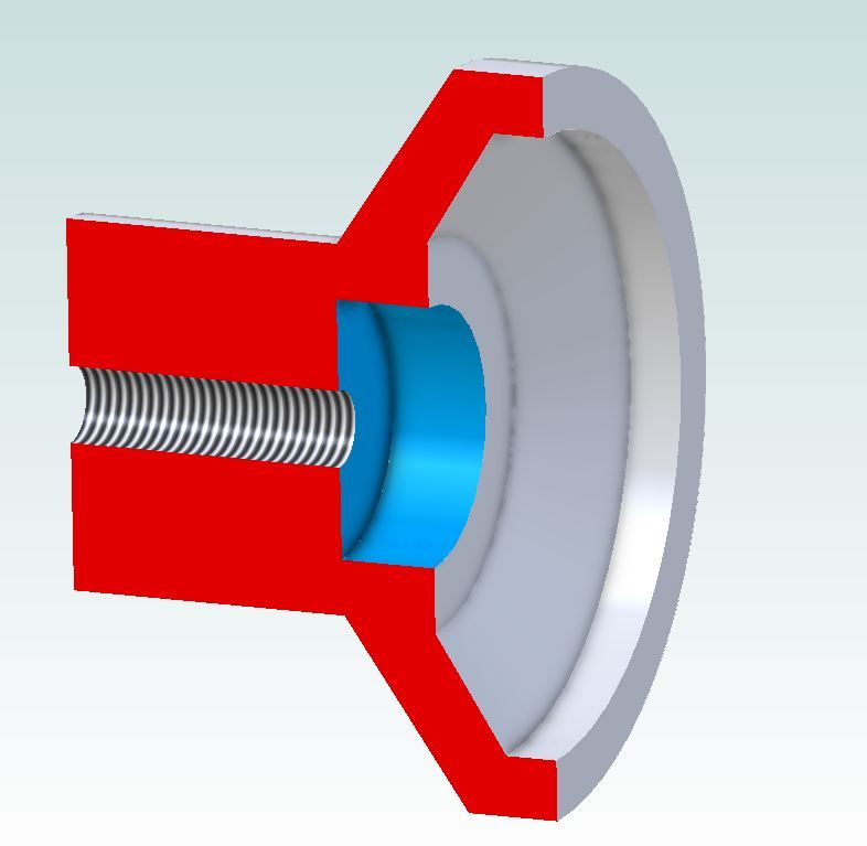

                                        Regarding your idea of having a larger diameter thrust face 'where the inner surface of a new, different handwheel will land on', just be careful. The face of the handwheel must run without wobble, but this is difficult to achieve if it's located by a non-precision, sloppy thread. The larger diameter, the more this is a problem. You may end up with a handwheel whose resistance to turning varies with rotation. That always feels horrible.
                                        I would direct more attention to the right-hand end of the leadscrew and its bearing on the bush. I think Emco tended to make feedscrew thrust bearings too small in diameter. An interposed hard steel shim washer can work wonders. This is the thrust bearing that takes the cutting forces – the leadscrew is trying to escape to the right.

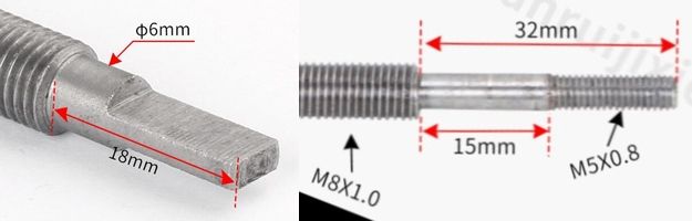

                                            So I have sent for a replacement feed screw from a vendor of all things Sieg at Aliexpress. If the photos are anything to go by, it looks like it is much better made than the one from my U3:
                                            The main reasons for having sent for a new one (aside from the original one being 43 years old and in awful shape) being the ready-made availability and the real life difficulty of getting a shop to make a bespoke one for me, much more being just one and not two dozen.
                                            My plan is to make a part with the same diameter as the left end of the leadscrew (6mm) and a full length concentric hole with a M5x0.8 thread, obviously with a non-threaded part for it to fit properly.
                                            This part will most probably be made out of hard bronze and be threaded into/ locked with a suitable (soft) anaerobic to the right end of the screw. The length this part will be defined when I decide how to fix a new handwheel and/or some attachment. eg: a toothed pulley to drive the feedscrew FF / FR using a small 12V motor.
                                            The right end of the feedscrew, now having a longer ⌀ 6mm end with a male M5x0.8 hole will run inside a new, longer steel bushing with a flange on its right side, maybe with a small recess to hold a small thrust bearing if I can find a suitable one.

                                                  Yes, which is why the flange I am planning to add to the new bushing will have to have a thrust bearing before the new handwheel which would also provide the smooth running hard steel shim washer you mention.
                                                  The thing will be to source the right size bearing with a 6mm bore.

                                                    Of course … 8^)
                                                    Right threads end | -> bushing with flange | -> flat thrust bearing | -> handwheel  <<- leadscrew inserted from here
                                                    ^^^ This whole arrangement, if properly assembled, can be removed/replaced buy just loosening the set screw at the right hand side and unscrewing the last few cm.
                                                    Than you for your input.
                                                    Best,
                                                    JHM
