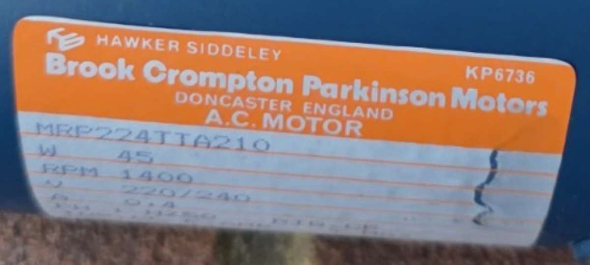

      Good afternoon folks.
      Thank you for letting me join.  I wonder if you can help me?
      I’m an ultra newcomer to the world of engineering – and in particular, lathes.   I’ve bought an old lathe (minus the motor and related on/off switch & speed control kit) with the intention of turning some wooden parts to make some wooden toys for my grandson (train wheels, train body, car wheels, etc) and also to use with my other hobby of repairing antique and vintage clocks.  I don’t have very much disposable income to be able to buy a ready made off the shelf lathe – I’m having to try and do this with separate components.
      So I’ve got the lathe and now need to buy the power unit.  I understand I don’t need anything very powerful – something that can turn at 1400 – 2000 rpm I believe. Is this right?  I’ve had a look in eBay and there are quite a few small motors for sale but I’m not really sure what I’m looking for so need some help please!!
      There is a Brooks Compton Parkinson motor for sale image attached.  Is this ok?  Will I get a pulley to fit?  What else do I need to buy with regards on/off switch and speed control?
      Thanks everyone,
      Andy
      IMG_7537

        The normal set up is that both motor and lathe (and often the countershaft- to increase the number of speeds available) carry stepped pulleys.
        Often three sheaves on the motor pulley and three matching sheaves, but reversed, on the lathe spindle, for three speeds.
        A countershaft with two stepped pulleys would increase the three speeds to nine. Even one stepped pulley will double the speeds available.
        The speed will be determined by the number of poles in the motor. Usually single phase motors on lathes run at 1470 rpm.
        Your picture shows a 1400 rpm motor. 45 watts is pretty weak motor, and not suitable for most lathe work (Unless you plan to use a watchmaker’s lathe).
        Most single phase motors for lathes are likely be at least 500 watts
        The motor speed for an AC is not variable, it is tied to mains frequency.
        The speed of the lathe spindle is varied by changing the belt between the sheaves of the pulleys on motor and spindle.

            It would help if you had said what lathe you have. For some small lathes like Cowells, Adept, Flexispeed, unimat, weighing less than 100lbs you will only need 200W, while a bigger Drummond, Myford, Zyto, often called a “3 1/2in” needs 500-750W. You are unlikely to need more for the tasks you mention.
            You want a 1450rpm motor not a 200rpm one (which are for fans), or some kind of DC variable speed motor. In the USA it seems to be common to get treadmill motors for variable speed.
            You could make a treadle if you have any mechanical aptitude, in fact if you cannot figure out how to do that perhaps you should take up knitting.

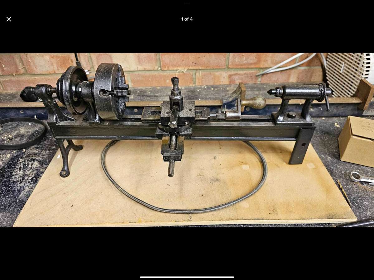

                  Here’s a picture of my lathe:
                  IMG_7535

                        Welcome to the forum.   Interesting lathe.  The spindly legs suggest it’s old, perhaps Victorian, and the layout points to metal turning, not wood.  It’s a small plain lathe, ie can’t cut screws, and though it doesn’t look posh enough to be a watchmaker’s lathe, it’s for that type of work – fine skilled hand turning, mainly Brass, with a bit of steel.   Probably designed for Carbon Tool Steel cutters rather than HSS, but HSS is OK, just don’t thrash it.  Likely gently driven by a foot-treadle, roughly equivalent to about 100W.   So the 45W Hawker Siddley motor is undersized, and 500W is too much!   Too small a motor restricts the operator to shallow gentle cuts and is liable to stall: do-able but frustrating.   The Cowells lathe has a 90W motor.
                        Not ideal for wood, because wood likes to be turned much faster than metal.  A 3″ wooden bowl is spun at about 2000rpm, whilst a lump of steel that size is about 130rpm. Metal lathes don’t turn wood as well as a wood-lathe, again liable to frustrate.   For comparison, here’s a screen-shot of MachineMart’s baby wood lathe, it’s 25kg, speed up to 3190rpm, with a 250W motor:
                        woodlathe
                        Unwise to run the bearing on a metal lathe of that design faster than about 800rpm, and keep everything well oiled!  If previous owners didn’t, it’s likely the bearing is worn out, causing inaccuracies acceptably only to a woodworker!  Another problem is wood and metal lathes not getting on because sawdust soaks up oil and gets into their important little places.  Extra effort needed to keep them clean, or wood dust will damage the lathe – eventually.
                        To spin the lathe at the correct speed, you need a countershaft, see the excellent lathe.co.uk for a description.   It converts the motor running at 1425rpm, down or up to the rpm needed at the chuck.  In the next picture, old-timer treadles the big wheel under the lathe with his foot, from which a belt goes to a ceiling mounted counter-shaft (with 3 pulleys), which in turn drive the pulleys on the lathe’s headstock.  Swapping the belt allows the speed to be changed.    The countershaft can be simplified, or eliminated, depending on the motor and what’s being turned:  a simple 2:1 step down pulley. would convert 1400 rpm to 700, which is a safe top speed for your lathe.
                        https://www.lathes.co.uk/countershaft/img8.jpg
                        Good news, the lathe is reasonable for clock repair, though that will need a range of speeds, usually 6.   Don’t ask me because I’ve never used one in anger, but watchmakers lathes call for watchmaker techniques, which are different from my general purpose turning methods.   The main problem though for that purpose is lack of accessories.  It has a 4-jaw chuck, which is good for many tasks, but watchmakers rely more on collets and a host of other gizmos.   But it would be a good way of learning the basics, and either collecting accessories or buying another lathe with all the gear.
                        Lots of fun to had playing with these.  Just keep expectations low – harder to learn, and quite limited.  They do work, but if takes time and effort to get the best out of them, and that’s extra difficult if the lathe is worn.

                          Your photo shows it is very similar to a George Adams 2 1/2 in lathe https://www.lathes.co.uk/george-adams/page7.html
                          but while several details are different you could use it as an example of what it can do. It is likely that it is intended as a clockmaker’s lathe (ie bigger than watches, not as big as bicycle maintenance) and made between 1890 and 1920. The rotating topslide and central braces inside the headstock are distinctive I think.
                          The site above shows some ideas for a treadle system and through that you can also deduce that the larger size variable speed sewing machine motors would be suitable. Even a small sewing machine motor would get you going as you might easily pick up a broken sewing machine (ask charity shops if they offered one to save it for you) and you can later use the motor for a clock gear cutter frame.

                                      Your lathe is old, very old, likely to be over 100 years old, but still capable of reasonable work, in the right hands, and in fair condition..
                                      Your lathe is almost certain to have plain bearings, most probably the steel spindle runs in the cast iron Headstock, so speed will be limited. 700 rpm will quite fast enough as top speed, and and fairly frequent oiling.

                                          Not read all the previous post but as far as the motor goes ! Anything above 250W is fine for a small lathe 370w or 550w will also work. Speed 1420  (NOT 2850 ) or so,it’s a 4pole motor and 220/240V single phase. Don’t worry about reversing at this stage ( if at all ) but a No Volt Release switch would be a good idea – mounted where you can instinctively hit it as a panic button. The cost of a proper motor starter with overload may not be a priority now but is worth considering as a fuse does NOT protect the motor though motors are reliable.
