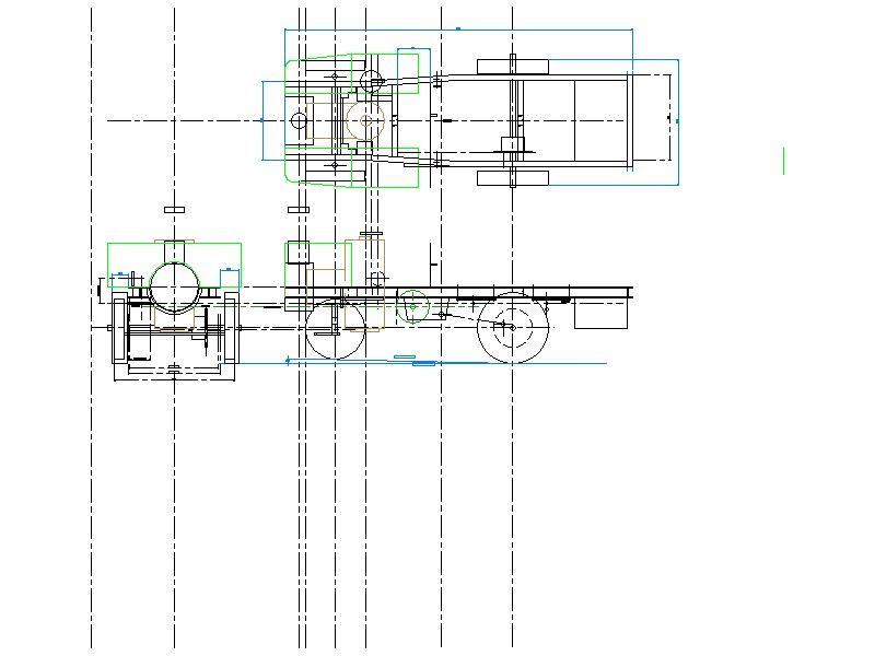

      Any TurboCAD users there who can explain to me rather better than the official 'Help' manual how to copy material from one drawing to another, please?
      I am preparing a semi-diagrammatic General Arrangement of my steam-wagon from measuring the actual vehicle so far.
      I now wish to "fit" into that the GA of the engine, drawn only partially so far but enough for this purpose.
      Copy-&-Paste does not work in TurboCAD. Nor does highlighting the area and dragging it from one to the other with both drawings open and tiled on the screen – unless it entails also holding some key or other down.
      Nor does the Copy tool indicated by the two footprints, though that is among the tools I use most often within individual drawings.
      I have a separate little construction end-view of the crankshaft and connecting-rods, which would have been a start for drawing the engine-case in the chassis. Turning just that into a Block didn't do anything, possibly because it itself already contains a Block – besides I am not at all sure just what those are supposed to do.
      It must be possible otherwise it means drawing the same things over and over again, less efficiently than the manual methods using tracing! I'd still have the problem of aligning the import correctly, of course.
      I append the drawing so far, saved as a jpeg image. As a clue the engine is an enclosed inverted-vertical compound, mounted directly behind the boiler and between the crew seats. (omitted here). The green circle in the middle of the side view indicates the flywheel's location.
      Incidentally it appears to be on a ramp because my measuring revealed the back is about an inch higher than the tail – oh, and one rear wheel is closer to the chassis than its companion! I drew it this way so the top of the frame members forms the datum, flat along the elevation's Y-axis.

          What version of TCAD are you using? Copy-&-paste between different drawings works fine on my (old) V21.2 ProPlat system.
          #542669
          John Hinkley
            @johnhinkley26699
            Have you tried highlighting the elements required to be copied then using ctrl+C to copy to the clipboard, going to the 'new' file and using ctrl+V to paste the contents that way. This seems to work between applications (I'm assuming a Windows computer) so I would have thought that it should work within a single program.
            #542693
            pgk pgk
              @pgkpgk17461
              No problem with highlighting a section of one drawing and copy/paste into an unrelated drawing in my turbocad delux v20 either.
              I must admit I'm only an ocassional user and normally would use one huge drafting sheet if making up sub-bits to assemble together later and keep backups of earlier stages.
              Any possibility that what you paste isn't into a different layer and there but not visible??

                Ah – there is more to this than meets the eye. Controls C and V do work normally but something about the specific drawing prevented it; and the copying rendered an image from a third useless.
                But  then a breakthough!
                The TC edition is Deluxe 19.
                Three part-made drawings: Vehicle GA, Engine GA, Engine Case. The last with some of the "works" to help me design the box.
                Something has locked the Eng GA against copying.
                I did manage to copy and paste the engine case to the vehicle, but the copy is useless.
                I now had the side elevation from Engine Case drg. floating above and behind the lorry, but the copying had left behind the crankshaft centre-lines needed to locate it. I had put the import into a single layer called "Engine", and though I could draw the two centre-lines, it was impossible to add the circle representing the shaft end.
                (I find drawing a circle anyway means accepting TC's random diameter, then editing it to size.)
                It was now impossible to move the engine to its right position. Firstly I can never make the Reference Point setting tool, for such purposes, work anyway so I would need use co-ordinates.
                That proved impossible too. The engine slid to a rough position above the chassis and switched off the "Inspector Bar" entry-boxes.
                In desperation I tried putting the engine on the main layer for the vehicle but I didn't want that because I may need view only parts of the chassis. It didn't work anyway.
                So –
                – Something has copy-proofed the Engine GA – and my attempts have shattered all its polyline parts into single lines. (Certain moves in 3D do that automatically to cylinders etc, and are irreversible.)
                – It is possible to copy partial images from the Engine Case drawing, but –
                – Once imported they cannot be edited or placed correctly.
                Effectively I am forced to draw the engine in the chassis drawing.
                All three drawings are still open. I have just broken off to try something I had been using routinely, on the Veh.GA: forming a new component by copying a similar feature within a single drawing, changing the copy's size and layer and moving it to the intended location. Guess what…. Impossible, whichever order of operations I try! Something locks the various tools, randomly and without warning or obvious cause.

                        Good idea, so I examined the drawing's Layers table carefully.
                        It is all on one Layer and not locked, but my attempts to copy it had shattered it into a mass of individual lines. Even the TC-generated circles had become tiny, discreet chord sets.
                        Not only that, but each visible line hid 7 copies, all stacked within that single Layer.
                        Perhaps it was this stacking that prevented proper selection and copying.
                        There are two primary sets on that drawing: the outlines of the boiler and relevant chassis parts, and the engine itself. (Enclosed vertical compound, mounted centrally just aft of the cylindrical, top-fed firebox.)
                        So I created two new Layers, Boiler + Frame, and Engine, deleted the surplus, rebuilt the polylines, put everything in their new layers.
                        Then a new problem arose, more fundamental to the programme than to my low CAD skill.
                        The programme will suddenly freeze. At first this seemed triggered by pointing to any value box in the Inspector Bar, but that may be co-incidence.
                        It shows " [Not responding] " in the title bar, the display goes slightly misty and the little rotating 'C' sign comes on. Leave it long enough and it restores itself but this fault seems to be worsening and the several hours with the entire computer off overnight, has not cleared it.
                        It's running as I type this: I have just tried it. It had thawed, I was able to copy one circle to a new place, and that was it frozen again. I will have to wait until it thaws again before I can Save it, but basically it has become unuseable. There is a faint hope the trigger fault is in the file so I'll try another drawing, but I don't think that's the case.

                            Posted by Nigel Graham 2 on 03/05/2021 11:35:07:
                            Tom –
                            … my attempts to copy it had shattered it into a mass of individual lines. Even the TC-generated circles had become tiny, discreet chord sets.
                            I suspect the shattering, multiple copies, and freezing are related. TurboCAD 'Not Responding' is a consequence of the failed copy attempts, not a new problem.
                            Each element in a drawing consumes computer memory and I suspect attempting to copy somehow invoked the 'explode' command (may not be called that in TurboCAD), and applied it to the whole drawing. 'Explode' is normally applied to a small part of a drawing for special editing, never to the whole.
                            The result looks the same on screen but the exploded version is a multitude of small lines rather than a few big ones: the drawing definition becomes much bigger and more complex. Then each of your paste attempts worked but the copies were added invisibly to the original page. They were stacked on top of each other, not applied to the other drawing as intended.
                            The combination of exploding and multiple copying has probably created a drawing so big your computer doesn't have enough RAM to hold it all. TurboCAD is probably waiting for Windows to shuffle bits of the drawing on and off the hard-drive. Bad news when a computer runs out of RAM for any reason – it's called 'thrashing'. Everything takes much longer.
                            And I'm not sure what TurboCAD would do mathematically with a drawing containing several copies of an object in the same space: the broken geometry might also be generating a lot of hard work under the bonnet. What's seen on screen is a computed view derived by mathematically manipulating coordinates. What looks simple on screen could be the result of millions of calculations applied to a huge table of numbers.
                            I'm afraid the drawing is corrupt and it will be necessary to start again.
                            Can I recommend nailing how to copy/paste on a much smaller, simpler drawing first? CAD packages are complicated beasts and taming them has to be done step by step. Self teaching is really difficult. Tricky to disentangle what's wrong when mistakes are mixed with basic misunderstandings. Practice and experiment. I found learning CAD was like learning to ride a bike. Impossible for ages, and then suddenly I was off…

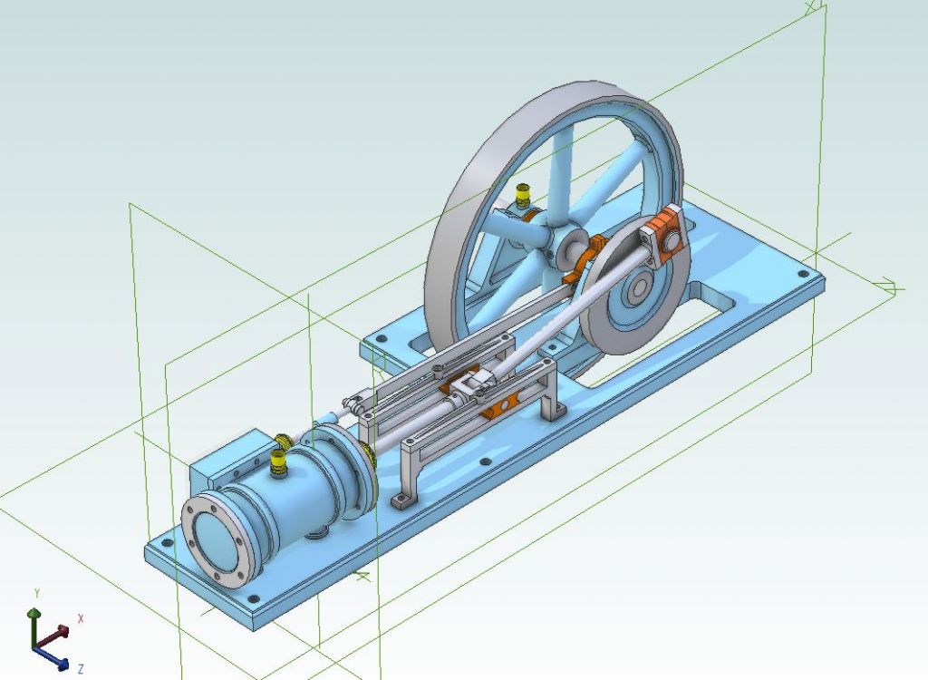

                                    Nigel, it is not Orthographic drawings I don't like it is 2D CAD which I never got on with.
                                    What I am saying is that if you copy a parts and then paste them onto your GA and subsequently alter that part it won't alter on the GA. If you can draw each part as a separate layer and then view all layers together then if any individual layer is changed then only that needs changing as the change will show on the GA as it is built up of layers not copied superceded drawings.

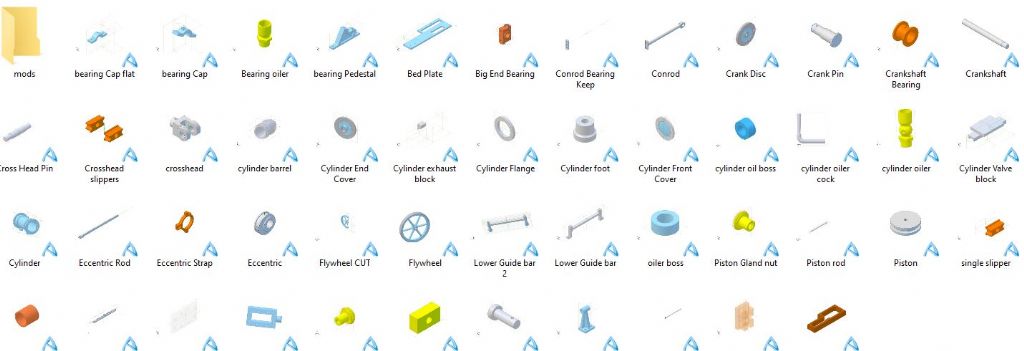

                                    For example in Alibre taking the engine that is being published in ME at the moment I have a Part file for each individual part

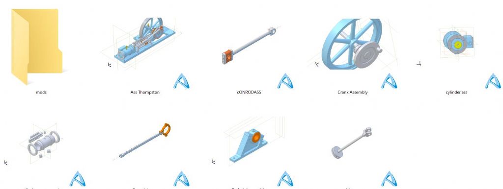

                                    I then have a few sub assemblies and a main assembly.
                                    Looking closer at my main assembly which could be called a General Arrangement (GA) then each part is arranged in it's correct position relative to the others and constrained by things like being on the same axis to another or one surface mating with another. If I were to change any one of those individual components then that change would automatically show on my GA I don't have to go back and delete the old part I copied and paste the revised part.

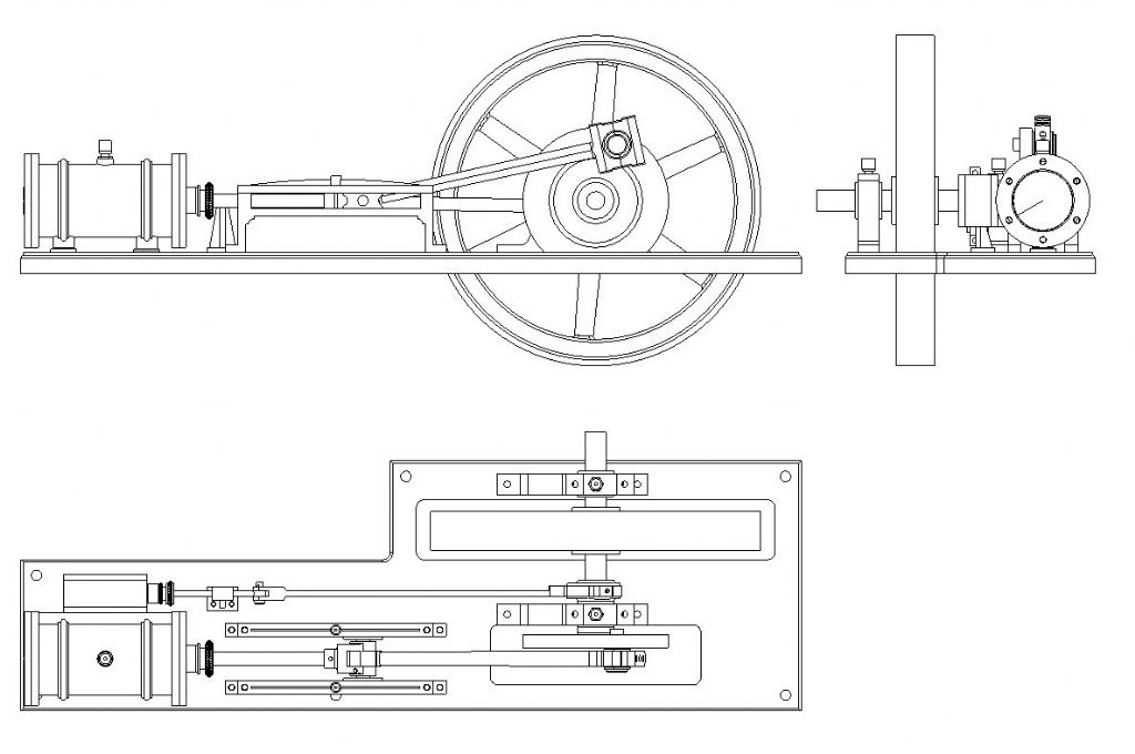

                                    From those parts I produce my working drawings and can have as many elevations as I like.

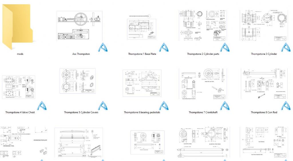

                                    All my working 2D drawings for this engine, again if any single part changed it updates on the drawing sheet and GA sheet.
                                    So as I see it your best bet is each part on a separate layer and then view all layers to get your GA. Maybe other TC users could comment on whether that is how they draw a multi part item.
