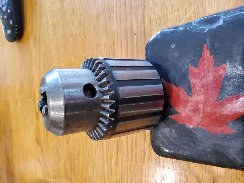

Trying to find a chuck key for this 13mm chuck

      This pilot hole is 8mm but the hole is very close to the teeth.
      Only markings are 1-16mm and B16.

        Mike Poole
          @mikepoole82104
          One thing to check is that the sleeve in in the correct position relative to the key hole, I had a problem with the key not fitting properly which turned out to be the sleeve having moved. It is only located by friction but should be pushed up to a hard stop.

            Off to give it a good bash

              Ok bashed and a key i had now fits however the action feels tight now so a bit of fetting needed. Many thanks

                Posted by petro1head on 25/05/2023 18:44:30:
                Bash it back the opposite way, just less than the first time.
                It should not necessarily be pushed up to a hard stop (i.e to speak of its location in such absolute terms is incorrect). It is better positioned in a way that the chuck key meshes adequately and the action is smooth.

                old mart
                  @oldmart
                  One of the chucks we have at the museum had poorly fitting key, so I knocked out the crossbar and bored the end to take a closer fitting pivot which keeps the bevel gears in mesh much better.

                      Its a bevel gear drive.
                      if it is loose turn away a small part of the narrow end of the gear and possibly the pin, It will engage better.
