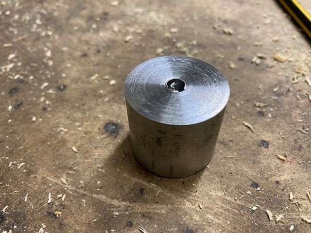

                          This is the kind of finish I’m getting.

                                Jim,
                                That looks pretty typical for what Andrew calls “noideaium grade” material [*]
                                [*] Quote:
                                What grade is the material? Material of noideaium grade are generally not good.
                                #469198

                                      Interesting finish! Is the surface smooth to the touch or is it rough and the surface torn? I have seen this sort of smeary finish before. It could be the material, the insert or speeds and feeds. One thing it isn't likely to be is the lathe. At this stage I'd guess speeds (too low) and feeds combined with a sticky material. What speed and feed were used?

                                        Typical mild steel face cut, don't blame the machine.

                                              Did you use any cutting fluid when machining this sample? A lot of Internet noise says don't use any with carbide but for some materials and low feeds it is better with some lubricant. I have a brush that I use when I just want a smear of cutting oil on a surface, just what is on the bristles without adding more than a few drops to the brush now and again. I also have a hand trigger bottle with "water soluble oil" mixed about 10:1 with water. Spraying this on before cutting avoids thermal shock to hot carbide.

                                                Hi Martin – no I didnt use any coolant on this sample, but I have tried with cutting fluid, and oil.
                                                Perhaps of interest, I did machine the CI back plate and the finish was great. I also did a test on some brass last night and the finish was acceptable.

                                                  I'd slightly disagree with DaveH. I wouldn't be surprised to see a smeary finish on EN3, but not EN1A for instance. It's not clear how big the test piece is. But assuming 1" diameter I'd be running at 800rpm, 4 thou/rev minimum feed and 10 thou or more width/depth of cut depending upon the nose radius of the insert.
                                                  Coolant can have an effect on surface finish dependent upon material. But it really needs to be flood coolant. Dabbing or squirting on now and again is a waste of time. Unfortunately there are a lot of people on the internet who think they are a legend in their own lifetime, and a few that know what they're doing. The problem can be sorting out the wheat from the chaff. smile

                                                    Andrew is quite right.
                                                    Carbide tips basically work by getting the metal at the contact between tip and work hot, so that it softens. Which is why they work best when the swarf comes off brown, blue, oven red hot.
                                                    Intermittent coolant supply might even crack the tip.
                                                    Because the tip is not as sharp as a HSS tool would be, lubricant might even inhibit cutting, so that the tool fails to cut until the feed builds enough pressure/heat to cut, and then once the pressure has reduced, the process returns to smearing. A very fine feed may produce the intermittent cutting effect, where a faster feed would produce the heat to encourage a good cut. Try what Andrew suggests !.
                                                    It is taken as read that the tool is on the centreline of the work.
