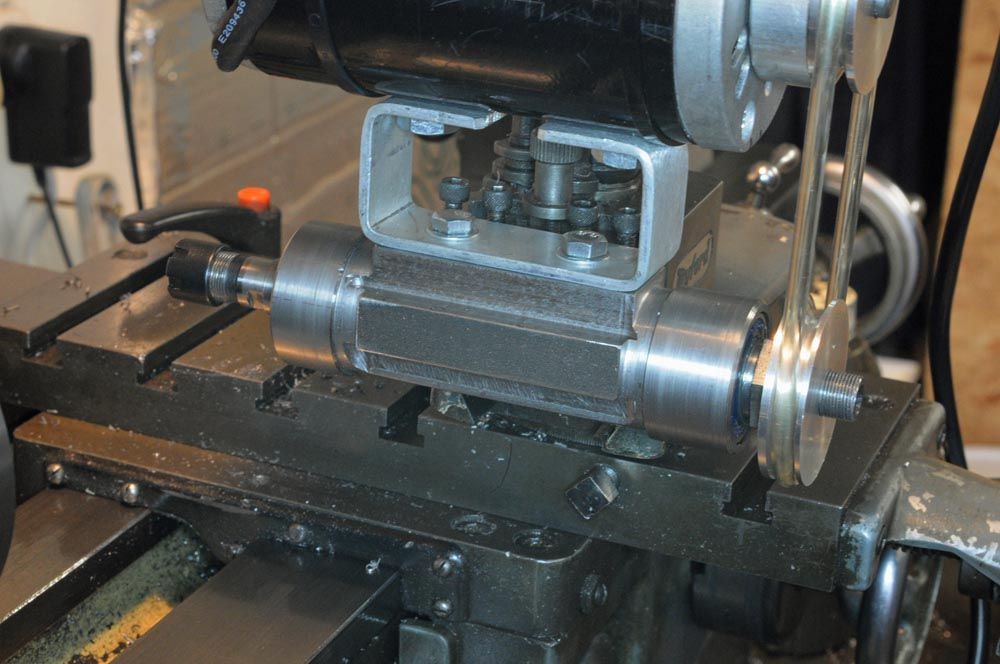

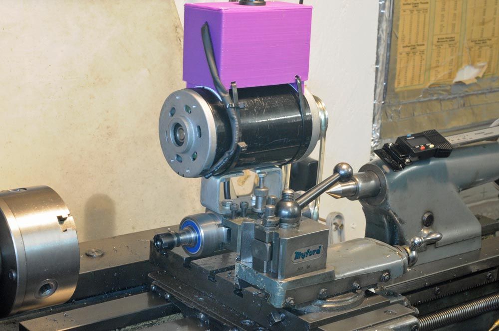

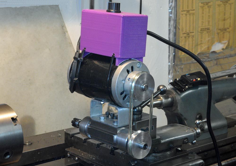

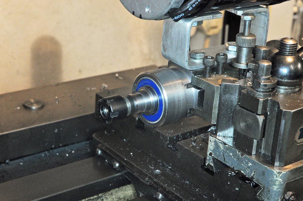

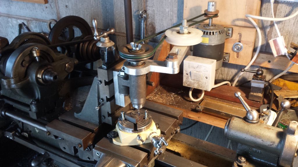

        Being the impatient soul that I am, I have conceived the need for an easily mountable tool that can be used for milling and drilling items held in the lathe headstock. I do this quite a lot with a vertical slide and 95% of the work is done at centre height. This is my attempt at a tool post mounted attachment:
        The spindle is based around a pair of angular contact bearings and an ER11 straight shank spindle, both from ARC. The motor is a 200W 230V treadmill unit with speed control from ebay **LINK**
        I'm waiting for a pulley cover to print at the moment.
        Cheers,
        Rod
        Edit:  I paid £44 for the motor  –  looks like he might be out of stock with speed controllers for the moment.

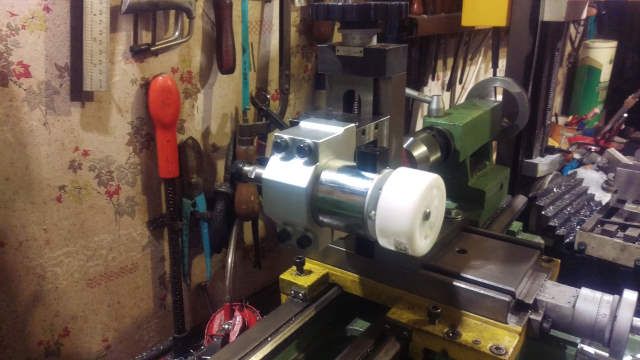

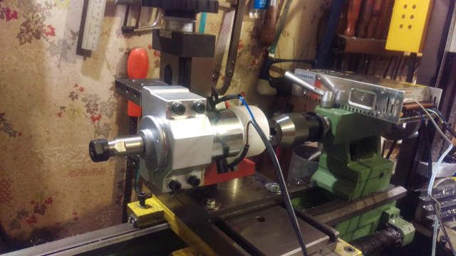

              I couldn't see the point of making a spindle driven by a separate motor, and didn't have any the bits to do so.
              So £90 later, which included a set of ER11 collets and power supply, plus about an hour's worth of work, most of which was adapting the mini-lathe vertical slide to my WM250:
              and
              so it's height adjustable, and both the cross slide and vertical slide can be adjusted for all sorts of compound angles.
              #400702
              Clive Foster
                @clivefoster55965
                Thats a very neat job Nicholas.
                Usual reason for going the separate motor and spindle with belt drive route is to be sure the bearings are able to handle cutting loads. In particular most smaller size motors have bearing arrangements with fairly limited thrust load capability.
                Think I'd look into using external thrust bearing to carry the loads.
                Clive.
                #400706
                Roderick Jenkins
                  @roderickjenkins93242
                  I'd considered a spindle like the one Nicholas used. My concern was that there might be insufficient torque to drive a 6mm drill through steel at 1000 or so rpm which is at the bottom end of the speed range for a 12000rpm spindle. I, too, had doubts about the robustness of the bearings. Hence my clumsy looking but workable solution. Happy to be proven wrong smiley
                  Rod

                    The photos flatter it, it's not the prettiest thing when you see it in the metal. But by tapping 8 holes in something I already had, it gives a lot of adjustments over a large range of movements which should make it usable for the clock wheels I've not started for the last 3 years……
                    I've recently found a chunk of aluminium that would make another bracket for attaching to a QCTP tool holder. That would allow for the quick deployment of it for things like fluting knobs or crossdrilling. It's this sort of job that makes me wish I had bought a wedge type post, as integral Dixon holders are not something I want to make.

                            AdrianR
                              @adrianr18614
                              I was looking through MEW back issues and saw in #52 and #53 there is a description how to build the Quick Step tool post milling attachment. Might give you a hew ideas.

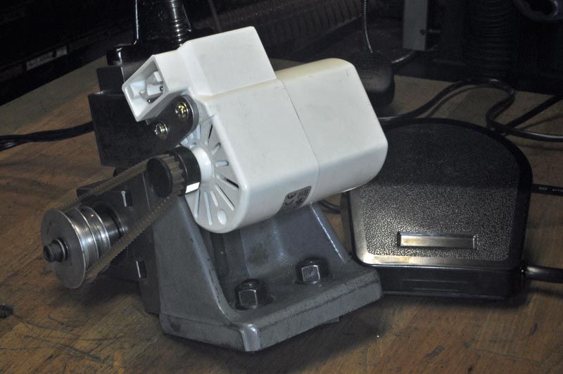

                                  Roderick Jenkins
                                    Guys,
                                    I have successfully used a 120 Watt sewing machine motor with an Arrand spindle. 6mm drills are a bit of a struggle but it will drill 4mm with ease and drives a 6mm endmill OK providing the depth of cut is not too big. I was guided in my choice for the new system by the capacity of the ER11 collet chuck.
                                    I couldn't really comment on use for a woodturning lathe, it depends on so much. For guidance, the top speed of the treadmill motor is 4000rpm so I would probably at least halve that speed with the pulleys for wood turning but, again, it depends…
                                    HTH,
                                    Rod
