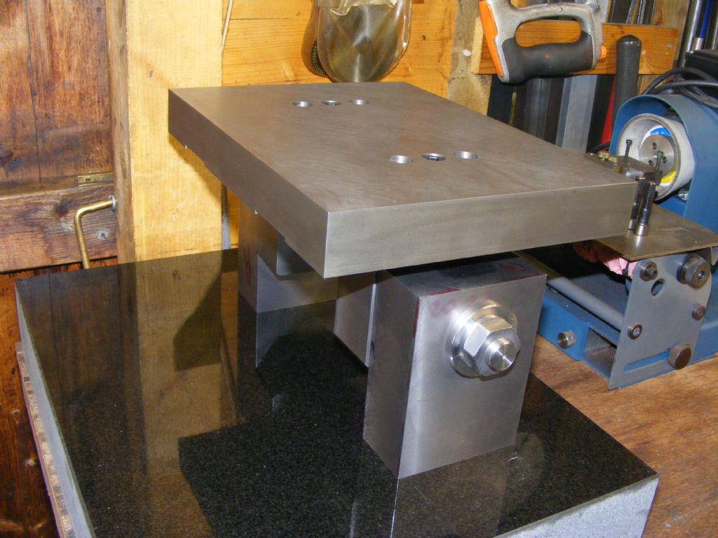

      Hi All,
      Have got about half way through making my new tilting table.It has 190
      degrees of tilt *95 /-95 It is mostly from Meehanite, apart from the 2 shafts and their flanged nuts [1 right hand thread and 1 left hand thread] they are from EN24T . But I seem to have boobed with the weight I reckoned about 40 kg's when finished but it is now at a shade under 51kg's and still has the base to go so will probably be nearer 60kg's but it is very very rigid and stable so that is 1 plus from the boob. As it is just now when horizontal on the granite surface plate there is 0.004mm from end to end so I am happy with the accuracy it's just the weight is a pest [being a bricklayer I am used to lifting Granite a lot heavier than the table] but putting the thing on the milling machine in a controlled manner is not easy. I have put a photo in my album for anyone interested.

              It obviously stays attached to a mill by its own weight?

                KWIL,
                Unfortunately it won,t stay with it's own weight, the base still has to be completed.
                as has the Tslots, or a threaded tooling plate [ argh, even more weight]
                Raymond.

                          Raymond, is the table hollowed out underneath? That would lose a bit of weight, you could also put resesses in each leg, and at the bottom of the legs have a slot for a mounting stud, just an idea to lose a bit of surplus. Ian S C

                            Ian, No, the table is not hollowed out . I see where you are coming from, re saving some weight. But it will be managable at approx 60kgs, and I like everything solid and rigid and it's certainly both. The construction side of the table should be finished tomorrow [ the base], and then only the T slots [or tapped tooling plate] will remain to be done, then it's done and dusted.

                                Hi Raymond ,
                                Just a couple of thoughts :
                                (1) Cutting T slots in top of table will very likely cause some distortion – it could be anything from minimal to severe – there is no way of telling .
                                (2) Give some consideration as to whether T slots will be along axis of table or across – both alignments have merits and demerits – depends on what you want to use it for really .
                                (3) Tilting tables of this general layout have the problem that they are top heavy and when locking mechanism is released they fall over . You may wish to consider reducing this problem by using any of :
                                Friction washers , a control mechanism (like a jack strut or worm and wheel ), or just a fail safe in form of a selection of wooden blocks to put loose under table .

                                  Michael, good call about the t-slots, I have the table scraped flat and true so I would not want the slightest distortion . I have decided to install a threaded tooling plate, they are also made to very fine limits of flatness. Yes I will certainly need a fail safe as it would certainly do the fingers a bit of damage. [in fact if I were to loosen it from the horizontal and it decided to tilt on to the fingers then I would most probably be looking at broken fingers at the very least ] again.
                                  Regards,
                                  Raymond.
                                  Ps, The worm wheel sounds a nice idea, I will try to design one to suit the almost finished table. or else it's the easy way out [blocks of wood].

                                  MICHAEL WILLIAMS
                                    @michaelwilliams41215
                                    Worm and sector of a worm wheel actually – you don't need a full circle worm wheel . Much easier to fit in just over half a wheel into your design than a complete one and resulting design could be both rugged and compact .
