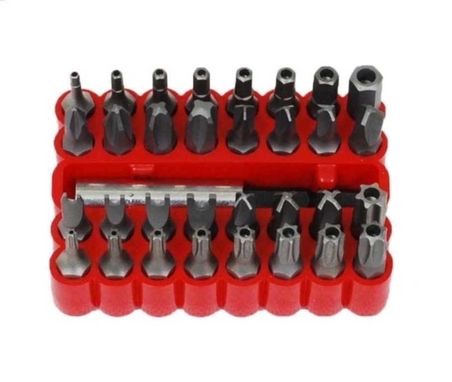

                          davidsuffolk
                            @davidsuffolk
                            This set is available from eBay at £4.29 posted so hardly worth trying to make /alter something else. I have similar and very often comes in useful, especially the TORX drivers

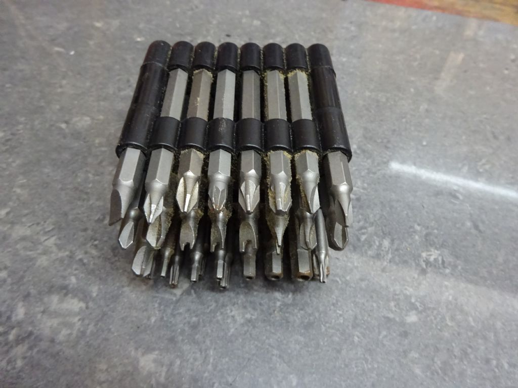

                                #217345
                                  Brian, you can get longer sets, mine are 100mm long

                                                Who supplies this longer security bit sets? I have a regular occasional job that would be much easier with a longer set instead of the "creative" way I extend my short ones.
                                                Clive.
