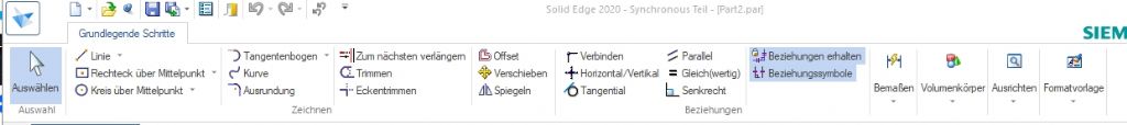

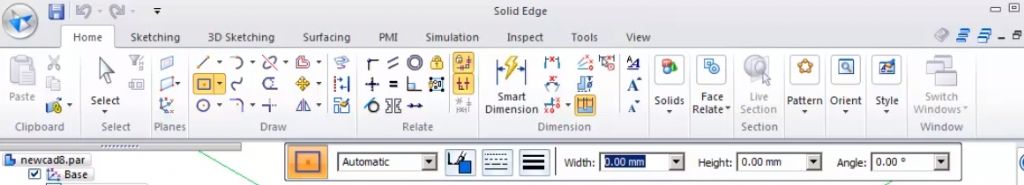

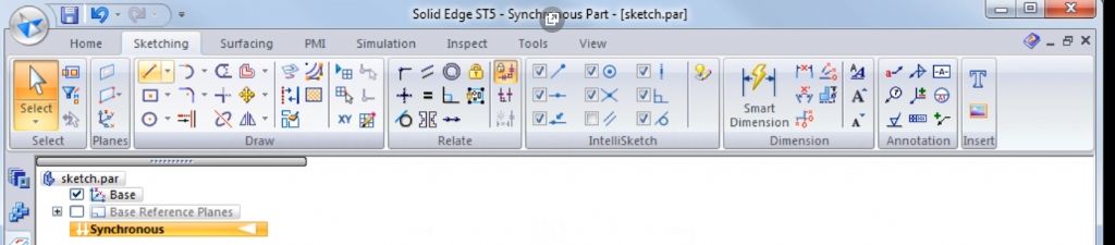

          After I downloaded Solid Edge, nothing worked, as I had written before, but in this I was not alone. After a couple of days this problem was solved, and I started checking the tutorial videos. First disappointment was, that I found nothing about how to set up the program, as it has gazillions of 'levels' as it seems. It is very difficult to find a line in these videos. I had also a look into waht is available on Youtube, and there is some interesting stuff. But it is not easy to follow which actions someone executes on a video.
          And this leads me also to the first problem. Almost in every video I see the Toolbar looks different, and these toolbars look Very different from that on my screen. To clarify, what I call Toolbar is the array on top of the screen, where the drawing tools are arranged.
          Tutorial 1:videotutorial.jpg
          Tutorial 2:anothertutorial.jpg
          My Toolbar:mytools.jpg
          And the clean Onshape-Toolbar:onshape_toolbar.jpg
          So, what's the matter here?

          #471835
          Steviegtr
            @steviegtr
            No nothing of that program but in autocad those top graphics change as you click on the different functions on the top line. Tutorial 2 is showing the sketching icon lit up, so I guess that is the menu for sketching.
            Steve.
            #471837
            Steviegtr
              @steviegtr
              On your top tutorial 1 it has home clicked & so on. Same as autocad.
              Steve.
              #471848
              Raymond Anderson
                @raymondanderson34407
                Hans, Yes the customise options are very extensive far too much for me to write up here. If you go to the areas marked on my screenshot you will find all the help you need there. You can customise the GUI to suit your workflow.
                Not sure what the GUI is by default in the Community edition [ is that the default shown in your pic ? ] either way you will be able to get it to suit your way of working.
                Solid Edge is far , far removed from any of the programmes you have mentioned. It is a full blown commercial Mcad programme extremely powerful, Robust, Stable and flexible. [ don't let the extremely powerful bit put you off ] The User forum that I mentioned in another thread is a gold mine of info from Pro users of the software. also Siemens Solid Edge official forum is another first class site. Also, if you press the area at the top where the arrow is pointing that will take you directly to the GUI customise options Hover over it and press F1 will take you to a extensive help area.silid edge help areas..jpg

                  #471883
                  IanT
                    @iant
                    Hans,
                    I'm busy trying to learn SE too – so absolutely another Newbie too. But about the different toolbars….
                    When I installed SE it asked me what level of experience I had (I forget the exact terms) but it was something like 'New to CAD', 'Used some CAD before' or 'Experienced CAD User' – I was probably 'used some before' (Intermediate level?) but decided to jump right into 'Experienced'. I'm pretty sure though that the UI wold have been simplified if I'd have chosen one of the other options.
                    The Toolbars do change interactively as you select a tab (e.g. Home, Sketching, 3D Sketching, Surfacing etc) but 'Home' seems to be a kind of summary toolbar – the others are more complete but also more complex (and maybe harder to use at first). Always look to the 'Hint/Guidance' at the bottom of page that will tell you your next move -it's very helpful. Hover over an icon and a help box will also appear…
                    I've been watching some excellent YouTubes by Design Fusion (a Canadian SE Partner I think) which are very good but up to 8 years old – so I've assumed that there will be some differences in the product version – although the basics of the UI seem the same. The Siemens videos will be more up to date I assume but the ones I watched had some sort of robotic female voiceover that I guess they use to automate translations (??).
                    I prefer the DF guy – he's very good but he packs a lot into each video. I try to play them through once (just watching) then a second time (to take notes) – then go and actually try the stuff – then watch again and try to understand what I just did wrong!
                    Hope this helps – keep at it!
