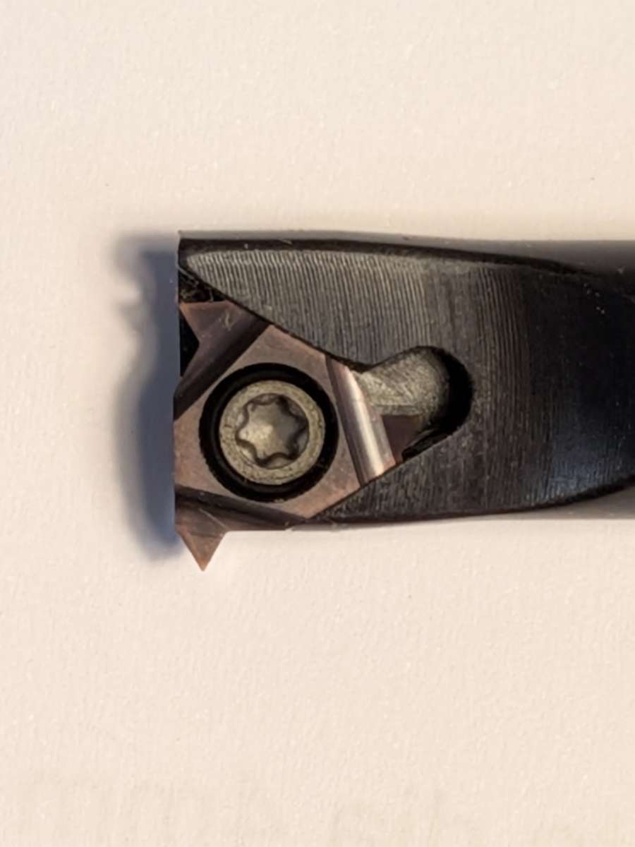

            There was a member here posting as richardandtracey who made pens and developed a thread milling gcode generator.  Maybe he will see your post and respond. From what I recall worked extremely well, not sure if it did external as well as internal threads. I used an internal threading tool with 10mm shank, insert tip. Mounted in a mill collet, to make an m14x1 thread for a Unimat and it gave an excellent fit with no fettling first time. Following my request he added a feature to allow outside-in threading which allows you to make thread mills from taps of the appropriate size, for example I sacrificed an M8x1 tap by grinding off 2 sets of teeth and successfully used that as well.
            #833147
              John, did you use a full or partial form insert when you did the M14x1?
              The other thing that can affect the fit of the thread is the rigidity of the cutter, one on a 10mm shank is not going to flex much but one on a 4mm shank is likely to deflect more so number of cutting and finish passes will come into play

                    #833170
                    John Haine
                      @johnhaine32865
                      Jason, this one I think

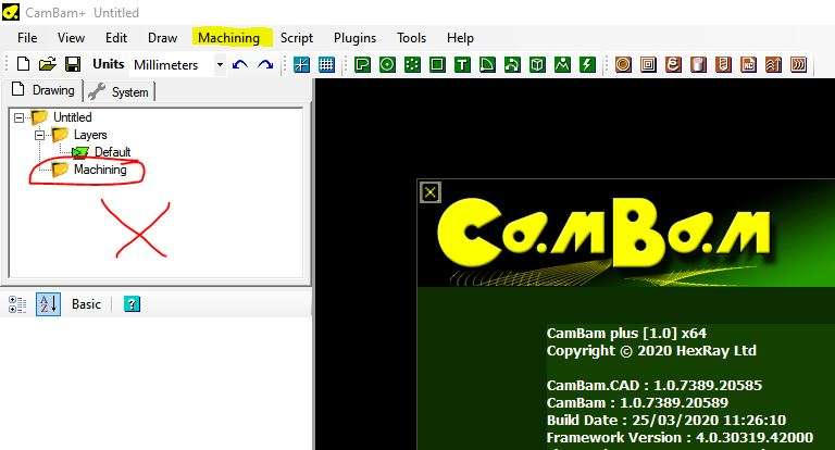

                                    #833480
                                    blowlamp
                                      @blowlamp
                                      On John Haine Said:
                                      On blowlamp Said:
                                      Ok we’ll try again with CamBam…
                                      Go to the 4th post down and download the 64bit version.
                                      It should now work – well it does for me. 😉
                                      Please note that an icon doesn’t appear on the toolbar, it only appears under the Machining menu.
                                      Martin.
                                      Please could you explain how? I have downloaded the dll and put it in the plugin folder but no sign of it.
                                      John.
                                      I have the 64bit version of CamBam installed on my laptop and I don’t think it came with the Thread Milling plugin.
                                      I found the last link I posted here on the CamBam forum after finding the original one I linked to didn’t work for me.
                                      With the CamBam app closed on my laptop I installed the 64bit plugin into the plugin folder and then started CamBam.
                                      No Thread Milling icon was displayed alongside the Profile, Pocket and Engrave etc icons. You can only find it in the Machining menu, which I’ve highlighted in yellow, but not in the left window pane.
                                      Martin.

                                      #833483
                                      Les Riley
                                        @lesriley75593
                                        I tried all ways until I installed the 64 bit version and then everything was OK. Only visible in the machining menu though as Martin said.
                                        #833502
                                        John Haine
                                          @johnhaine32865
                                          Right I just re-installed, this time the 64-bit version.  Thread milling can be selected from the top machining tab but not from the “machining” folder! Anyway it’s there.  Thanks for the help.
