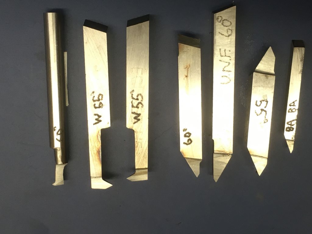

            Grind a single-point HSS tool as closely as you can to the 60º notch in the setting-gauge; better to be very slightly under than over-angle. Cut to just shy of full depth – take a "spring-cut" at intervals to avoid an increasing extra chip-load especially if plunge rather than angled feeding-in; and one or two spring-cuts on the last increment.

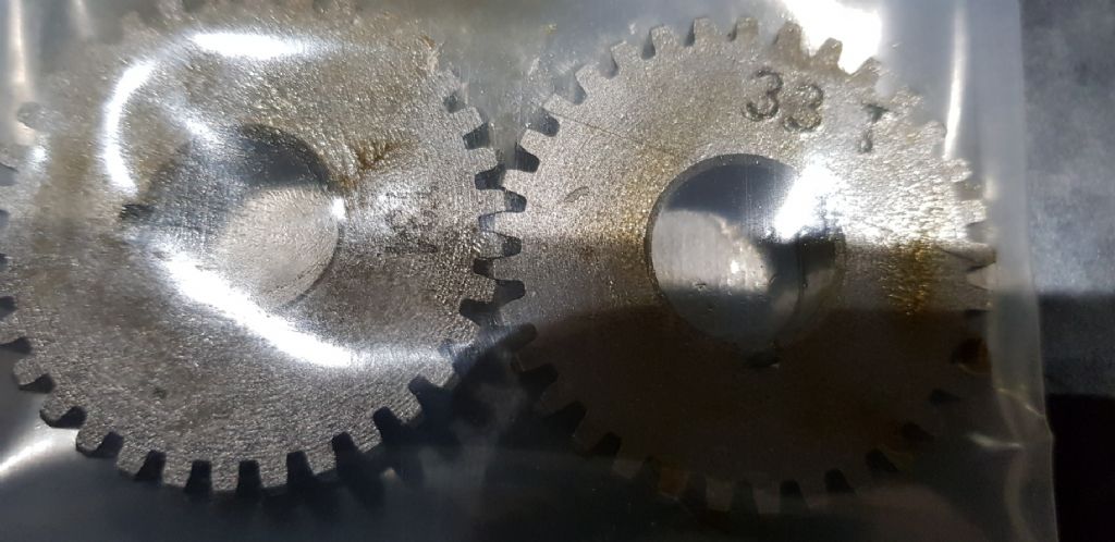

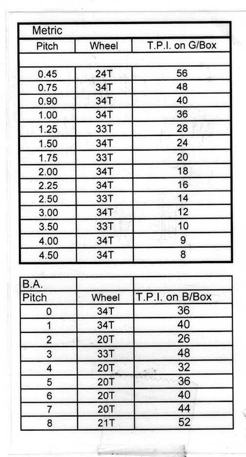

                    You do not need a metric conversion set to cut decent metric threads on an imperial Myford, using a 33/34 gear you can get good approximations, I can't remember the exact details but there are forum posts about it?

                      I'm really pleased you pointed me at the 33/34 tooth gear option. The parts for a metric conversion kit was looking at costing me £250+. A couple of gears will cost me £20 from RDG,
                      The loss in accuracy in the thread pitch is minimal.
                      This is the table I found from another forum post
                      https://www.model-engineer.co.uk/wp-content/uploads/sites/4/documents/gear%20errata%20tables.pdf

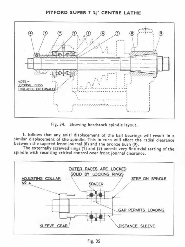

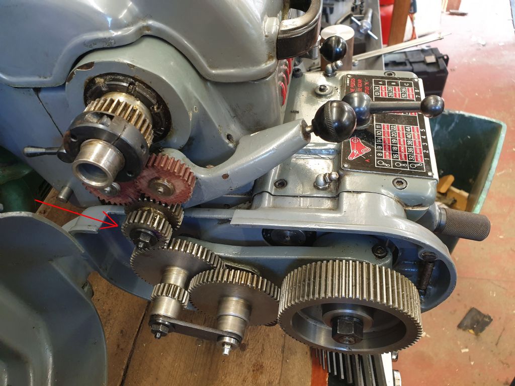

                      So just to double check, this chart talks about the mandrel gear. On my standard setup I believe this is the one arrowed which has 24 teeth.
                      I so pleased to be able to "almost" make do with my current setup.

                        Mandrel = Spindle.
                        Your arrowed gear is after the tumbler gears.

                          A lot of mini lathe users use a 63T gear. It is not exact, (you need a 127T for that, but a 20 DP gear is quite big. They are available. )

                            NDIY is correct in that 'Mandrel = Spindle.' i.e. the gear behind the black locking collar top LH, but you are correct in saying the 33/34 gear replaces your arrowed one.

                              … because Myford treats the one physically on the spindle as being non-removable except when servicing the lathe.

                                That may well be so, but your pedantry is not at all helpful to the originator of the question.
                                Can any of the gears above the one he has highlighted be changed for alternative sizes?
                                If not, then the term is apt as the mandrel gear is conventionally the first (variable) gear in the chain.

                                    Okay I've completely misunderstood the content of this table then. I thought all I needed to do was change the gear arrowed with 33 or 34 teeth. I got over excited by the simplicity and low cost of what I thought was my solution!
                                    Interestingly I can see that the gear I have arrowed turns 1:1 with the lathe spindle which is why I'd thought this was the one to change.
                                    I've looked at what is involved with changing he gear on the spindle and that isn't so easy.
                                    I'm going to back to basics and work out the gearbox ratios and see what is possible. Suddenly the metric conversion kit is feeling like a simpler solution, but let me work it out. I really want to properly understand how this table was created and how I can use the results it shows.

                                          Indeed you do need those gears which I bought some time ago. I also had no idea which ones to change. The nearest answer I got was something about making a new quadrant device. Which I took to be the plate at the rear of the lower gears. With that they went in the cupboard for another time. Still there. I also had a chart somewhere if you do not have it. It lists all the metric threads that can be done. There are some that can't.
                                          Steve.

                                              Mark, I was taught this method as an apprentice in the early 1960's having been asked many time how to I typed this up same years back. You may fined it useful : —
                                              Screwcutting Metric / Imperial August 2010 This was passed to me by my apprenticeship mentor in the early 1960’s When screw cutting a metic thread on an imperial lathe you can use the chaser dial and disconnect the half nuts when cutting up to a shoulder by doing the following : –
                                              First make sure you engage the half nuts with the chasing dial on a particular number — number 1 is best
                                              Then make your first cut and at the end of the cut disengage the half nuts and stop the lathe asap now retract your tool exactly as you would if it was an imperial thread — DO NOT move the carriage — this is very important.
                                              Now the thread dial will have passed number 1 so start the lathe in reverse and re-engage the half nuts on number 1 and run it back to the start point of the thread.
                                              No need to disengage here just stop the lathe, apply the second cut and start the lathe forward then repeat the above at the end of the cut.
                                              This allows you to thread up to a shoulder or undercut without fear of a disaster !
                                              Link to an excellent video demonstrating this method from the ME forum March 2019
                                              Some of my free hand ground threading tools
