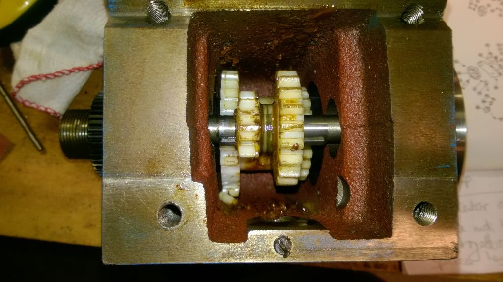

      Now I need to post with a lathe problem which appears to be stripped gears.
      Basically I had a big but of steel rod (90mm diameter and about 120 long) mounted in the chuck rotating at moderate speed and got a bit too quick with the cross slide.
      As with the first post, the metal came from a scrapyard and for all I know it's mega hard. NO more scrapyarding for me!
      The low gear appears stripped – high gear engages and works, low gear doesn't spin the spindle or catches occasionally.

              Best to fit the steel gear to the spindle and leave the plastic ones on the layshaft.
              Reason being the plastic ones are a 'fuse' and the layshaft gear is easy to replace compared to the spindle.

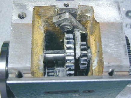

                  There are 2 x plastic gears within the headstock. Strip and removal is straight forward and its a very simple set up:

                          I have also had the same issue. Not hard to do but does require removing the Headstock.
                          Neil has the right idea for removing the Lathe Spindle. A Bolt Press.
                          Any kind of knocking tool is not required and should not be used for the spindle.
                          You may also need to remove the Counter shaft that the other gear slides on. That shaft is Keyed and can be gently tapped out once the circlip is removed from the chuck side. The Rear bearing will come out with the shaft.​
                          Assembly is a simple reverse process.

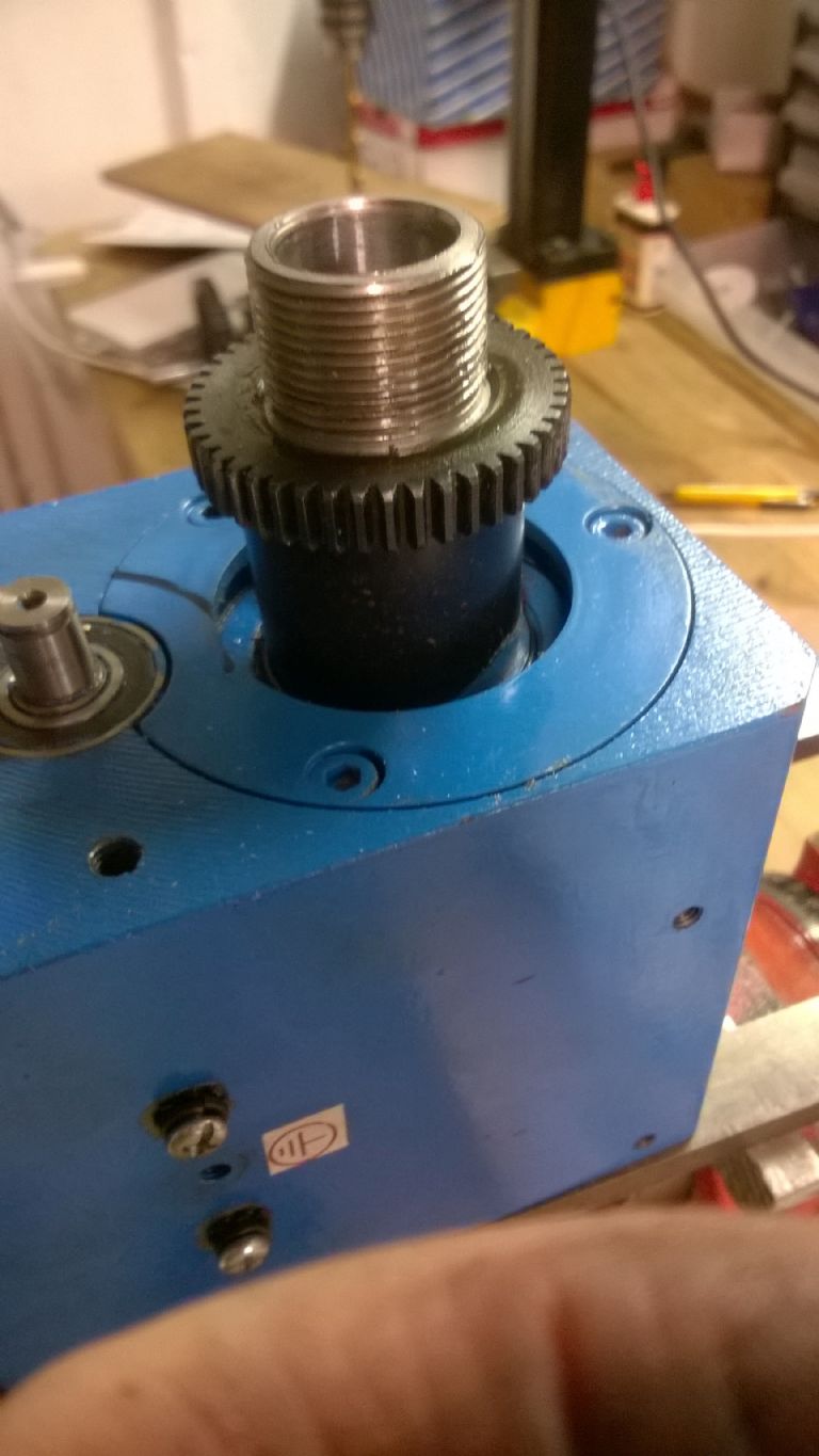

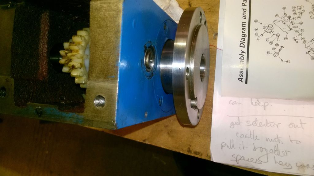

                              Today (end of work), I started to strip it down. I've got the headstock off and paused. Of course SPG is now on holiday until next year. Since I am as well, I can't really complain….
                              However (there had to be a however…), I find my notes after this point reasonably unintelligible.
                              I think I've got to the point where Simon said to drift the spindle out with a hammer (or, of course the clever fuller Neil proposes). MY tentative taps with a small hammer (with a piece of wood in the way) have moved nothing. I can't shift the layshaft either,
                              As a beginner, I'm a bit scared of braying the damn theadstock03.jpghing so hard it breaks, so I thought I would seek some advice.
                              Here are some pictures
                              I think this is as stripped down as it gets. I don't think I need to remove the bearing covers – the bearings can stay in place when the spindle comes out.
                              I suspect that the next phase just involves brute force (applied by hammer or by a press), but I would appreciate advice before I break if further…

                                Leave the hammer in the rack. Do as much online research as possible but use sound judgement. Be aware that some of the videos online can and do represent brutally unacceptable techniques. Pressing out spindles, bearings etc is primarily a generic activity. With a bit of thought and planning, you can make up you own tooling with items at hand such as threaded rod, washers etc.

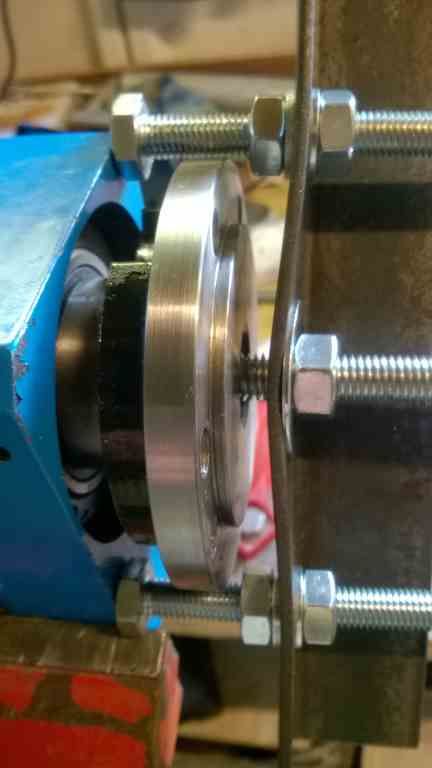

                                  Yes, you need to remove the bearing covers, at least at the front because the bearing is more likely to stay on the spindle than in the headstock. Look closely at my photo and you can see I've removed the screws from the bearing cover.
                                  The puller only needs a bit of angle iron or a rather thicker bar, a few M10 screws and nut and length of cheap studding from Wickes or B&Q.
                                  <edit> M8 will do if you're a cheapskate

                                      All I had at the time was M6 threaded rod, so NOT being a cheapskate (despite being a Yorkshireman), I splashed out on some M12 rod.
                                      Sadly, the bearings/spindle were just too tight (my angle iron was bending and I 'd reached the end of my strength), so I resorted to the engineers friend and that got it out OK.

                                        By all mean's try harder to get Neil's puller to work. Whilst braying the end of the spindle did eventually get it out, it also damaged the threads, requiring me to mill a bit off the end before the collet nuts would go back on. Simon (SPG Tools) indicated that I should have left a nut on to rebuild the thread after the braying. I think that avoidance would have been the better option.
                                        I did use a puller to get the spindle back on. The mechanics worked better, but I was lucky enough to have a piece of pipe from a typists chair which more or less fitted over the thread end spindle. It would have been better with a nice 60mm washer with a 25mm internal diameter. So clearly, one rule is that you should lathe up some parts to make it easier to fix your lathe before you break it!
