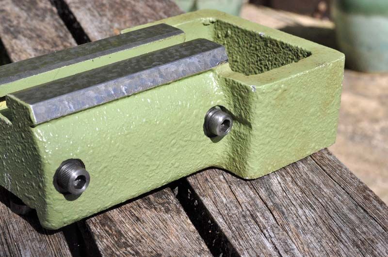

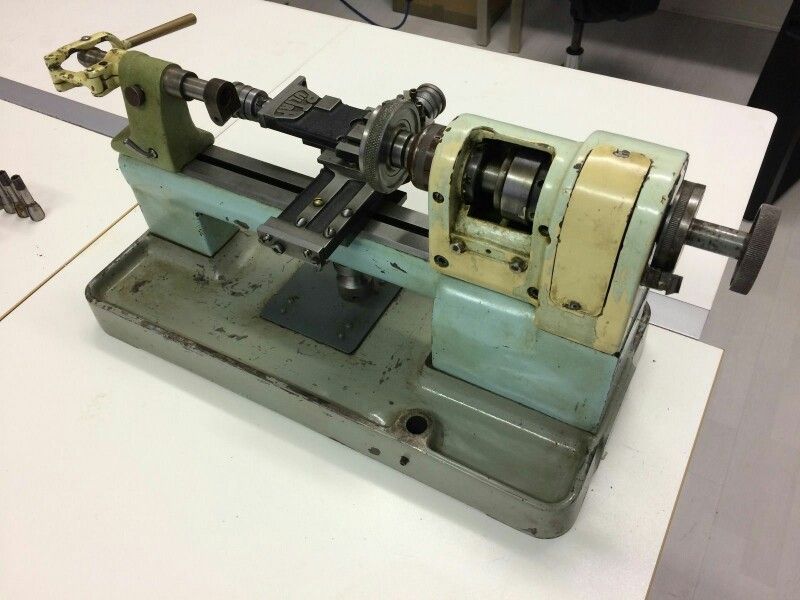

      Hi Folks,
      I was fortunate to be able to acquire a Pultra 1770 lathe yesterday. It,s something of a "bitsa". The bed is smooth duck egg blue, the headstock was originally cream but has been overcoated with something that approximates to the bed colour. However, the tailstock and the headstock and tailstock raisers that came with the lathe are in this green textured paint:
      I think this is the last livery that Pultras came in but can anybody please identify this type of finish – it's obviously not crackle or wrinkle so what is it called and, if I decided to redo the whole lathe in this finish, where would I buy it?
      TIA,
      Rod

          What you have is a course spatter finish. Not a special paint, just technique. It is a combination of larger spray jet,viscosityand distance of gun from item.Usua;;y about twice nomal distance. For a course finish such as this it is usual to put a flat coat first and when that is tacky apply the spatter.Usually best with non glossy paint. Egg shell is about right.
          Any reasonably quick dry paint works fine. It was a very popular industrial finish in the 80sand 90s Might still be but I have lost touch.

            Keith,
            That makes sense, thank you. Too complicated for me, I'm more of a brush man. Looks like back to the Pultra cream. Myford Rich Cream from Paragon Paints looks pretty close, judging by the colour of the inside of the bed on my S7. I'd only change from green to cream for the tailstock – I can't imagine what I'd ever use the riser blocks for, it's already 70 mm centre height.
            Cheers,

                  The green paint looks original and the risers look pretty much un-used, as does the tailstock body. The cross slide assembly, with the PulTrA logo has a fine black wrinkle finish. The whole of the tailstock lever assembly seems to be made from bronze castings to which the cream paint has not adhered very well.
                  Cheers,
                  Rod

                                  Hi Rod, To get back to your original question, and as you say you are a"brush man", another way of achieving a similar result is to dip the tips of the bristles of a scrubbing/nail brush into the paint and sharply stroke a thin piece of metal across the bristles.
                                  I suggest you practice on a piece of hardboard first. You might make a "Pollock" of it!
                                  Keith

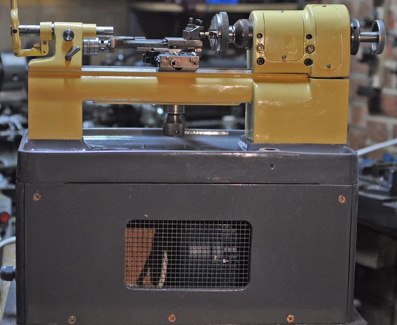

                                            After some mutually beneficial swaps with Andrew my 1770 is now a 1750 but, with the rising blocks, the potential to be a 1790. It needed a bit of work on the paint: Silver Hammerite daubed on with a masonry brush.
                                            Looks better now
                                            Drive is from a 1/3 hp 2 pole 3 phase motor driven directly to the headstock pulley to give a max speed of 3000rpm through a nice little compact inverter by WEG. Impressed by the WEG device – cheap, made in Brazil and came with very good real English instructions. The motor is made in Portugal – both from Inverter Drive Supermarket. (in real life the colour is more like the lowest photo)
                                            Rod
