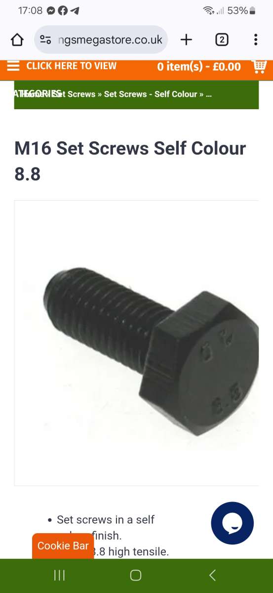

      Eight, here goes, my very 1st question. I’ve latched onto a really nice guy who I bombard with questions on a daily basis, he’s been really helpful but I feel guilty keep asking him silly, basic questions. He deserves a rest lol.
      I’m going to be making myself a little set of ‘lathe levelling screws’ and just wondered if I should get a low or high tensile strength screw? Which is easiest to machine and drill please?
      Thank you
      #794897
      Julie Ann
        @julieann
        I used low tensile commercial screws and nuts, unmodified, to set up my ex-industrial 750kg lathe. No point in making life over-complicated.
        High tensile materials tend to be more finicky in terms of getting a good finish.
        Julie

          I was thinking these?

                    I’m not sure what the weight of the lathe has to do with it? The jacking screws are likely to be in compression so no tensile loads. So whatever is available and within budget.
                    If you are going to have the heads downwards then skim off the raise numbers so they turn a bit easier if making fine adjustments.
                    8.8 is not too bad to machine. I can’t remember the details of why I took this video but probably some saying they cant be turned. Caption should say CCGT 020208 which with a good feed rate gave a finish that is certainly upto standing on a concrete floor. No coolant or flying chips.

                                    As Jason says, levelling bolts will be in compression, so tensile strength is of little or no consequence.
                                    Probably cast iron, being strong in compression, would suffice, and be easy to machine.
                                    To need even low strength M16 fasteners implies a VERY heavy lathe,  a VERY large industrial machine.
                                    Being a 2 mm pitch, the adjustment would be coarse. A quarter turn would change level by 0.5 mm
                                    Which is an enormous amount when trying to take twist out a lathe bed.
                                    That will be difficult to level precisely, since the slightest rotation, or even tightening a locknut will produce a marked change of level.
                                    Many hobby lathe are levelled using one 5/16 BSF bolt at a time, so if the bolts MUST be Metric, M8 would more than suffice.
                                    A quarter turn would change the level of that corner of the lathe by 0.3125 mm, and you will be looking for much less than a tenth of a turn for precise levelling.

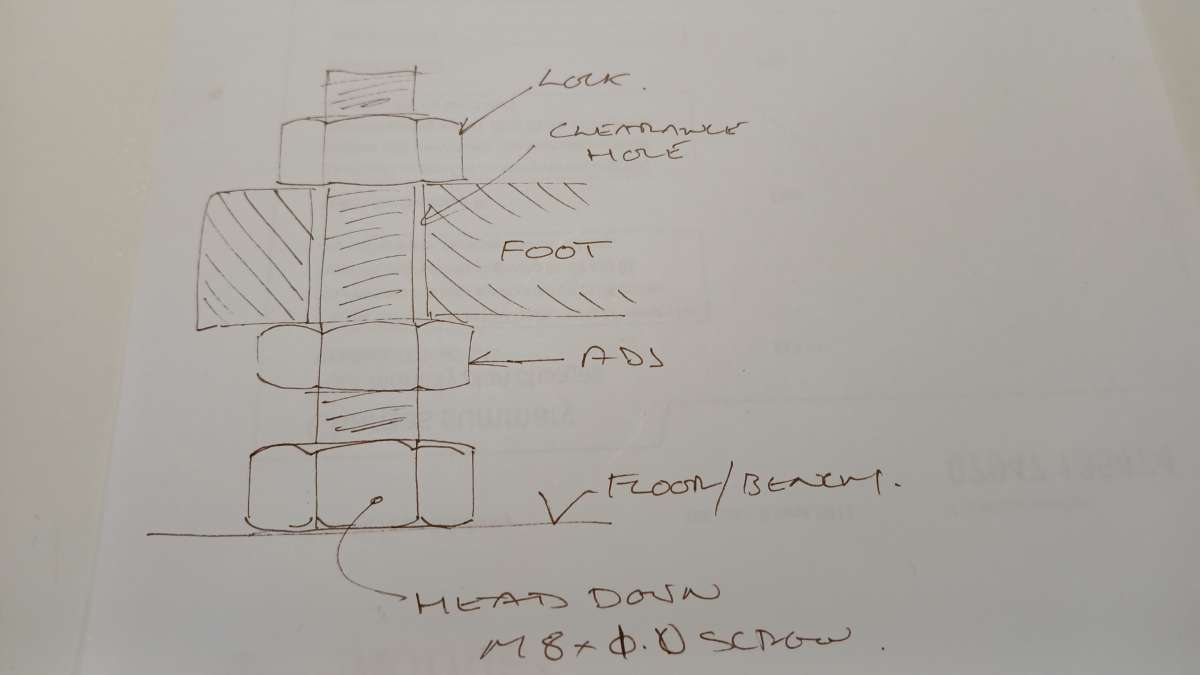

                                          M8x1 that I suggested is actually finer than 5/16″ BSF – 25.4tpi vs 22tpi
                                          Yes it would work though personally I’d go with a hex head screw fitted head down and then a nut above and below the hole in the lathe
                                                    Hi Jason,
                                                    Please excuse my ignorance, but what do you mean ‘fitted head down’?
                                                    I can understand fitted head up, with a clearance hole through it so a stud can pass through and a nut beneath the head for adjustment.

                                                      Like this. The head against the floor/bench will act as a bit of a foot. Nut under the machine to adjust and nut above to lock
