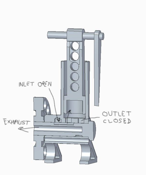

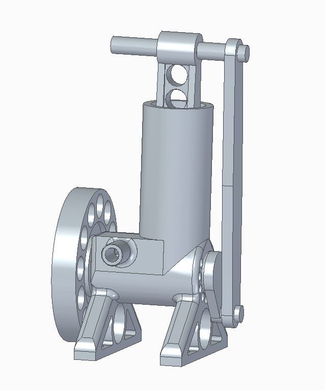

              Thanks to the forum I had an urgent rethink this morning and designed a second, simpler engine. Despite many lessons learned, the Mark 1 engine has a lot of moving parts, hence friction, and will take about 24 hours to print, with no guarantee of success.
              The second engine doesn't solve everything, but the rotary valve is incorporated in the main shaft and there's only one crank. Fewer joints to leak, only one fixing (holding the flywheel on), timing easier to set up, less plastic filament, and it will 'only' take 9 hours to print. Most important, I think it has a reasonable chance of running.
              Air enters at the side and is fed to the cylinder via a slot cut in the rotary valve. It pushes the piston up to TDC at which point a groove cut part way round the rotary valve allows air to escape through a hole in the centre of the shaft, exiting at the flywheel. Section shows the slot connecting air to the cylinder while the outlet slot is closed.
              Thinking about valve timings revealed another huge gap in in my engineering understanding, so I guessed! The exhaust gap is set to nearly 180 degrees, which is probably fair enough, but the input is open for 38 degrees. That seems like a lot, probably allowing more energy in than is needed to spin the engine. Might blow the piston clean out of the cylinder in which case I shall claim to invented an air-gun…
              Anyone know what valve timings are suitable for an air engine of this type? I guess they depend on the required power output, which is unquantified, the friction to be overcome, which is unknown, and the amount of energy in compressed air at operating pressure.
              Watch this space, I'm about to start printing. We could run a lottery on the results:
              • After mild fettling, engine runs first time
              • After lots of fettling, engine breaks at the first puff
              • Engine can't run because of basic design errors
              • Engine can't turn because the piston stanchion and con-rod bend rather spin the crank
              • Engine quickly seizes due to plastic on plastic galling
              Only two cheats intended: although all parts will be 3D printed in PLA, the outer ring of flywheel holes will be loaded with plasticine and PTFE lube will be sprayed inside.
              #602939
                If you look at a simples single acting wobbler the inlet is open for 170-180deg and similar for the exhaust . Remember when running on air you will not get expansion like you do with steam so even more need to keep things open for longer.
                A double acting steam engine with no lap will also be close to 180/180.
                I think poking some ball bearings into the flywheel holes would be more effective and look better too,
                #602941
                duncan webster 1
                  @duncanwebster1
                  Without a crosshead guide the con rod will impose a side load on the extended piston and might stop it running at all. Even with a crosshead, the con rod is well of to one side. I liked the previous one better, and you could incorporate the crankshaft valve easily.
                  #602945
                    Posted by JasonB on 24/06/2022 15:50:50:
                    By popular demand, ball-bearings it is! (Luckily I have some the right size.)
                    The valve news is distressing because the printer is running and changing the model would have been easy! However, I expect my milling machine will be able to open it up. (Worry beads out: PLA might splinter -it's brittle, the core is a sponge, and I've never tried to machine it.)
                    Duncan's comment are valid too, though I did think of it. In theory (which means I guessed), the length of the piston flanks will compensate for not having a cross-head. The flanks can be increased if need be, but it's more friction. The idea of the T piston top is to hang a balancing weight on it if need be.
                    Like simple wobbler's I think the design is a dead-end in terms of scaling up. Blasting exhaust out of the centre of a spinning flywheel would be anti-social, while the towering heavy piston stanchion and bendy con-rod can't be good.

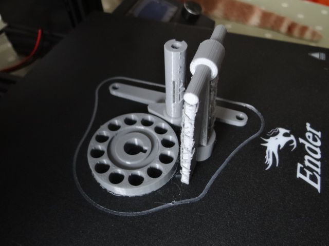

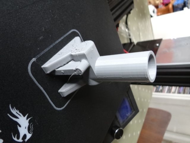

                    Print progress: cause for concern. I'm printing 4 parts together and it looks as if one of them has no overhang support. Don't think I told Cura to support overhangs…
                    sad

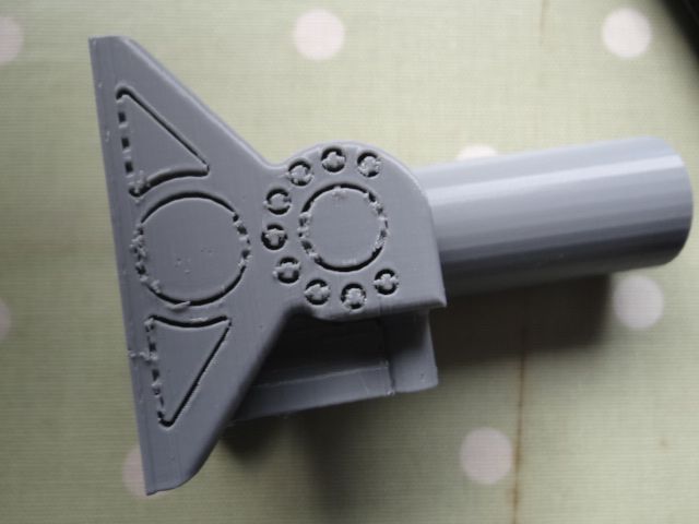

                    #603023
                      Yesterday's progress was 4 out of 5 parts printed, which I hope to clean up before attending a compulsory family do. As can be seen lots of support plastic to be removed. Usually comes off without fuss, but there are always small imperfections to be smoothed out.
                      Unfortunately won't be able to print the last part today because I prefer not to leave the printer running completely unattended.
                      #603143

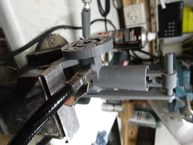

                        Last part to be printed, the cylinder block:
                        As can be seen, lots of support plastic to be removed before cleaning up and fitting.

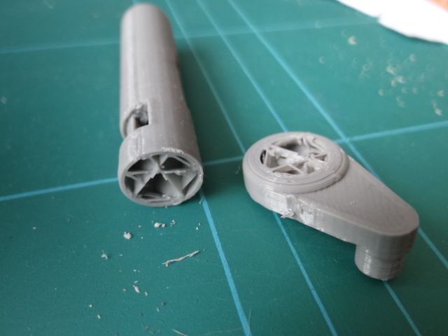

                        Went well until I broke the crank off the rotary valve whilst sanding it smooth in the lathe.
                        As the photo above shows the inside of the rotary valve is largely hollow, consisting of thin triangulated walls forming cells. Here, one of the triangular cells is oversized causing an area of weakness where the crank joins the shaft. Not sure whether to repair with epoxy or superglue, or to print another one, perhaps modified to force more solid internals.
                        Always been concerned about the strength of printed engine components. Partly because PLA is about 10% the strength of mild-steel, and partly because this type of 3D print isn't solid and I don't know how to control the internal web. The slicer software can be ordered to increase the density of the entire internal structure but I only want more plastic at defined weak points like the crank end.

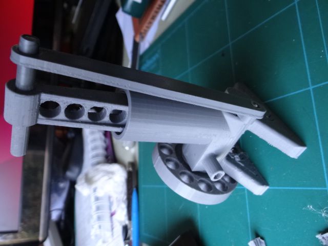

                          All fits together:
                          The cylinder and piston are too stiff to risk putting air into it, more sanding needed and the piston tends to wedge just as Duncan said.
                          Two other problems I should have anticipated – there's nothing to stop the piston turning in the cylinder as it lifts the con-rod, and the con-rod is inclined to fall off even when the engine stopped!
                          Made a mistake cleaning off support plastic as well: I officiously sanded off a ring on the flywheel intended to space it away from the cylinder block. Now I'll have to print a special washer.

                              Posted by SillyOldDuffer on 26/06/2022 13:21:34:
                              Hobby Slicers are pretty 'general purpose''. The hollow things out because in general a machined design would be solid and that takes ages to print. Often a hollow thing is 'sufficiently not shit' to be useable – especially for the general 'landfill ready' prints a lot of people make.
                              If you reframe a little: if you were designing this as a set of castings you would model all the cores and wall thicknesses exactly as you want them.
                              Think of 3D printing as extremely slow casting process with a digital mould and maybe you need to do the design of the parts a little different.
                              When I did some design for a 3D printed prototype I did all the internal work in the CAD and sent the print out (this was 15 odd years ago) to get made as per design. These were SLS Nylon, but the principle is the same – if it needs to be a specific shape or wall thickness then the generic slicer hollow fill is unlikely to be the best option.

                                Spent several hours finding ways of increasing strength. Cura isn't best slicer for this but it has useful features:
                                • The whole model can be printed solid – takes about twice as long. I made a solid replacement clip to hold a wet and dry cleaner together and positioned it so the plastic layers went sideways across the main bending forces.
                                • There are several fill patterns, all designed to save time and plastic, but some are stronger in 3D than others, and the fill density can be increased.
                                • As Dave says, Cura ignores physical strength when slicing, even leaving large hollows under what should be strong. However, Cura's 'Support Blocker' and 'Per Model Settings' can be used to change several selected volumes within the model to different fill settings. Not fine control but much better than just letting the whole model print on the default fast, low strength settings. CAD could identify weak spots with a Finite Element Analysis, but basic engineering principles would probably do: thickening stressed areas, rounding sharp corners, adding webs & fillets etc.

                                Back to the engine, which I tested on compressed air this afternoon.
                                The prototype wasn't printed for strength and nothing broke, even though the crank end of the rotary valve is hot glued on. (Broken removing support plastic with a big knife.)
                                After polishing the bore, piston and rotary valve the engine turns moderately well by hand, though markedly stiffer than a metal engine. Applying air, it did 3/4 of a revolution and I had high hopes adding weights to the flywheel would provide enough energy to power the exhaust stroke. The flywheel weight holes were too small for Jason's pretty ball-bearings so I used 12 M5 nuts, a nice push fit.
                                Didn't work. Plenty of power in the up stroke, but the piston sticks coming down to exhaust. Duncan Webster predicted my design would wedge, it does, but I don't think it's the main problem. Seems PLA bearing on PLA gets stickier as it warms up due to friction – even a few degrees cause bother. Engine gets stiffer the more it's rotated and loosens again up when allowed to cool. Lubed with dry PTFE, not tried anything else. Rethinking…
