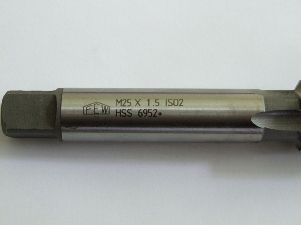

                            That's because threads are specified with various tolerances of fit. The most common, for general purpose use, is ISO2, aka 2B or 6H depending upon the country of origin. This is what you normally get if no tolerance is specified when buying. To ensure fits with most externally threaded parts taps are usually ground at the upper end of the tolerance, ie, oversize. It also ensures a longer life, as the tap takes longer to go out of tolerance as it wears.
                            Better quality taps have the tolerance grade marked, like this tap I bought recently for work:
                            Andrew
