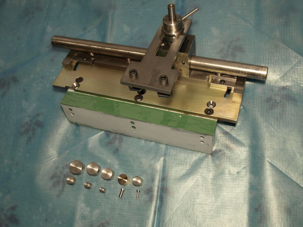

                  Hi Siddley & Keith
                  Its "Nobby " here . The attatchment i made was mainly for using a template to turn machine handles etc. I think 45 degree's would be pishing it a bit as Keith said .
                  Thank you Keith for remembering my post on this There's another system I use may be better and quicker to make . One you could use and set up with a Sine bar using a dti.I will have a look and post photo on this thread

                  Nobby
                    @nobby
                    Hi Again Guys
                    You could use a straight template Up to what angle ? I will have a look The Radius on the tool would have to be the same as the clock to be accurate

                        On my Vintage Drummond & Exe lathe there was no topslide so I made a small low one with about 4" of movement And found it great for screwcuuting and for turning 30 degree centers ect
                        I enjoy improoving small machines as my S7 Mk one needed a tailstock .handles, motor bracket etc
                        Nobby
                        Sexe lathe

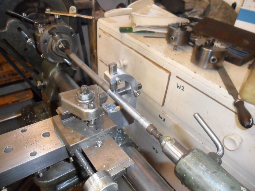

                                            #106195
                                            KWIL
                                              @kwil
                                              Taper Turning
                                              You mean something like this? Silver Steel guide bar with PB lined slider connected to the cross slide.

                                                #106257
