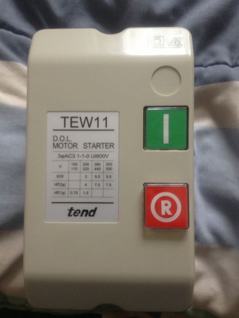

                  Hi guys,
                  This is the switch I got. My motor states 0.5hp and 3.7A, so I reckoned this one should be capable of doing the job. I can go and exchange it if I need to.
                  Charlene

                  Les Jones 1
                    @lesjones1
                    Hi Charlene,
                    You were quick going out to buy a starter. From the picture it looks like the one you bought is rated at 12 amps. This will not protect your motor. One with 4 or 5 amp rating would be better. It should be possible to fit an external emergency stop button by connecting it in series with the internal stop button. Interlocks on the chuck guard and belt cover can be added in the same way.
                    Note added. While looking for information on the starter in your picture I found that it does not have any thermal overload protection. The company do make thermal overload relays to go with this starter but I do not know if these fit inside the starter or inside a separate box.

                          #100273
                          Mike Poole
                            @mikepoole82104
                            hi Charlene,
                            The starter you have purchased should be suitable for your motor, the overload unit is an optional item and will fit inside the enclosure. Toolstation sell these starters and the overload units, their part number for the overload is 44178 to suit your motor. They also sell mushroom head buttons for remote stops. The stop button on the starter is raised and the start button is flush so a panic fumble for the stop should find it even with out looking. The siteing of the starter should be considered for ease of use and so you will not be in line with the chuck on start up , if the work should leave the chuck for any reason it could hit you. The figures quoted on your starter are the ratings of the contactor and as it is rated up to 4hp is quite ok for a smaller load. The overload is the important item for motor protection and they should be adjusted to suit your motor the unit mentioned has a range from 2.8A to 4.2A and usually they are set to the lower value when you get it out of the box. If not set to 3.7A you may have nuisance tripping. if the overload ever trips do not be tempted to turn up the overload, you either are oveloading the motor or you have a fault, turning up the setting will eventually result in smoke and be expensive.
                            Mike

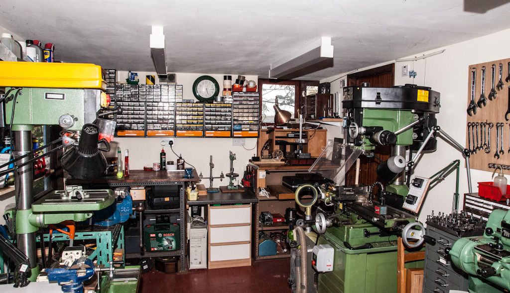

                              You can just see it on the right in this picture – conveniently placed next to my knee when I am working on the machine!  ( Click on photo to enlarge)

                                      NJH –
                                      Norman, totally OT, but where exactly do you do your workshop activities??? Obviously not in that demonstration hall in your photo – or is that your dining room ( eating off the floor, of course!!!)winkcheeky I was teetering on the edge of taking an (out of focus) piccy of my shambles for another current thread but I'm not sure that I shall ever venture into it again. Such exquisite squeaky cleanliness is very disheartening to we mortals!crying 2
                                      Rgds
                                      Bill

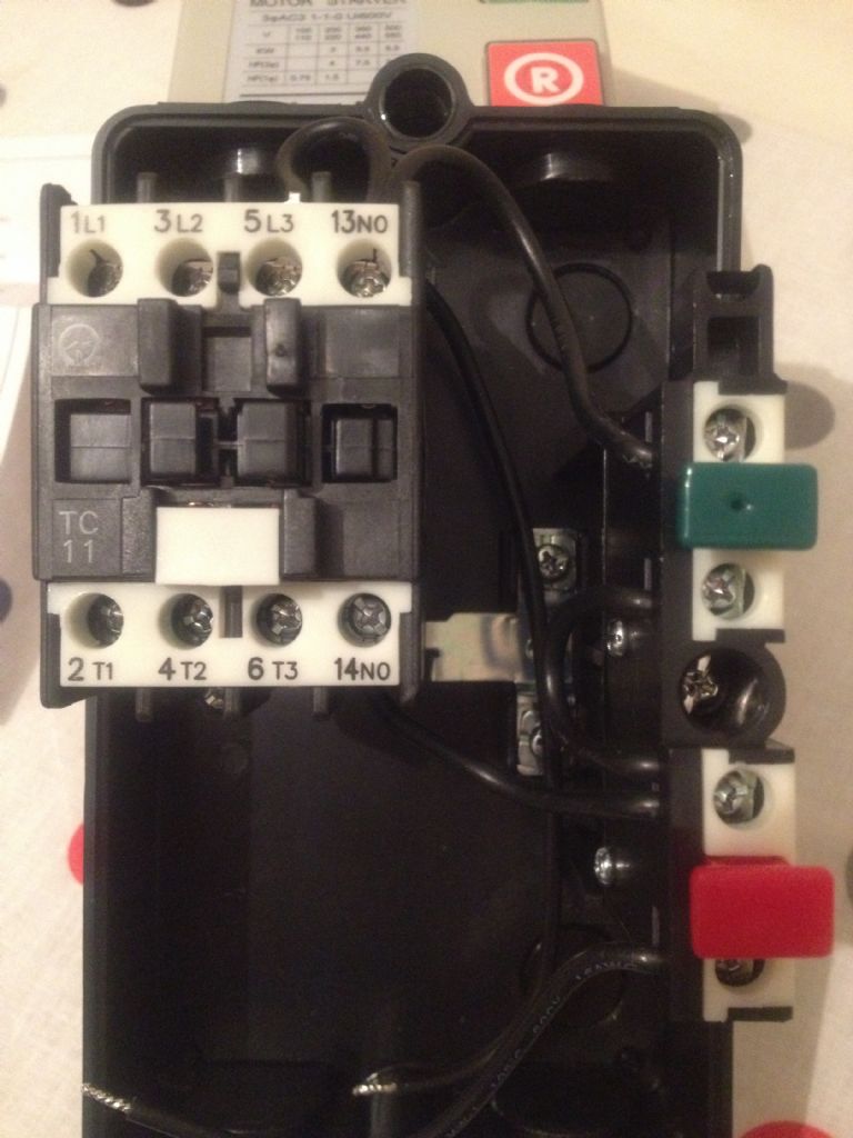

                                            Thanks for your input Les. Strange, but this morning while I was having a coffee at work I looked at one of the switch boxes there and the cable gland and couldn't remember what it was called! Thanks for that! Yes, maybe I will leave the thermal overload for now. Should be able to react when I hear the motor is suffering – shouldn't happen to me in any case.
                                            I know it's only 2 or 3 wires, but I have no idea how to wire it up! No instructions with the switch as well.

                                              #100322
                                              John Stevenson 1
                                                @johnstevenson1
                                                Posted by Charly on 08/10/2012 12:55:35:
                                                I will update my profile as well smiley
                                                No diagram inside the lid ? That's where they often put them.
                                                failing that some decent photos and many here can work the connections out.
                                                Usually simple, L1 and L2 for live and neutral and U &V for the motor leads.
                                                If that doesn't work then use L1 and L3 and U & W

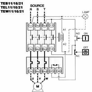

                                                Mike Poole
                                                  @mikepoole82104
                                                  Hi Charlene,
                                                  I have uploaded a diagam of this starter to help my explanation. The diagram shows the 3 phase configuration with overload unit but the single phase version is a small variation. The supply should be connected as follows Live (brown) to 5L3 and Neutral (Blue) to 1L1. Connect the motor live to 6T3 and the neutral to 4T2 on the overload unit, insert a wire from 2T1 to 3L2. Connect the two free wires that have tinned ends to terminals 95 and 96. Check that the thin wire of the two free ends is connected to coil terminal A2. Check or insert a wire from 1L1 to coil terminal A1. The two most important wires are the earths, these must be connected together and an earth point is usually provided in the starter.
                                                  If you do not want the overload unit connect the motor live to 6T3 and the motor neutral to 2T1, the link from 2T1 to 3L2 will not be required remove the thick free ended wire from the red button and insert the free end of the thin free ended wire.
                                                  If you wish to use a remote stop button move the wire that comes from terminal 14 on the contactor from the red button to the bottom of the green button, remove the short link from the red to green buttons and wire the two leads from the remote stop one to the bottom connection of the green button and the other to the top connection of the red button.
                                                  I would advise you to have your handiwork checked by a competant person.

                                                    Kwill and Co. – "It is a Palace of Engineering, not for working in! " Well sorry – it was just a pic I took for the other thread and I used that rather than go out and take one of the starter switch.
                                                    Having managed in several rather pokey, untidy, cold and damp workshops previously and then moving to a place with a double garage I determined to make a dry and comfortable place to "play" in my retirement. I enjoyed the conversion work but, like Topsy, it growed!! If you look at the pic in my album of the other half of the garage then the usual state of my workshop is somewhere between the two!
                                                    My criteria for a workshop is that it must be pleasant to go into, it must be dry and possible to heat economically. Tools must be easily found and, for safety, the space on and around machines must be clear. My interest is in the smaller end of engineering so keeping it fairly tidy also avoids losing bits!
                                                    So Bill post your pictures  it's always interesting to see how others are set up and ideas can often be gained.
                                                    In the end though the important bit is not the workshop but what comes out of it. I make no claim to any great achievement in this area – but I do enjoy trying. ( And in some degree of comfort!)

                                                    Les Jones 1
                                                      @lesjones1
                                                      Hi Charly,
                                                      It is difficult to see from the photograph where the wires at the top go to. Can you confirm (Or correct.) my understanding of the wiring from my interpritation of the picture.
                                                      1 The start button is in parallel with the contacts 13no and 14no
                                                      2 There is a second wire connected to terminal 13no which is one end of the coil.
                                                      3 The wire end in the middle of the bottom of the box is the other end of the coil.
                                                      4 There are no wires connected to terminals 1L1, 3L2, 5L3, 2T1, 4T2 and 6T3
                                                      5 The "T" shaped piece of metal to the right of terminal 14no is not connected to anything.
                                                      ****** IF I HAVE INTERPRETED THE CONNECTIONS CORRECTLY *****
                                                      Connect the incoming neutral to 1L1 and connect the wire that is at the middle bottom of the box to 1L1
                                                      Connect the incoming live to 3L2 and connect the wire from the bottom terminal of the stop button to 3L2 (You may need a longer piece of wire.)
                                                      Connect the motor neutral to 2T1
                                                      Connect the motor live to 4T2
                                                      The "T" shaped metal plate is probably for joining the incoming earth to the motor earth.
                                                      If you are not 100% sure DO NOT PROCEED
