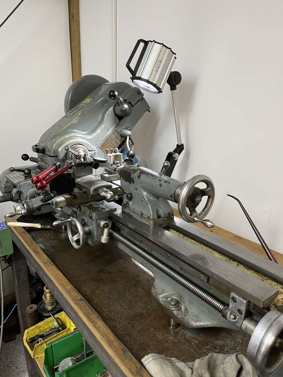

      Hi all.
      New on here, so apologies if this has been asked 100 times before.
      I have owned my father’s Super 7 for at least 30 years. He had had it a good 10-15 before that. I have never seriously looked at setting it up beyond throwing a bubble level on the bed either end & leaving it at that.
      I recently set to with some centres, a precision test bar & a morse taper test bar, and these are my results: spindle nose OD – 10 microns. Shoulder 6 microns. Taper 20 microns.
      100mm Morse taper test bar: spindle end – 50 microns. 100mm out – 150 microns.
      Centres in head & tailstock, 200mm test bar: Indicator on top of bar – headstock end 0, tailstock end +30 microns. Indicator on side of bar: headstock end 0, tailstock end + 25 microns.
      My feelings are between centres & on the nose it’s not too bad. Run out on the headstock morse taper is not good. It looks in clean condition with no dents.
      So really after some opinions on this. I was going to set up the lathe ‘properly’ using the MT test bar, but I’m not going there with that amount of run out. Spindle bearings are all good and adjusted as per the manual.
      Regards: Chris.

                                  SK 75185 in all its glory.
                                  IMG_7623
                                  I need to reduce the photo size.
                                  Fixed centre in headstock and tailstock. MT2 test bar between centres after cleaning them. Extreme ends of taper & of test bar – 0. Clock doesn’t move. Headstock end of parallel bar where it transitions to a taper – 0.0005” run out.
                                  I suppose with spelling like that, I might have known. Will invest in a proper one that comes with a cert.
                                  Blue being at work, I did the pencil test, and it does show the taper being slightly tight at the back, but that relies on the mandrel having been ground correctly.
                                  I think as suggested, buy a collet & try that. Go from there. Do the test piece turning & shim the feet to correct any error. Lastly align the tail stock.
                                  Regards: Chris.
