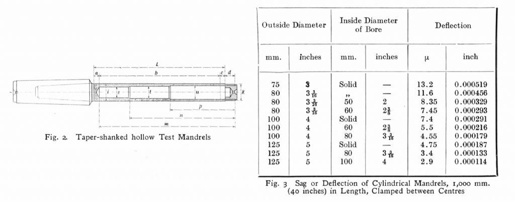

                                That all sounds very reassuring, Bill yes
                                … Thanks for sharing your findings.
                                It looks like your particular example [and therein might lie the rub] is entirely adequate for day-to-day use, and as such represents great value for money.
                                If you want to understand how the other half live … it’s worth reading Schlesinger
                                dont know
                                Edit: __ That nice Mr Stub Mandrel hosts a copy here:
                                http://www.stubmandrel.co.uk/component/content/article?id=13:dr-schelsinger-s-limits
                                Edited By Michael Gilligan on 09/10/2022 14:08:46
