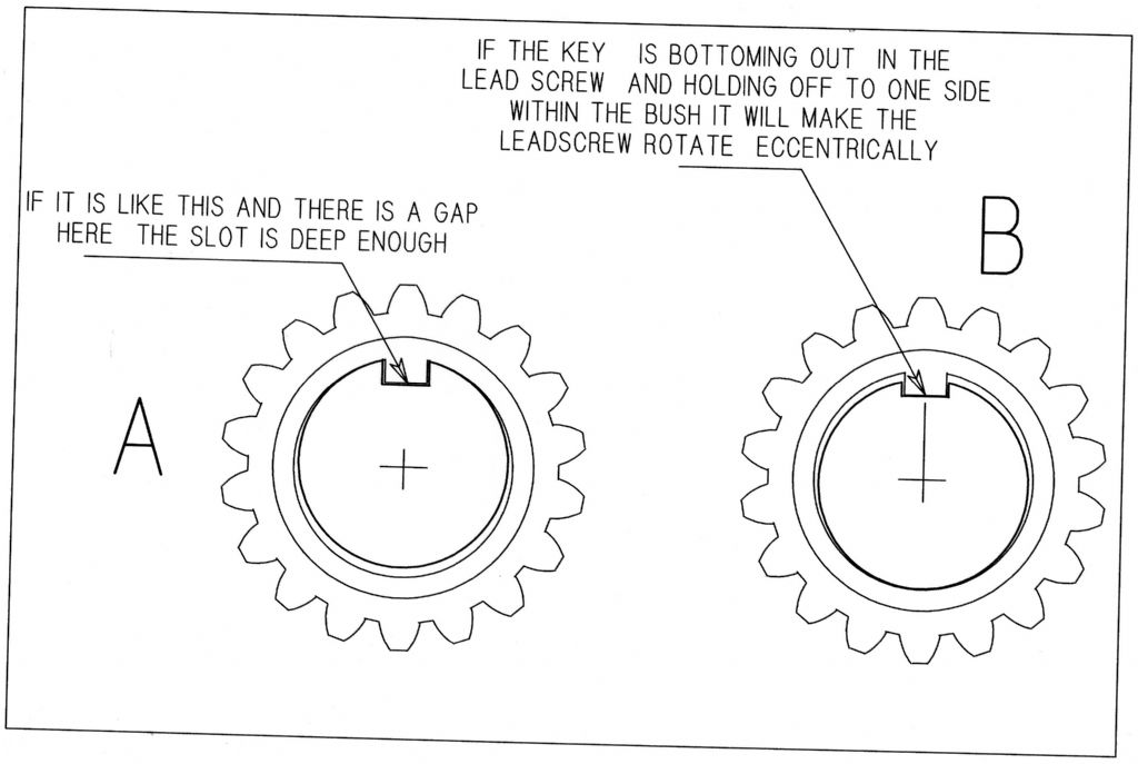

                          Hi Robert ,
                          Seeing your posting it seems the problem is with the lead screw and or nut.
                          The depth of the slot in the lead screw only needs to be deep enough as in the
                          sketch "A" ,i can't remember how much clearance there is in the inner bore
                          of the gear bush and lead screw the last time that i had mine apart was in
                          2005 when i converted the machine to part cnc.
                          If you fit the gear /bush on to the lead screw and look endwise with the
                          lead screw pushed hard towards the the key the screw should be able to
                          touch the inner wall of the bush and just still have a gap between the bottom
                          of the slot and the top of the key as in "A" , if you have a situation as in
                          the sketch "B" where the slot is not deep enough in the lead screw then the
                          screw would be forced off centre ,as you have said and i would agree there
                          may be a problem with the axial alignment between the bush bore and the
                          thread in the nut if that is so with a situation as in "B" and that would probably
                          result in cyclical binding.
                          Just have a look at this to see if it is the cause.

                              A report back, I have examined the gap in the slot of the imperial leadscrew with the key having assembled the nut onto the screw and fitted the gear/bearing as you suggested and illustrated in your sketch, there is adequate clearance. I repeated the exercise with the metric screw, nut, gear bearing and the clearance is the same (no means of measuring accurately) with a clearly visible "gap" along the length of both screws.
                              I again refitted the metric screw and it is perfect.
                              For what it's worth, i think there is a lack of concentricity with with the screw, the nut or bore in the saddle?
                              Thank you for the diagram and assistance so far.

                                Hi Robert ,
                                On seeing this i had sort of come to same conclusion,
                                "For what it's worth, i think there is a lack of concentricity with the screw, the nut or bore in the saddle?"
                                When you look at the product on the Myford page they claim to lap the nut and the screw together
                                so they are a pair, there would not have to be much of a mis-alignment in these parts to give a
                                problem if that is so.
                                The bore in the end of the nut should be concentric with the outer diameter of the body
                                of the nut that fits within the apron similarly the threads should be the same these are the only
                                parts left to look for the problem and this only seems to occur when you push the nut right
                                home.
                                I don't think you have anywhere left to look.
                                When you refit the the screw and the bracket as their advice is to leave the screws
                                loose for the bracket to settle into position and then tighten the screws, you could just
                                try to bias the bracket up a little and tighten the screws and also try the same down
                                and to each side in turn to see if there is any difference.
                                Clutching at straws here but worth a try to see at any difference in any of these positions.
