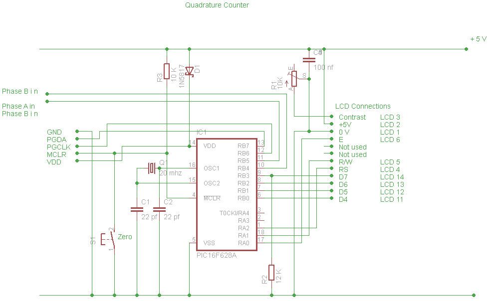

                      I have never used these switch contact type of encoders. They have the potential to generate noisy signals which may require filtering either electrically or in software in the microcontroller. When they are used in a mouse it does not matter if they miss a step but in your application a missed step is 1/8 of turn of the leadscrew. (The ones in the link on Ebay gave 24 pulses per rev.) The two outputs on these encoders allow the counter to count up or down. The reason for asking about preference of display type is because the microcontroller cannot afford to miss seeing the signals from the encoder while it is doing something else like multiplexing an LED display. This means that the software has to be designed from the start knowing the type of display being used. The valve type displays you mention are called “Nixie” tubes. They would be more complex to drive from a microcontroller as they work on fairly high voltage.
                      This is the schematic for the display I built for my mill many years ago. This uses an LCD display.
                      Les.

                                              It will be possible to modify the code so that negative values are displayed as zero. The code in the unit at the moment is not the original that displayed position in mm when it was on the mill. It has been modified for testing other units that display the output from the Chinese calipers / scales. It displays the count in decimal on the top line of the display together with a minus sign for negative numbers,
                                              On the bottom line it displays the value as a 24 bit hexadecimal number. If the top bit of this number is set then the decimal display is considered to be negative.
                                              Les.
