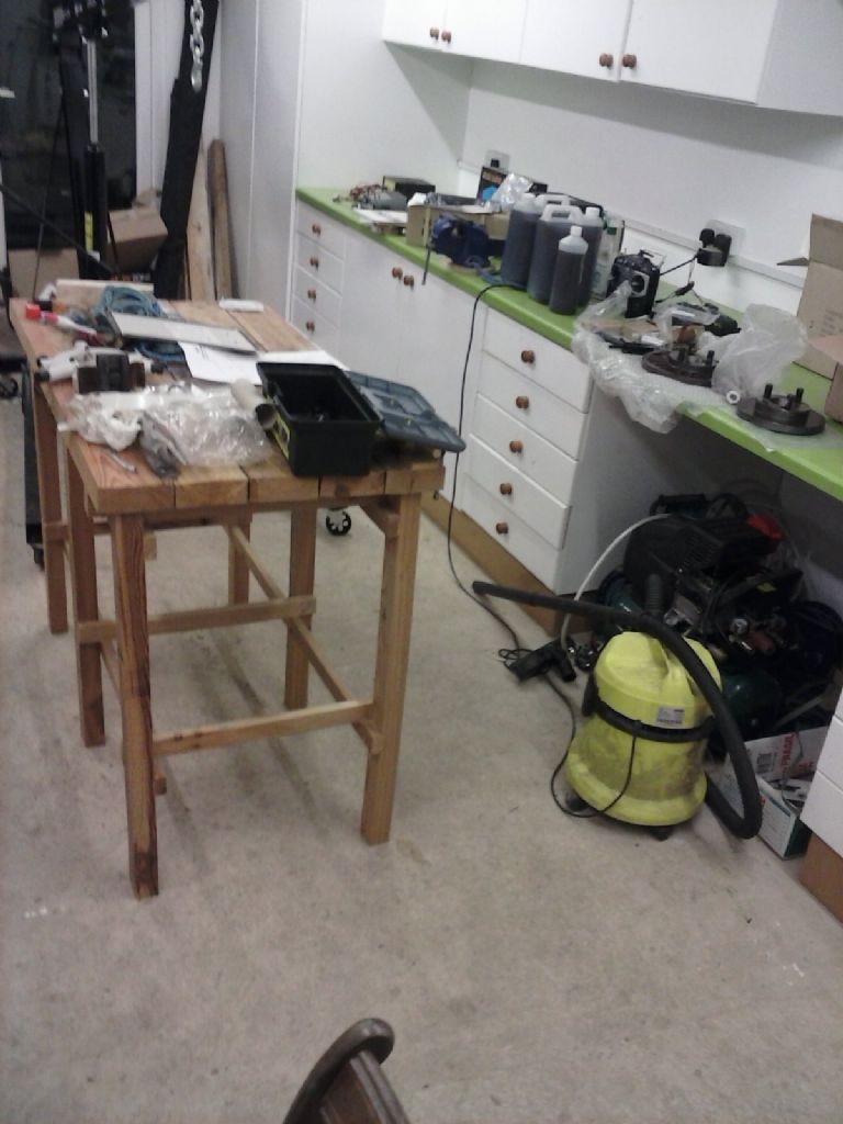

                Retirement and the big 60 has made me meaner when it comes to spending on stuff I can create. My sheds whole run of kitchen type units and worktops were DIY from MDF sheet. It can end up as strong as you want especially when held with brown glue.
                Half the hobby shed run visible below

                    Thats very impressive. How well do the drawers cope with tooling and similar metal loads which must, I think, be some what greater than they were designed for? Despite successfully using the cabinets in the past with my idea of suitable reinforcement, probably overdone, I've always considered the drawer and runner structures both inherently too flimsy for shop use and too hard to upgrade. Beginning to think that assessment may have been wrong. Despite my chronic habit of vastly overloading storage of any type.

                      Draws on rails, with ball bearing runners take a fair bit of over load, and still move with a finger touch.
