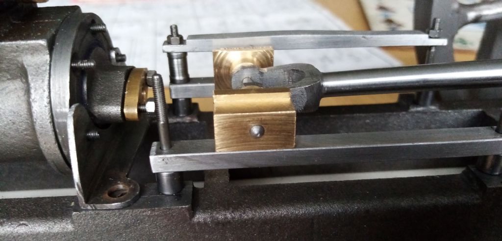

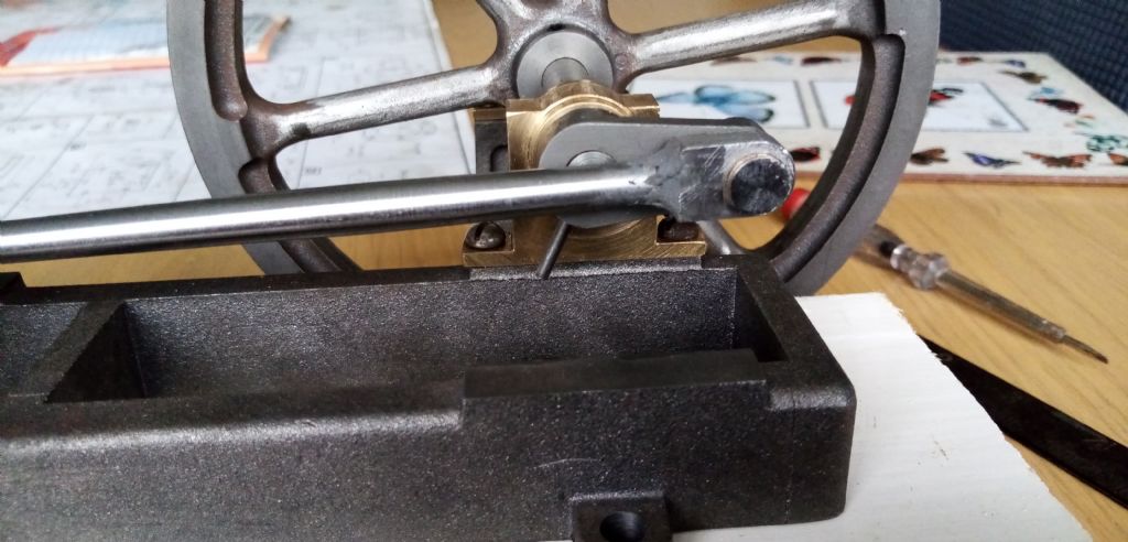

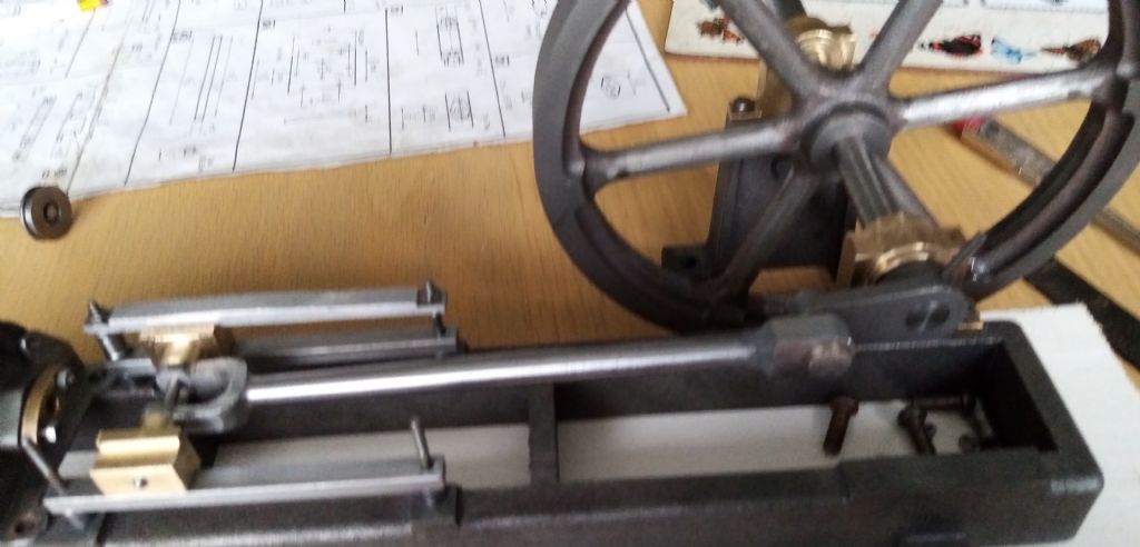

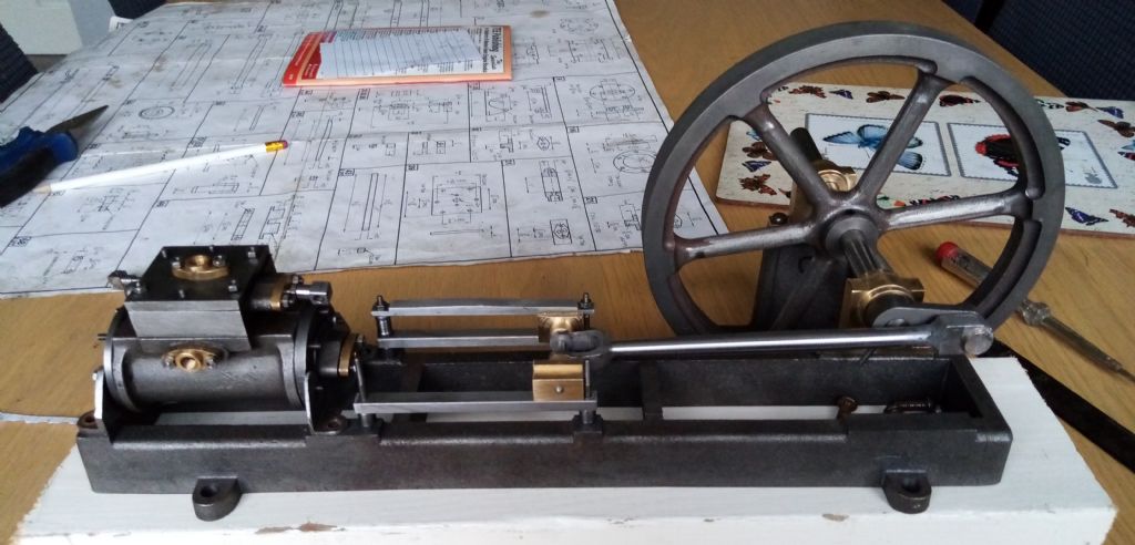

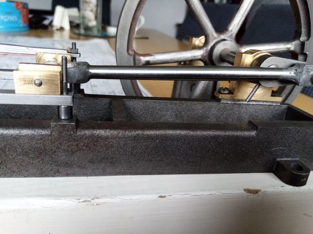

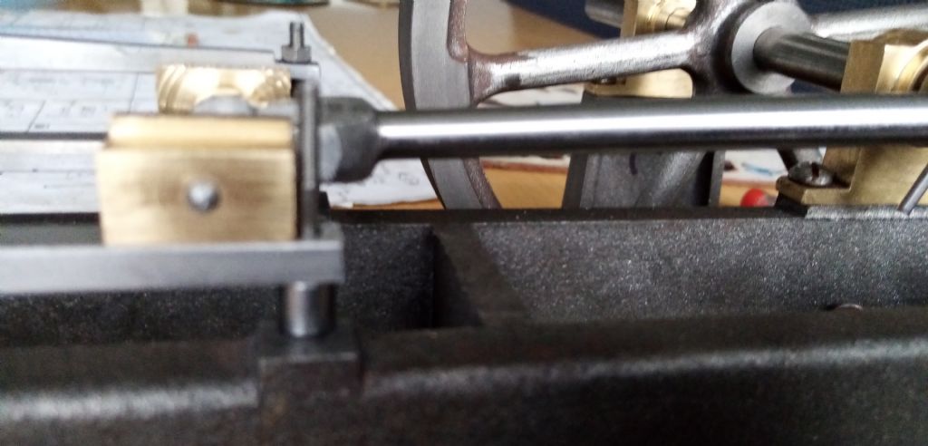

        Hi all
        I have just got to the stage of doing a trial assembly of the engine (photos to follow) and have come across a big problem.
        On the out stroke the slide bearings hit the back posts and on the instroke the bearings are 7/16 off the front posts and the piston is the same distance short of its "full" return position.
        Its almost like the con rod is 3/8 short between centers.
        I have double checked my dimensions and they are spot on
        My question is would the engine stroke under pressure with the piston not getting back to the end of the cylinder.
        Thanks in advance
        Art

          It sounds as if your diagnosis of the the con rod centres being too small is correct.
          Effectively the piston and cross head need to be moved forward, relative to the Crankshaft bearing saddles.. To my mind, the distance should be such that if the engine is double acting, the clearance at inner and outer dead centres should be equal.
          To avoid damage, I certainly would not apply air, or steam, pressure until the situation has been rectified

              Hello Arthur,
              Given that the cross head slide bars are at their correct location and I'm sure they are then the issue has to be either the conrod or the piston rod length. As previously said at mid piston stoke the cross head should be equally spaced between the ends of the cross slide. (The crank will not be vertical at this point)
              I would look at the piston rod length between C/L of piston width and C/L of cross head pin again as I think this is where your problem may lay
              Regards – Tug

                  As I see it given that the crank bearings and the slide bar mountings are located on the engine bedplate and thus likely to be correctly positioned, then the crosshead should not impact the slide bar posts if the conrod is the correct length regardless of the piston position. Disconnecting the piston rod from the crosshead would eliminate it, or not, from the equation.
                  Jim

                                        Re jasons post. As i said my con rod centers are 61/32 bu my crankshaft to center of guidebars is just over at 63/64 not enough to creste my problem.
                                        Im thinking the pads on my baseplate are out and will speak to stuarts tomo sbout it.

                                            Looking at your photos I feel that your con rod is short. I fail to see how the pads on the base casting can be wrong
                                            Roy

                                              From the photos it appears the con rod is short. Noel.

                                                    Hi Arthur – just come in from the shid and seen your PM. Some others may benefit from these thoughts
                                                    I would agree with others but looking at the images it's likely to be one of several things.
                                                    Not in any order specific order.
                                                    The piston rod is too long – cross head hits rear post before piston is at bottom of stroke
                                                    Con Rod is too short (likely) or Crank throw is too big but if the latter the slide should move the same distance in the opposite direction (unlikely)
                                                    Main bearing position is wrong relative to length of con rod.
                                                    Cross Head slide is wrongly positioned.
                                                    Looking at your images you do not appear to have anything positioned wrong and you say you have checked the dimensions. Given that all is correct in layout dimensions – you need to evaluate what is causing the problem.
                                                    Ignore for the moment any drawing dimension of parts.
                                                    Concentrate first on being able to get equal movement of piston and cross head.
                                                    With the piston at mid stroke so should the crosshead be. If you can set the piston and cross slide in such an equal set up then you have the piston rod the right length – ie equal movement either side of mid stroke gives an equal gap between piston and cover and between cross head and end post. If you can't obtain that equal movement then the piston rod requires to be modified to give that situation. Once that is correct the rod length can then be looked at. Bear in mind at mid stroke the crank will be at an angle relative to the perpendicular position.
                                                    Always happy to add more if required but if you begin with trying this first I think you will soon see where the error lies.
