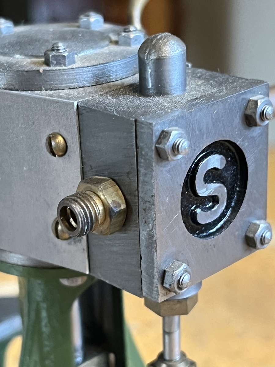

      Hi, After a l ong absence due to illness in the family I am beginning to get back to building the Stuart V10. I have managed to assemble it and have done a dry run by setting it up on the lathe to run it in.
      Can someone tell me how the steam inlet joint ( I have used a 1/4 x 32 thread) seal is achieved. I purchased copper tube size: 1/8″ x 22g (0.7mm wall thickness)
      Scott.

        I don’t exactly understand your question but you need a fitting on the end of the copper tube that screws into the 1/4×32 thread.

          Ok. Thanks for that. Can you tell me what fitting is required. Does there need to be a nipple soldered on to the tube?
          #837252
            If you intend to run on steam then you need a fitting with the 1/4 x 32 thread on one end and on the other it is usual to have a nut and nipple (ferrule) where teh nipple is soldered onto the end of the copper tube then much like a domestic plumbing fitting the nut draws the tapere dend of the nipple tight into the fitting. To seal the screwed thread you can either use soft copper washers or a thread sealant.
            This sort of fitting but check the thread as a lot of suppliers use 40tpi rather than 32, stuarts do one with 32tpi but for 5/32″ pipe.
            If running on air just for display then make up a simple threaded fitting with a spigot to push a piece of flexible hose onto.

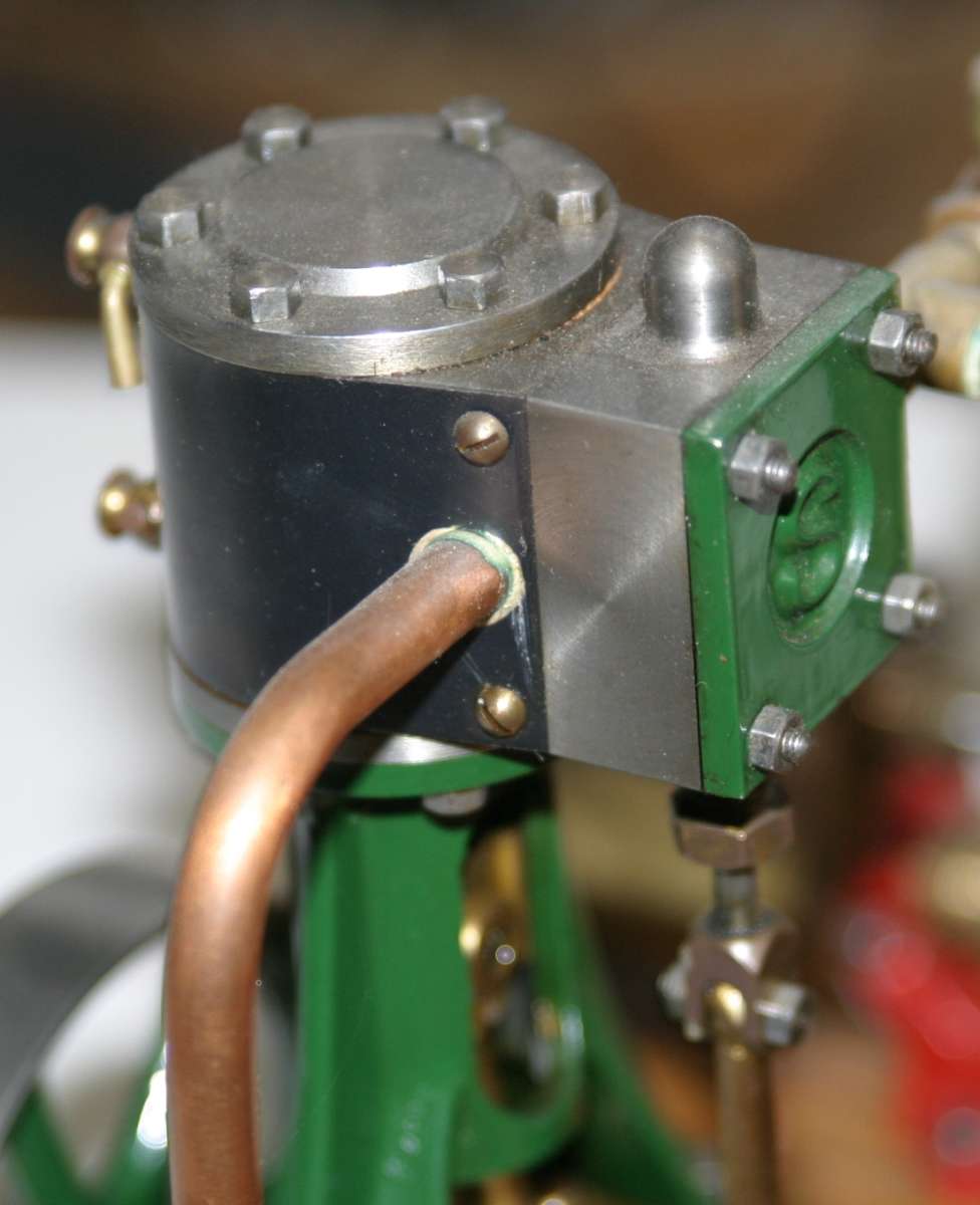

            Buffer
              @buffer
              Hopefully this wil be of some help.  The pipe is just threaded and spun in.IMG_5527IMG_5529

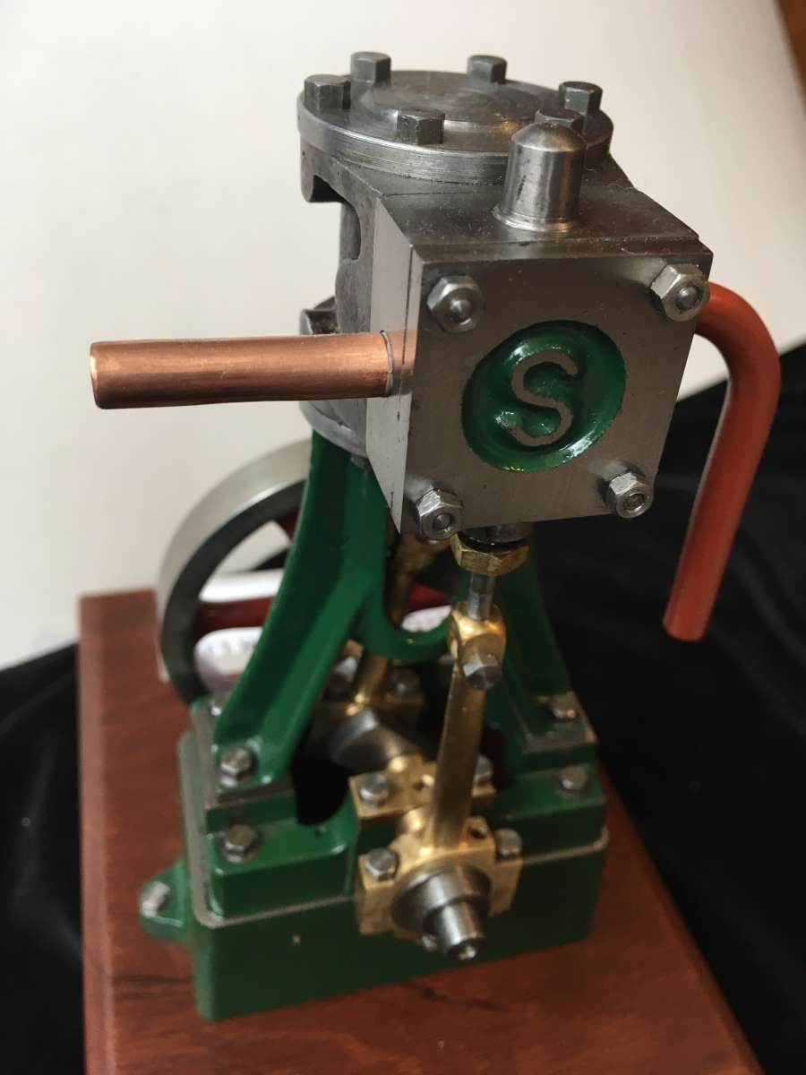

              Richard B
                @richardb44403
                <p style=”text-align: left;”>Where I run them off a car tyre compressor I just thread in in bit of copper tube as it fits the compressor coupling.IMG_0605</p>

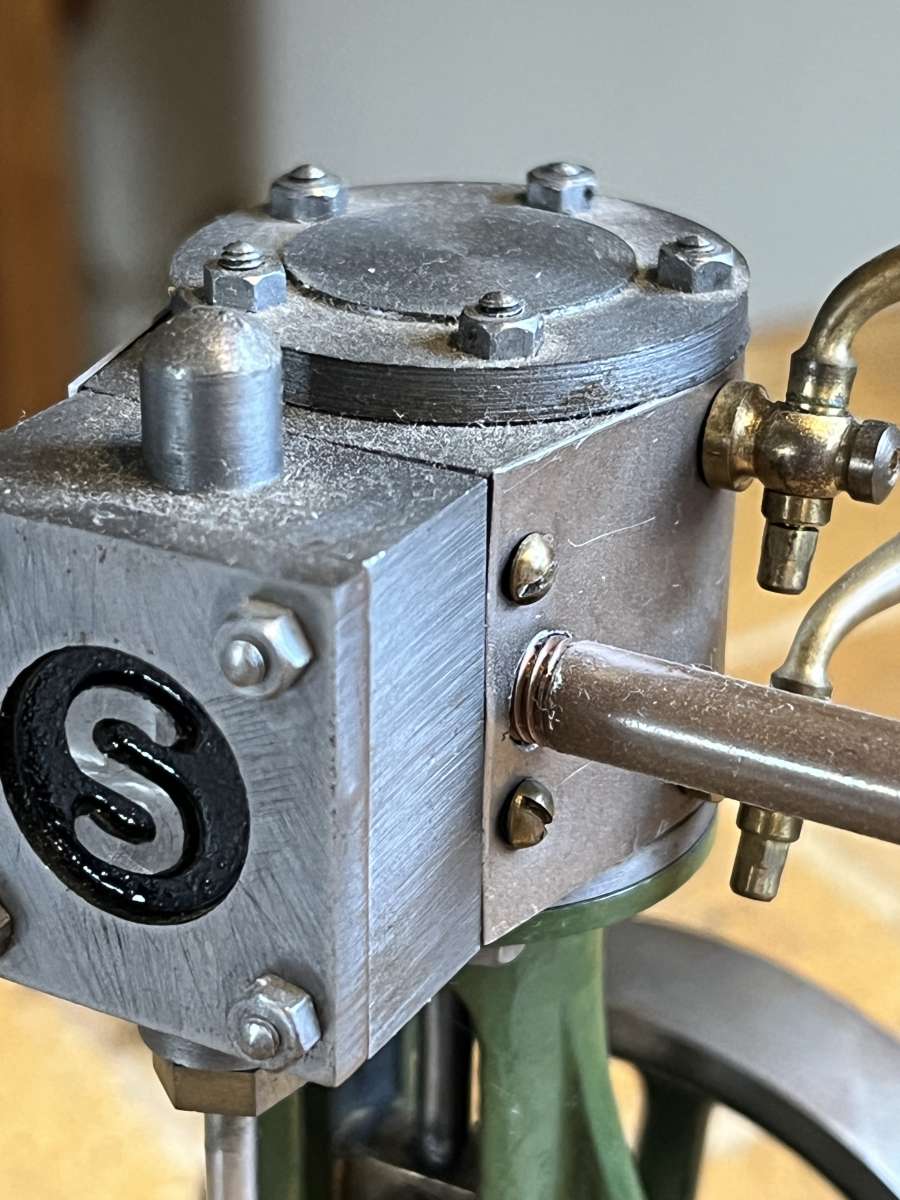

                Clive Foster
                  @clivefoster55965
                  Pretty much whatever you do the connection is going to look “a bit odd” relative to full size practice on an enigine of the  basic type the Stuart model is representable.
                  Personally I’d use a proper threaded fitting as the extra work involved is not great and the engine can be run on air or steam as desired. In my view a nicely made Stuart with an equally nicely made boiler is much more impressive than the engine alone.
                  Whatever you do plugging the ports, with screw on or push on caps, when not in use is probably prudent. Given reasonable care in storage, and post run drying out after running on steam, the chances of corrosion or other bad things happening due to uncovered ports is very small. Which doesn’t alter the major embuggeration of sorting things out if something does get in.

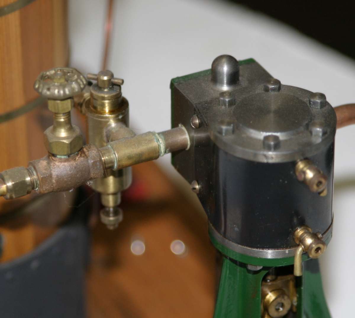

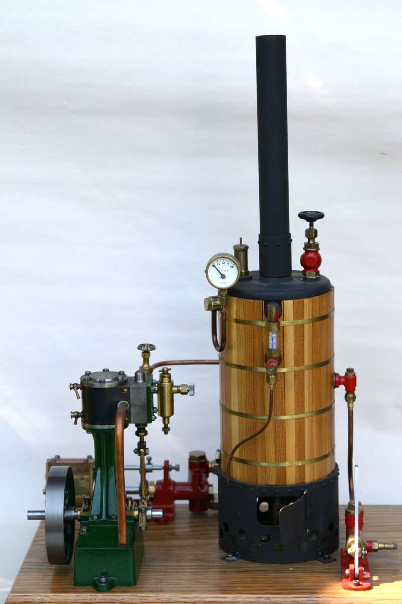

                  John Purdy
                    @johnpurdy78347
                    Clive
                    You mean like this?
                    Scott
                    Here is how I did mine. If I remember I threaded both the inlet and exhaust 1/4-40 ME.
                    Stuart-Turner # 10, Boiler & ST Steam Boiler Feed Pump
                    10 EX
                    inlet 10
                    #837505
