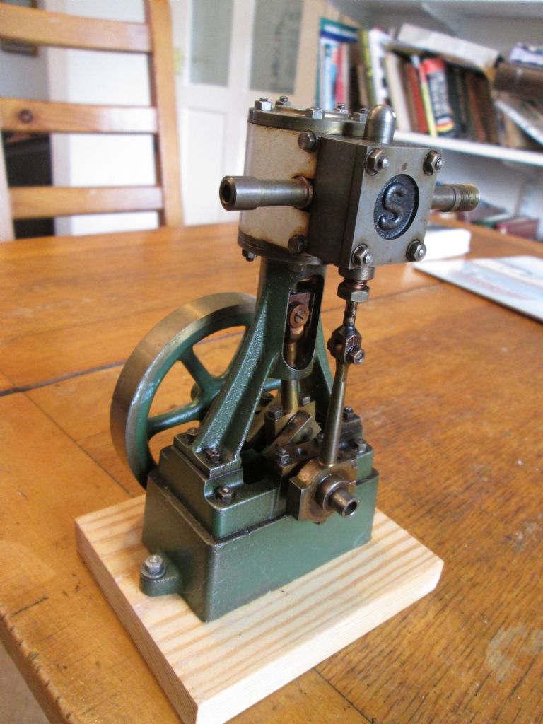

                                                  Mick B1
                                                    @mickb1
                                                    Posted by Dr_GMJN on 23/07/2020 08:55:40:
                                                    Presumably the 3.1mm diameter valve rod is a suitable diameter for a 5BA thread?
                                                    From what I can find, the O/D on a 5BA thread should be 3.2mm, so a 0.1mm undersize should be safe in terms of threading (but maybe a bit sloppy?
                                                    Cheers.
                                                    The fit of the flanks matters more than the o/d. 3,1 should be fine. With a normal split die you can adjust how much you tighten down the two screws that bear on the free ends of the arc, in tandem with the centre screw that opposes them. start with the die slightly open, test the result, then tighten it down if necessary by a few degrees turn on the screws, and test again till you get a light friction fit. But if you go a little too far, a bit of slop's unlikely to affect function.
                                                    My 10V's a crude job in comparison with yours, but it's worked very nicely for 25 years.
                                                    Edited By Mick B1 on 23/07/2020 09:21:42
                                                    #487201
                                                    Dr_GMJN
                                                      @dr_gmjn
                                                      Posted by Mick B1 on 23/07/2020 09:16:59:
                                                      Cheers.
                                                      Thanks Mick – I'll do that with the die.
                                                      Your 10V looks fine to me, I'd be more than happy with that, the main thing is that it runs well.
