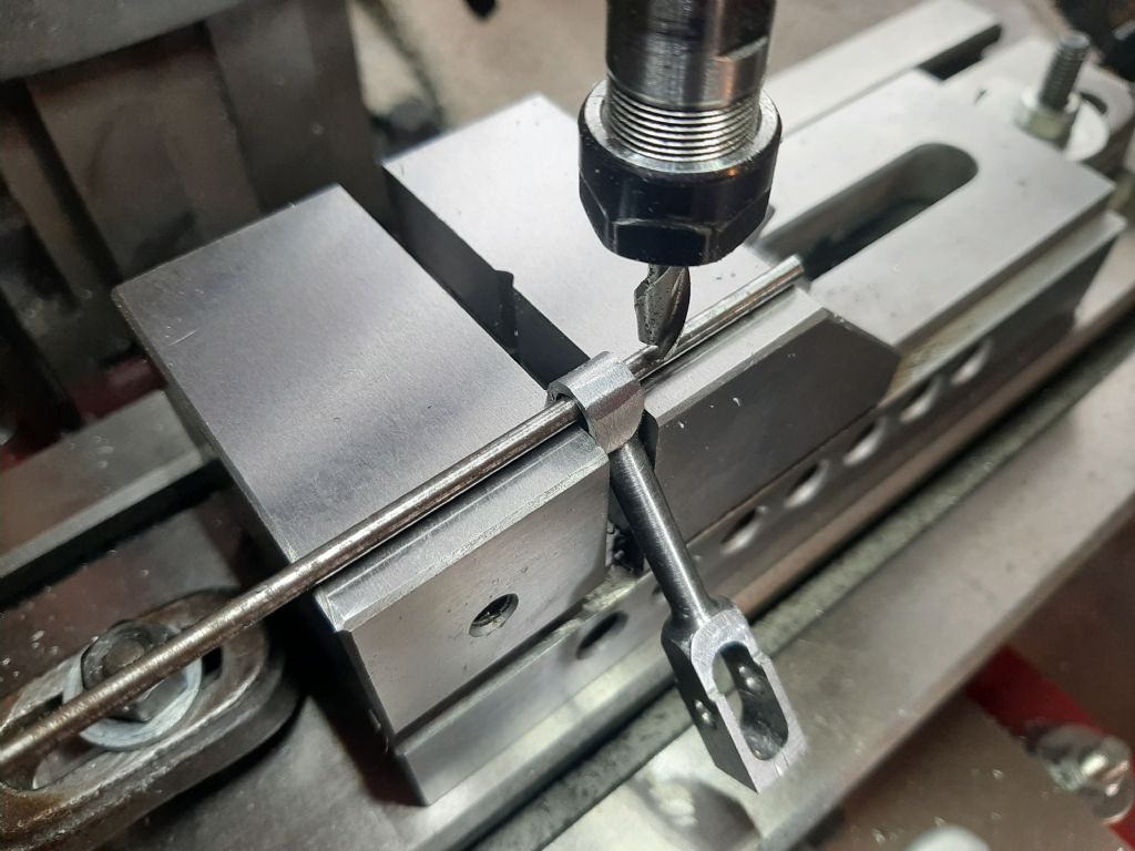

      You can mill the rough cast outer rim of the cylinder concentric with the bore
      Pass short length of silver steel about 8mm diameter through the bore.
      Clamp the cylinder in a machine vice but push the bore down on to the s.s bar which will be resting across he top of the vice jaws
      Take a light skim of the rim with the cutter and lock the cutter
      Rotate the cylinder a few degrees at a time and take more skims making sure for each skim the bore is resting on the s.s
      Keep rotating until the whole rim is skimmed and finish with a flat needle file

            It does not have to hang vertically, just ensure the work is pushed down against the supporting rod to get a constant thickness. The wall thickness is set by the cutters height above the support bar which remains constant whatever angle the work is at.
            Here I was making a cylinder from solid and used the method on the smaller diameter, you can see the facets that the method produces.
            Quick bit of filing to blend them in.

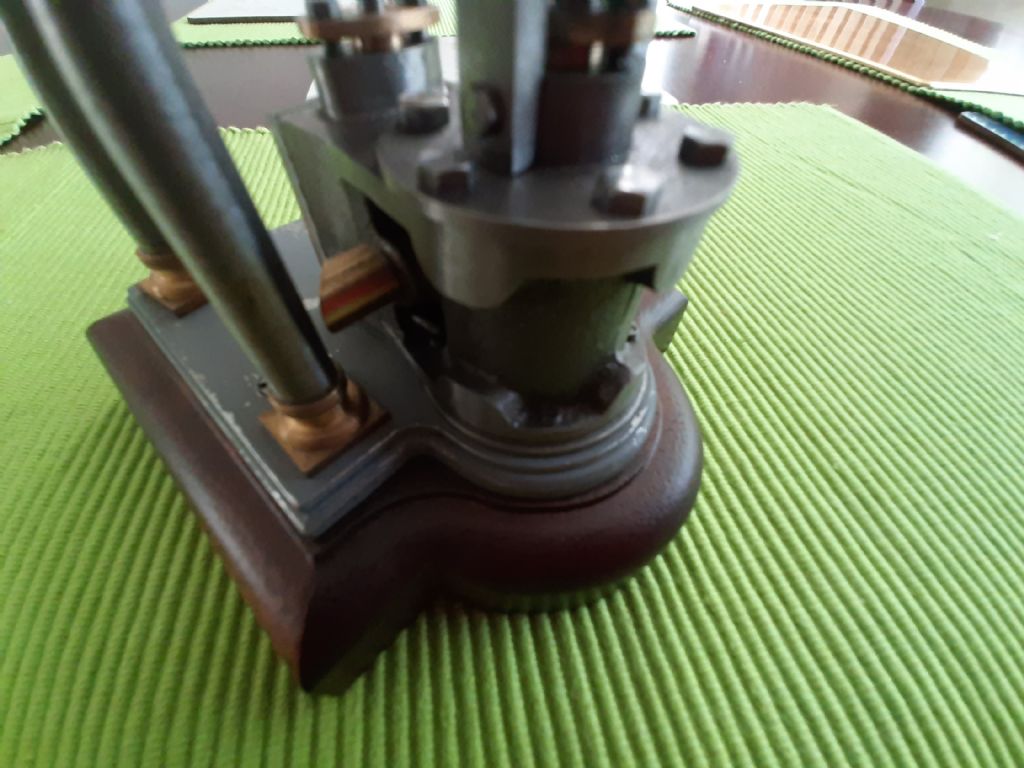

            geoff walker 1
              @geoffwalker1
              Hi Dr G
              Trust me and Jason, last post, the method works.
              Here is a photo of an inverted engine, same one as Jason's which uses a 10v cylinder. You can see the machined outer surface is concentric with the lower cylinder cap. The tapered section is held horizontal in the vice but still with the bore resting on the s.s. bar
              Also did the con rod using the same method, 3mm bar through 6.5 hole20200408_093045.jpg
