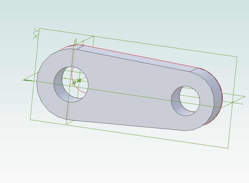

                                              #495002
                                              DiogenesII
                                                @diogenesii
                                                Can you not re-profile them so that they taper slightly – if you set them up (perhaps with pins/rods through the holes) in the vise and touch off on the "thin" side and then flip them over to reduce the "thick" side to the same dimension..? ..as the end radii are generated from the opposite hole, they won't look out of square – the eye won't have anything to pick-up on..
                                                #495004
                                                Dr_GMJN
                                                  @dr_gmjn
                                                  Posted by DiogenesII on 10/09/2020 06:30:16:
                                                  I’d have to take the new line from the corner of the radii though, which would a) make the wall thickness next to the large holes very small, and b) make the two opposing sides non-parallel (I do understand your point about the radii making this less obvious though). I think it would probably just look wrong in a different way.
                                                  To be honest it only took a couple of hours to do, so I might as well do it again. The error resulted – indirectly – from the failed solder joint. Initially I marked the holes out as a check, second try I didn’t bother, and relied on the DROs and edge finder. I must have caught the rounded edge of the stock when using the edge finder I guess. Strange though because edges look consistent, and I measured at the same height side to side.
                                                  #495005
                                                    Posted by Dr_GMJN on 10/09/2020 06:45:35:
                                                    If you forget the shape of the ends and round them over then the "flats" will be tangental to the end radii so no loss of metal around the holes.
                                                    #495017
                                                    Dr_GMJN
                                                      @dr_gmjn
                                                      Posted by JasonB on 10/09/2020 07:10:33:
                                                      Thanks Jason. Yes, that would work. However I think to profile it would possibly – for me – take longer and be more prone to error than just making a new pair. I’ll see if I can source some 3/16” mild steel locally. If not I’ll try to re-profile the originals.
