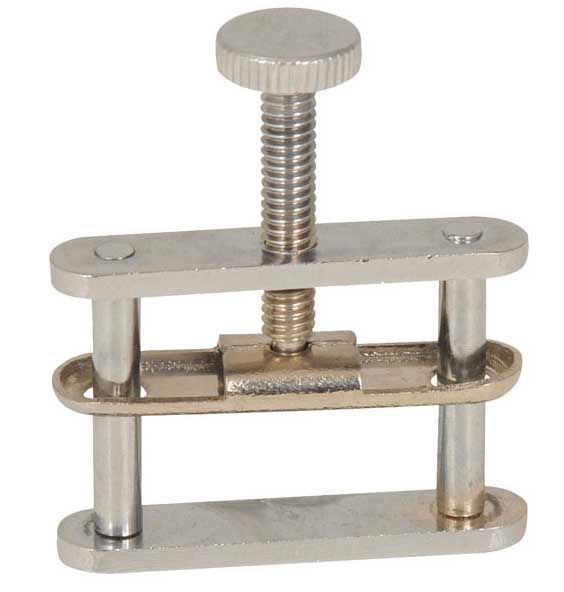

                                        Roderick Jenkins
                                          @roderickjenkins93242
                                          Those of us from a sciency background would use a tube clamp:
                                          Rod

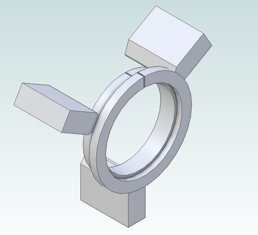

                                              So next the lower cover. I still don’t really know how to reverse and hold it. I don't have soft jaws, and the three jaw chuck isn't great (it didn't matter for the top cover). I'm still wondering if turning a socket in some brass to a press-fit around the gland boss would do, then superglue the half machined cover onto it. If I used my previous double parting off method, then I'd only be cleaning up the face, spigot diameter and depth using very light cuts. All the drilling, tapping and reaming would have been done on the other side already.

                                                Another option is to make a split bush. Take a short length of stock about 6mm larger diameter than the cover and turn a spigot on the end about 5mm long. Reverse the bush in the chuck so that you are now gripping by the spigot and the larger dia is pushed back against the front of the jaws. Bore right through a couple of mm less than cover diameter and then for about 2mm deep open up to a snug fit on the cover's outer edge.
                                                Mark the bush in some way so it goes back into the chuck in the same position before removing and cutting a slot right through it. You can now slip the cover into the recess, put bush into chuck and pushing both back against jaws and step in the bush tighten the chuck.
                                                As the recess was turned it will be concentric so provided you put it back in the same position the hole will remain concentric and therefore hold the cover concentric and as the back of the cover has something to register against it won't wobble either.

                                                  I did think of something like that – but my thinking was as soon as I removed it from the chuck, the precise concentricity might be lost. If it works, I am much happier making that, than the other methods.
                                                  I suppose I could check concentricity by putting my dial gauge on the outer diameter of the fixture ring? Combined with the the undersized thread…I think this might actually get done this weekend after all.

                                                    Should not matter as machine vice jaws are smooth so won't mark like a bench vice. Just make sure they are clean of swarf.
