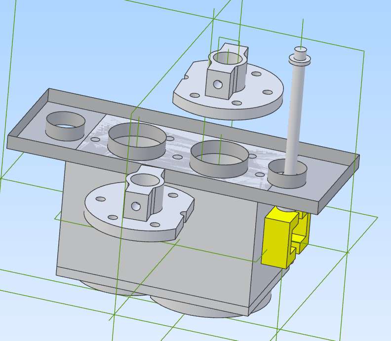

      I’ve examined the appropriate Part model and its Assembly, the Colour menu shows 100% Opacity, but what’s happened to the central plate, please?
      An edit after going back for another look, and found:
      Even odder, if I flip the assembly over the plate looks solid. I can’t pick up the external surface to constrain the covers to it. It acts as a very thin translucent tray with two hollow cylinders glued to it! So the constraint tool can only find the inner surface (against the cylinder block).
      It not only looks peculiar. It’s making it very confusing to build up!
      I should add I’d been trying to modify the bolt-holes in the Assembly, having found how to do that from the manual. It does say it will make parts translucent but I’d not expected that to stay afterwards without showing.
      Screenshot 2026-01-09 172821

        Have you clicked “shell” by any chance? but unlikely to give that lighter area where the plate meets the block but it will give that “tray” look.
        Have you clicked save after your edit as the plate may still be editable though again it is usually the other parts that go transparent and the one being edited solid.
        #831910
        David Jupp
          @davidjupp51506
          The light area where tray meets block is because the parts interfere slightly.
          As Jason mentioned, it does look like a Shell has been performed.  Open the part and check the Design Explorer for any Shell, if there is one suppress it.
          Check also that the part has been fully regenerated, i.e. the blue dog bone is at the bottom of the list of operations.

            Have you contrived to make just the surface transparent?
            #831912
            David Jupp
              @davidjupp51506
              No – that isn’t possible in Atom3D.  It is a solid modeller, doesn’t do surfaces.

                  Never used Atom but I’ve seen glitches like that in other software. Often it’s some small error like a missing dependency or it’s over constrained somehow. You can start by saving into a new file and restart the software.

                      I don’t use Atom, but I get the same effect in MoI if the top face of the main block is in the same plane as the top face of the tray, i.e. the two surfaces ( top of the block and top of the tray are co-planar). I would have expected the top of the block to be co planar with the bottom of the tray – i.e. the tray has thickness.
                      If the bottom of the tray is a simple plane – i.e it has no thickness, I would expect to see this.

                        Maybe it’s some kind of display glitch. It looks like the top surface of the plate is missing and the mixed-shaded area looks much like ‘Z-fighting’, where two surfaces occupy the same plane and the CAD can’t decide which surface to display, although even that is a bit odd because the shaded area doesn’t align with the block, but it does appear to be of the correct length.

                          No idea about Alibre, but Onshape has a similar appearance when two bodies are on the same side of coincident surfaces, as Peter says.
                          #831937
                            Peter/Charles. Alibre would just show it in the solid grey if the two surface sare coincident. Even the inside of a tray if coincident with thetop of the block comes out solid. I did try to replicate it and can easily get the hollow “Tray” using shellbut not the patchy surface
                            Nigel, out of interest how did you position the plate on the block did you use “component placement” and just drag it there or use constraints?

                              It was a very strange effect.
                              No, I used constraints to put the parts together. I know simply dragging one to the other won’t work, and will leave either a small gap or one melting into the other.
                              Normally if I want to modify a part I save and close the assembly, re-open the part and edit that, save and close that; then re-opening the assembly brings the modification in without problems.
                              This though was something else. I’ve used the opacity setting to examine parts hidden behind another, but that peculiar “shell” effect was very different even from that.
                              I’ve only used the Shell tool once, mainly to find what it does, but know it asks for settings so cannot see how it can create a hollowed-out effect all by itself. I examined the tool-bar to see if I could select it by mistake but it seems to far from the other extrusion types. Anyway, since it stops and asks for instructions I think I would have noticed it in time.
                              All I can think is that after I had edited the plate within the assembly, when the process does make it transparent, it did not return to being solid. I returned to the instruction manual to see if I had missed something. It tells us:

                                Alibre will shell to the default setting without you having to enter a thickness which is quite thin so maybe why we can’t see a thickness to the top edges of the tray and would only show if the image were zoomed in
                                #831941
                                David Jupp
                                  @davidjupp51506
                                  Nigel sent me the part file – and a message that the rendering issue had self-resolved.  The part looks fine on my system.
                                  My guess is a temporary graphics glitch which needed  a reset of the software (or possibly the computer) to resolve.

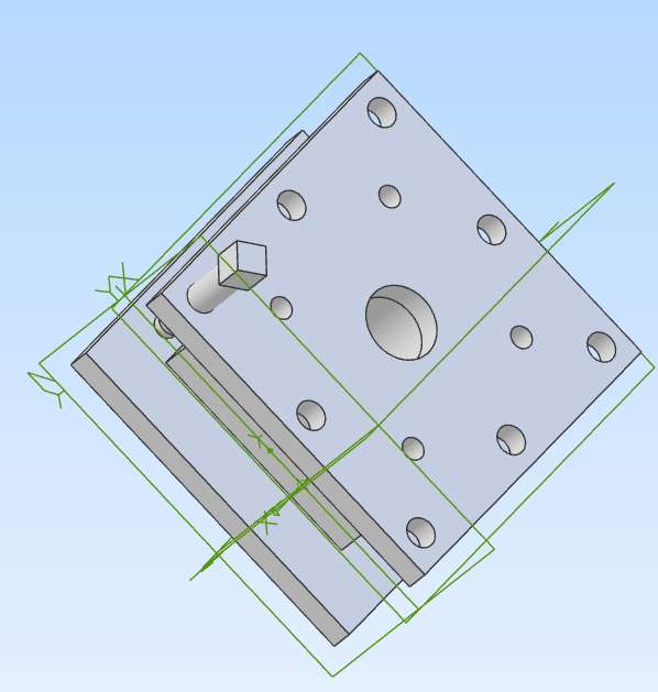

                                    As a test, I created the simple 4-way Tool-post below to see if the transparency problem would recur. It didn’t.
                                    The central block is sandwiched by two plates with countersunk or counter-bored screws, omitting the last details of the holes.
                                    I could have modelled one plate as two extrusions: outline with central spindle hole and the four assembly screw-holes as extrusion 1, edit copies of that Part to “make” the other two, then add the tool-clamp screw holes in one plate only by extrusion 2.
                                    Here I wanted to use the same principle as in the cylinder block.
                                    Try spotting the screw-holes right through the block and lower plate by editing the top as a part in place, with the central block and lower plate un-drilled.
                                    “Extrude Cut – through all” from the top plate obligingly drilled the two other components to match, and the transparency lasted only as long as I was editing the assembly.
                                    As I’d hoped.
                                    In practice the first method (editing copies) may be more efficient for something this simple, but I wanted to try the part-in-place editing.
                                    I’d only just guessed CAD should let me do things like that, otherwise adding or modifying matching features sprung from one component to another, such as bolt-holes, would entail editing each affected part or even plotting patterned features twice. As I had been doing! Very inefficient, with potentially mis-quoted dimensions. Been there too.
                                    (The old manual methods included drawing the second part on tracing film over the drawing of the first.)
                                    When I model screw-hole pairs with one tapped, as on this tool-post, sometimes I draw both to clearance size and notate the eventual drawing’s thread identity. The difference on a small thread is not really visible on the printed drawing anyway.
                                    Screenshot 2026-01-11 173454

                                      The “tray” effect occurred again a couple of days ago, and this time with a part still floating in thin air, not assmebled to another.
                                      So most likely a peculiar hiccup in the software somewhere, if not in Alibre Atom as installed on my PC then in the background graphics generator.
                                      It hampers making assemblies when I can’t see the surface I want. The Shell tool is too far along the tool-bar to select it by mistake, unlikje the New Part one which is right next to Insert Design.
                                      The effect is unusual and seems to be cured by a couple of one/off iterations, so I can probably live with it unless it really starts to happen often and becomes harder to clear.

                                        As for graphics glitches – update graphics driver if a newer one is available.  If you have the latest one already, try rolling back to a previous one to see if it is more stable.
                                        IF your graphics adapter supports it – make sure that hardware accelerated graphics scheduling is enabled in Windows.
                                        There is a ‘Customise Performance’ option in Atom3D – try turning off all the fancy graphics effects, that should give your graphics adapter an easier time.   Make sure that ‘Hide small faces’ and ‘Delay small face render’ are not enabled – these can cause faces to vanish if below the threshold.
                                        The Intel UHD 630 is not a great adapter for 3D graphics, but should manage basic stuff.  If you are hitting problems as the assembly gets more complex, it may be time to consider a dedicated graphics card, rather than an integrated one.

                                          Though not impossible, unlikely Alibre, the Graphics System or your installation is faulty.   I’ve seen similar effects in SolidEdge and Fusion360 when two parts overlap in space.  It means the model is incorrect.  Usual cause is missing or conflicting constraints.   In the real world parts can’t occupy the same space without bashing them with a big hammer.   Although CAD allows parts to overlap temporarily in virtual space, it can’t render the result properly, and of course the model is broken, causing more trouble later.
                                          Constraining such parts correctly fixes it for me.   Not always obvious what’s wrong.  Whilst missing constraints are usually easy to fix,  conflicts are harder to spot.  SolidEdge doesn’t fuss about conflicts until they go beyond what’s reasonable.   Allowed because designers sometimes use temporary constraints to position stuff during development and remove them later.   But allowing them catches out designers, especially learners, who accidentally get the model wrong.    Backtrack to find and fix.
