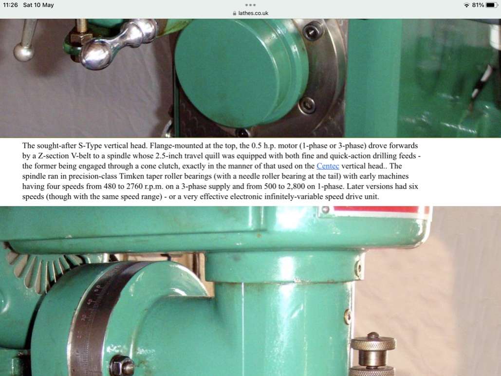

I have a tom senior e type with a single phase s type head will a member kindly tell me what the four spindle speeds are ? Many thanks David.
TOM SENIOR “S” vertical milling head spindle speeds
Motor speed = 1462 rpm
speed 4 = 2916 rpm
speed 3 =1675 rpm
speed 2 = 975 rpm
speed 1 = 501 rpm
All measured with optical tacho no load on spindle
Thank you for the replies, most helpful to me will now mark them on the machine. David.
