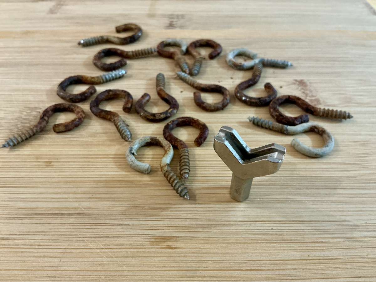

      I bought one of those Parkside multi bit sets five or six years ago and included was something I wasn’t sure I’d use until today. It made replacement of these rusty old screw eyes with new stainless steels ones a quick and easy process. 😉

        And I bet there are some folks out there who don’t know what that odd shaped bit is for?  However, it’s often the wrong size for your selected cup hooks.  Maybe they’re out there somewhere, but I’ve never seen a set of them.  But to be fair, I’ve never looked.  Guess what I’m searching for next!

          Got one of those in a set of 1/4″ hex security bits, never could figure out what it was for. Now I know, thanks Vic! Mine is only 7/8″ across the ears and the slot is 5/32″ wide so would only do smallish eyes.

                    I had one of those some years ago, no idea what it was for until a friend told me.  Useful, but the problem with it was that it was made of metal with the ductility of a decent bit of cheddar cheese.  Didn’t last long!
                    I made a replacement, a short length of 20mm bar with a 6mm slot across one end.  A 10mm AF  hexagon for the drill chuck (or tap wrench) at the other end.
