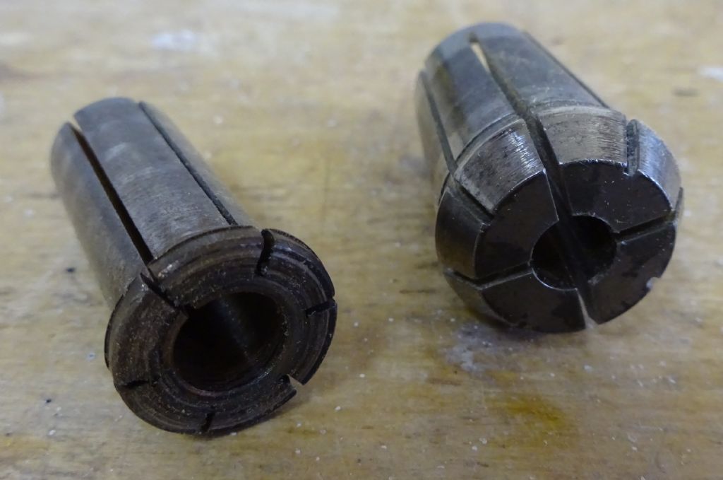

                                      Another option is a simple split bush. Below is a collet from my router on the right which is very similar to an ER type collet and on the left a 1/2" to 8mm reducer which only has one of the slots cut all the way through, just slips into a 1/2" collet. Good for 23,000rpm and quite deep cuts so should be OK for a drill bit or small item of work
                                      Edited By JasonB on 04/04/2016 12:30:46
