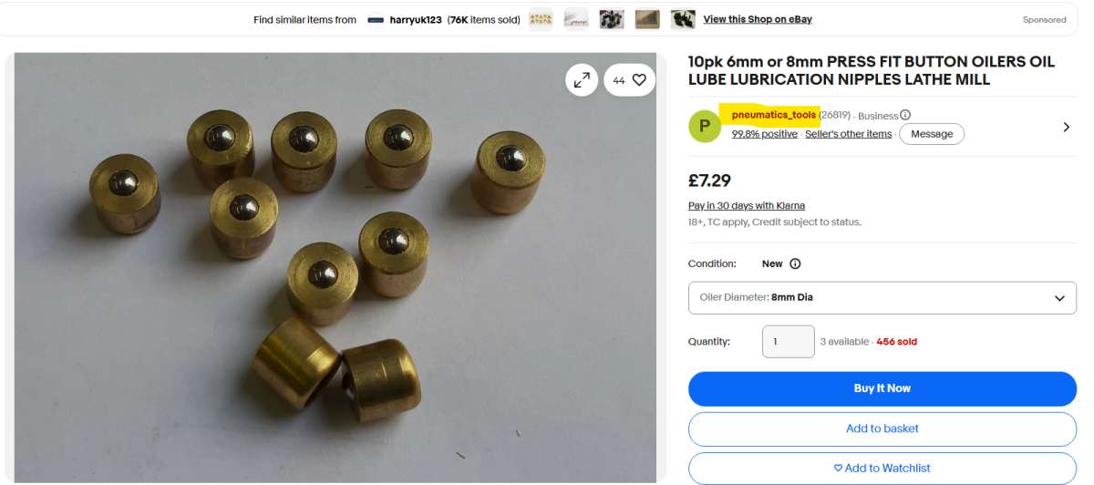

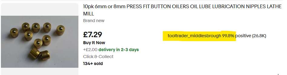

                    peak4
                      @peak4
                      On Diogenes Said:
                      I’ve bought 2 packs from Ebay, a different seller – ‘tooltrader_middlesbrough’ (- looks like an identical item at an identical price) – they seat better than the ones that were fitted to my ‘green’ lathe as supplied.
                      I bought two packs expecting to carry out some personal QA on arrival but in the event all the pieces in the packs I bought were ‘good’ / useable.
                      That Middlesborough trader, is the same one I linked to; the name changes when you open the item from the eBay search list, they appear to be in stock in both 6 & 8mm, along with various others
                      Shop Here- https://www.ebay.co.uk/str/pneumaticstools
                      From search list;
                      image_2026-05-31_214940319
                      links to here https://www.ebay.co.uk/itm/283556428487
                      image_2026-05-31_215130313

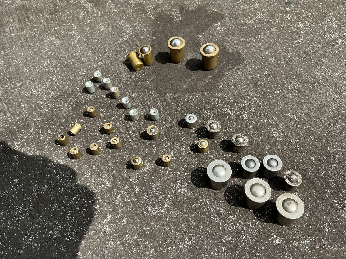

                            Out of interest these were in the workshop, the ones on the right have no balls but a pressed half sphere instead, the ones top left are door/cabinet closers with no hole but could be drilled(springs quite strong) and the rest are bog std ones.IMG_4117
