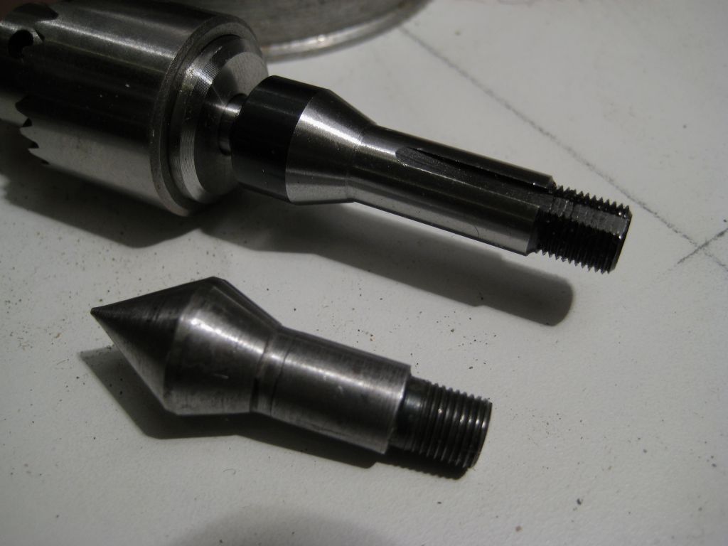

      Hello Everyone,
      This is my first post so aplogies if it's in the wrong section.
      I have recently bought a tiny lathe which looks to be homemade, but fairly well.
      The lathe came with a dead centre but no drilling attachment in the tailstock, it takes 8mm collets. so, I bought an 8mm arbor with JTO taper and a small chuck, but the arbor will not screw in my drawbar,
      The arbor has a M7 thread, my dead centre thread is 4/16, even the top taper appears to be wider. I did ask the seller whether it would fit my lathe, but there you go.
      I would really appreciate the help, finding out what arbor I actually need has been near impossibe as none of the collets decribed online seems to have a 4/16 thread,
      By the way, the lathe looks to be made in the 1950s in the UK, with backgears and screwcutting ability.
      Thank you in advance.

              Victor,
              The threads on the ends of 8mm collets are many and variable. Have a look at pages 3.5 &3.6 in Tubal Cain's Model Engineers Handbook or do an online search for data on 8mm collets.
              I can find no reference to any screw thread designated 4/16.
              I suggest you find out what 8mm collets are most commonly available and make a new draw bar to suit. I do not think you will have any luck finding collets to suit your non standard draw bar.
              Eric

                Victor It sounds as if it could be a watchmakers lathe 8mm collets usually have a 0.268 inch diameter x 40 tip or sometimes 0,625mm pitch You may pick some up if you have a clock fair near you anytime Cowells have supplied me with dawbars in the past A photo would help or more information ie doe's it have a compound slide or a hand turning rest
                Best of luck
                Roy

                  I think by 4/16, he actually means 1/4", Made in the UK, in the 1950s, it's probably either BSF, or Whitworth, so either 26 tpi, or 20 tpi, I would say it would be unlikely to be 0 BA, but then again it might be. Ian S C

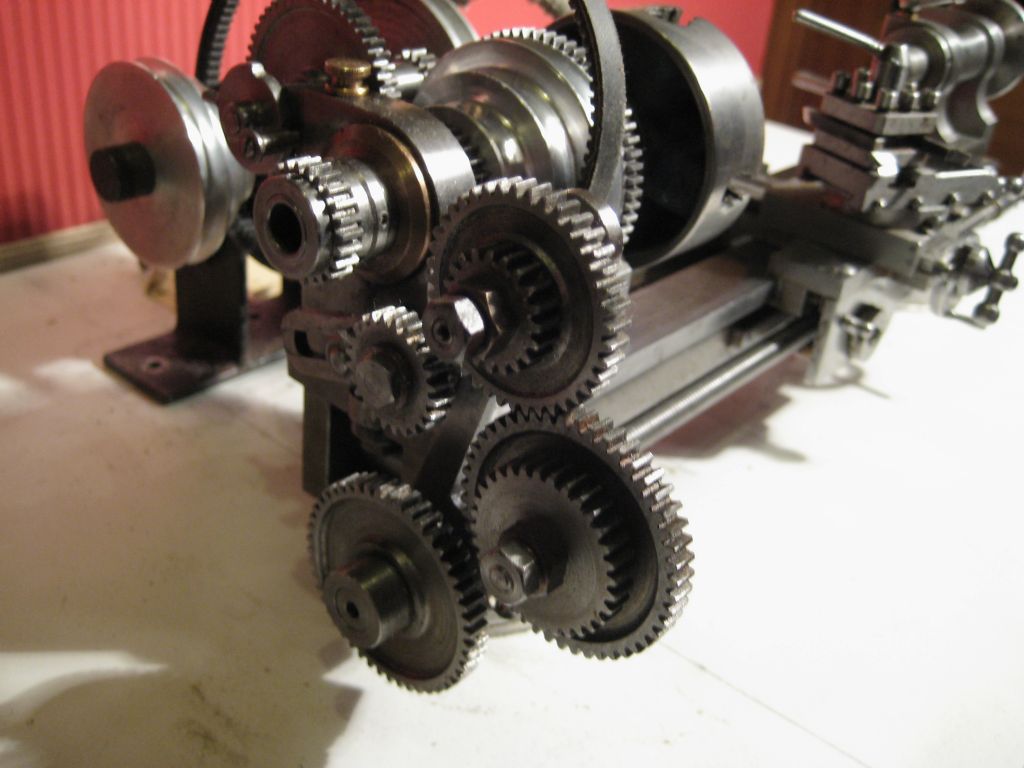

                    Thank you to all for the suggestions, and for you welcome. My apologies for the newby questions, I am an artist and have worked with metal all my life but I beat it into shape, rather than use machines.
                    I have taken some photos of the lathe, but it seems to be a homemade job so this is the main problem!
                    Nevertheless, it is a beautiful little machine, I honestly feel it is worth the effort, even just out of respect for the chap who put so much work into making it. It was in an awful state when it came to me having being neglected by its new owner for many years.
                    The headstock spindle is threaded but can also take collets, bearings are phosphor bronze conicals, The machine itself is made from fabricated steel..
                    The reason for buying something so small is lack of space, The bed measures 12.5".
                    The width of the top of the collet is also different than what RDG sales a standard, Mine is wider and appears to be different .
                    Yes, I am pretty sure the theaded part on my dead centre is 4/16, the RDG is M7, just spoke to someone from RDG who tells me they only stock that thread for 8mm lathes.
                    I did think that making a new drawbar would be the solution,problem is that the RDG arbor's top is slimmer than mine so it has a fair bit of play.
                    By the way, I was told that the lathe is able to screw cut, but it has no reverse so again I am a bit lost.

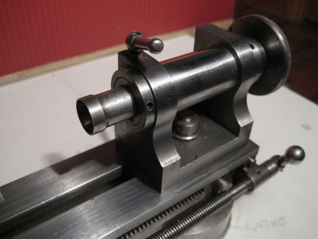

                          That's a nice looking little lathe, Victor
                          Do you have any collets or other fittings apart from that rather unusual-looking centre?
                          If yes … please measure them as carefully as you can, and let us know.
                          If no … put the centre in a box and forget about it … then start buying collets [all the same type if at all possible] from ebay, or wherever.
                          When you are comfortable using the lathe; modify the taper if you need to, and make a new drawbar to suit what you have bought.
                          It looks well-worth the effort !!

                            Yes, I also think that it's worth the effort. Just need a suitable arbor for the tailstock and it will do for the wee jobs I have in mind.
                            Buying collets from the bay and making a new drawbar is probably the only solution. Thing is that the headstock spindle also accepts the same collets as the tailstock, so I really wanted to try finding out exactly what type of collets I need before modifyng the tailstock.
                            The top of the RDG collet measures 12mm, my dead centre 4/8. The RDG arbor feels as it may have too much play, even if I made a drawbar for it. Bummer, I waited three months for the arbor and chuck to become available on ebayuk.

                              Posted by Victor francis on 01/11/2013 18:51:46:
                              Victor,
                              I don't think there is any need to worry about the major diameter … it's the angle of the cone that really matters.
                              But, could you please measure the shank diameter of both the arbor and the dead centre.
                              Something close to 8mm would be useful.

                                The diameters of the dead centre's shank  and the RDG arbor are both exactly 8mm. The angle of the cone is  greater as it is the same length as the RDG's but wider on top. This is why it will not sit tightly in my headstock collet holder.

                                  Posted by Victor francis on 01/11/2013 20:19:32:
                                  Hello Michael.
                                  Kind regards,
                                  Victor.
                                  Edited By Victor francis on 01/11/2013 20:21:58
                                  My apologies, Victor; I mis-understood
                                  If it's the Angle that differs, then you will almost certainly need to re-machine to fit commonly available collets.
                                  Almost all have 40° angle; but you might find this table interesting, as it includes a few oddities.

                                    Hello Victor, It would be nice to know where you live ? However it is indeed a nice looking lathe and obviously made by someone with considerable skill.
                                    Personally I would guard against altering the spindle, it may be hardened, have you tested for this? I would only consider alteration as a last resort. Its most likely that the maker will have used a standard taper and thread -might now be obsolete but check first.
                                    First I would ascertain the specification of the taper and thread on your centre which I assume is an original part? To do this access to either a shadow graph or toolmakers microscope would be helpful — maybe a local engineering shop would help you with this.
                                    The 4/16 thread is of course a 1/4" [0.250"] as Ian has already pointed out, do you have a thread pitch gauge or can you compare it to other threaded items you have of known pitch — taps, screws etc the diameter of which does not matter, you are only interested in the pitch of the thread. If you can get access to to microscope or shadow graph then you will be able to check the thread angle as well.
                                    Another possibility is a USB digital microscope, I have no experience with these units but I'm sure other members have and will advise.
                                    Screwcutting – another subject but but you don't need reverse to cut threads but you would need a complete set of change gears. There does not appear to be a chasing dial but one could be fitted. More information on the machine will be needed to advise on this subject.

                                        I reside in London UK. Yes, the headstock spindle is hardened, the tailstock spindle appears to be softer.
                                        Most of my tools consist of hammers,will have to get a thread gauge and a good quality caliper. I sometimes do work for a studio that employes a skilled engineer,will have to get him to check the thread and exact angle of the cone. I assume that the chap who initially made the lathe used a a ready made headstock spindle and bearings and tailstock collet holder. However, I am not sure, he may have made every single part himself.
                                        By the way, there is no keyway in the dead centre.
                                        You are right, there is no thread indicator and the only gears I have are those you see in the photograph. There are also no calibration marks on any of the parts,except on the crosslide where some engraved lines are present.
                                        I have tried chucking the dead centre in and copying its angle , with a bit of practice I should be able to eventually get the taper right.

                                            I think your lathe was built by a machinist using his work lathe and 'spare' material from work hence the big round feet and many design aspects copied from larger lathes that a pure amateur would have not bothered with in needing to get a working lathe as easily as possible.
                                            You may have enough gears to turn at least the common threads. There are free computer programs that calculate the setup for whatever gears you happen to have. On this aspect in case you want extra gears you need to know the 'diametrical pitch' of the gears. That is the number of teeth on a gear divided by the diameter in inches – expect a roughly round figure like 18 or 20.
                                            There are so many Model engineering clubs in London you can probably find one in walking distance. You wouldn't have to join to go along to a meeting and get some one to one discussion about any problems we can't sort out here.
