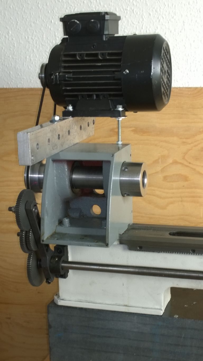

                          How do You rate the WM180?
                          I am asking as I am trying to improve one with a much bigger spindle and VFD.
                          Am I wasting my very precious last years on a painted tart?wm 180 ER40nose

                                Sounds interesting as my goal is to make the best performing lathe within the space cube of a WM180.
                                The changes are:
                                Solid base of Dolerite
                                Much stiffer spindle with less overhang
                                Stiffen up the headstock ,bed connection .Either Epoxycrete the bed or put a hefty brace of steel steel between Dolerite and headstock.
                                Your gearchange annoying will be avoided by having an electronic leadscrew .
                                The cross slide lack of stud holes are more difficult to remedy.
                                If and when I have it running,it will be tested like this:
                                Cutting M16 Unbrako 12.9 bolt
                                Do You know if there is a forum for WM180 lathes and will You be interested to try finding the limits of Your present WM180?
                                I can send some screws?I have a quarter bucket.

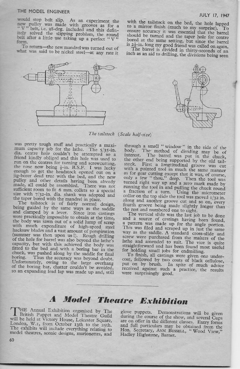

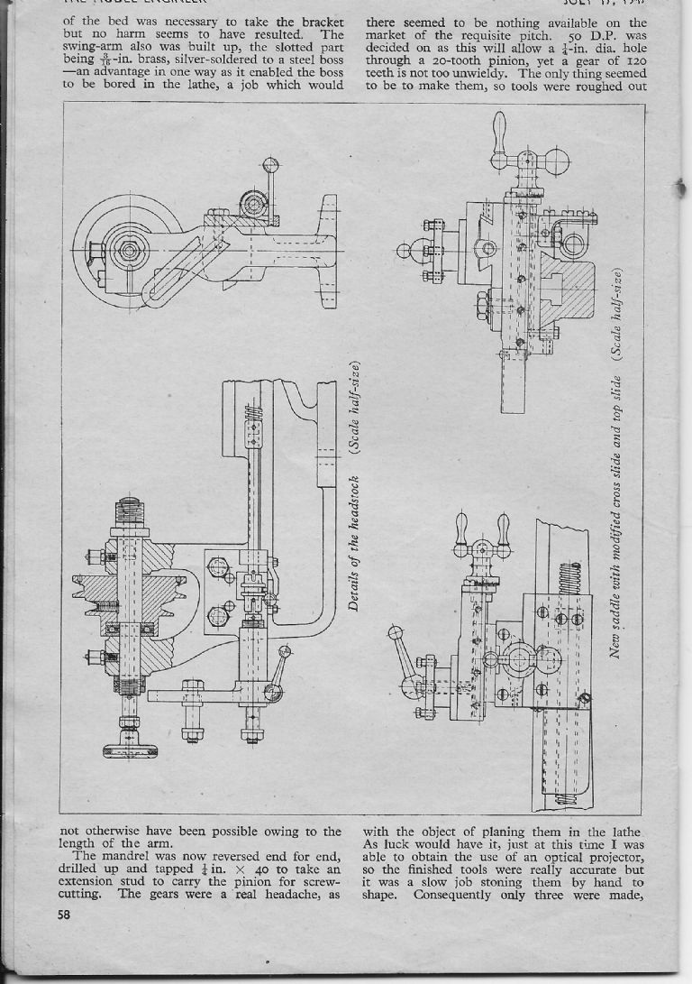

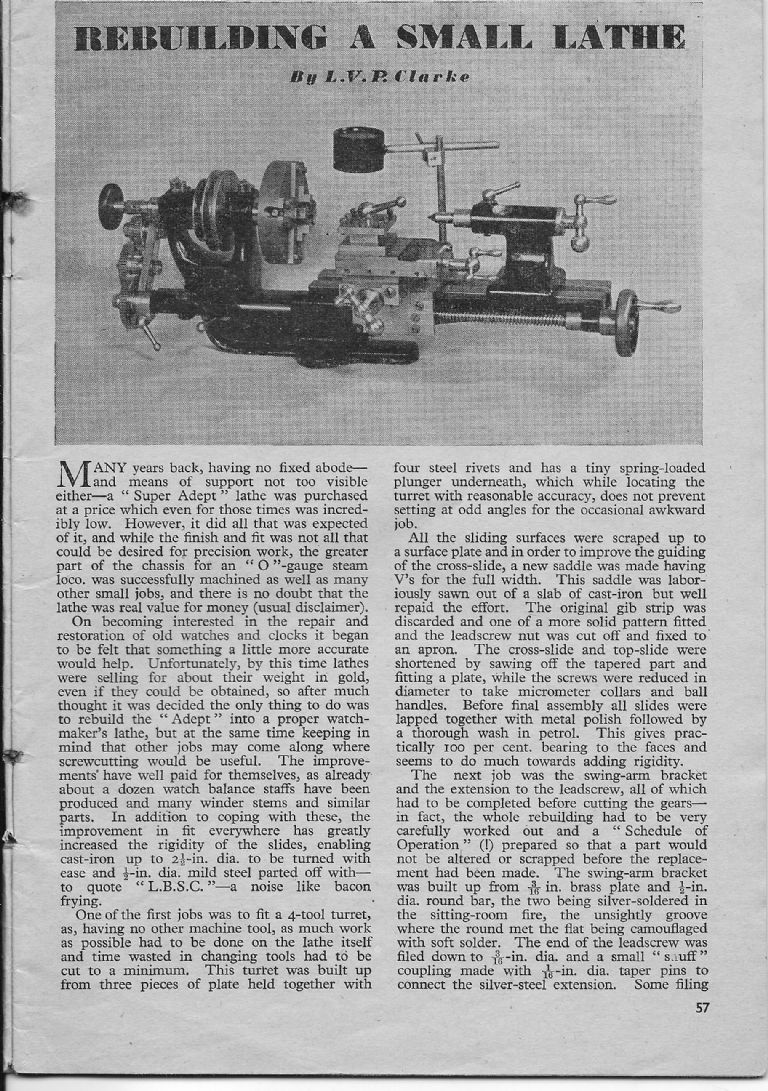

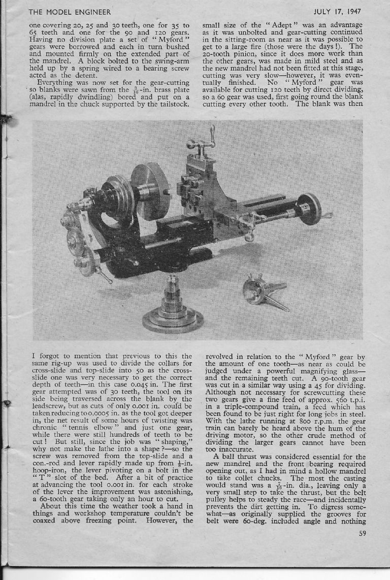

                                            Adept lathes are very old fashioned and very basic, especially if it's the fixed-slide Adept rather than the Super Adept.
                                            If you have one with little wear and well set up, it will happily work metal within its capacity but it will always be harder work than using a more modern machine.
                                            My own adept, much modified and still waiting for me to finish the tumbler reverse, add a screwcutting clutch and put it on a base board…
