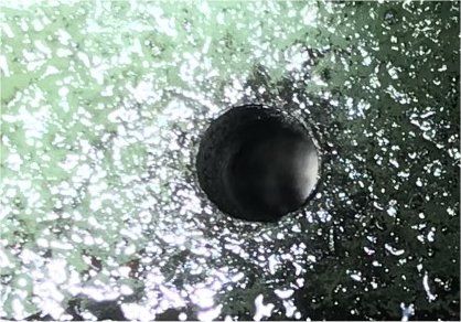

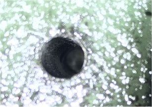

      I've recently bought a Warco WM18 and am still in the process of checking things over.
      I've met with a bit of a puzzle in the Y axis locking screws. Basically the locking screw nearer the front of the table bottoms out (i.e. goes all the way in) but even then doesn't actually lock the table. I've put a longer M6 screw in just to test how far down you need to go to reach a stop, and it is the full length of the supplied screw plus about 5mm. The female threads in the hole in question are in good condition.
      I feel sure there is a simple explanation for this, but it eludes me at the moment. Any help would be much appreciated.
      ETA: I should mention that even when a longer screw is inserted and it reaches a stop it doesn't very effectively lock the table.

          If they are like some of the sieg machines then there is a small round slug that goes into the hole before the screw you may be missing it in that hole, what do the parts drawings show?

            If the locking screw pushes on the gib strip there ought to be an intermediate "pusher" rod with one end angled to match the gib strip and the other flat for the screw to push on. Around 10 – 12 mm overall length sounds about right as the length of such devices usually seem to be about twice the screw diameter.
            Easy to make one if need be.

              They usually have a tiny brass cylinder down the hole. Remove both screws and check the depth of the holes, you will then know how long the cylinder should be that just goes down the hole.

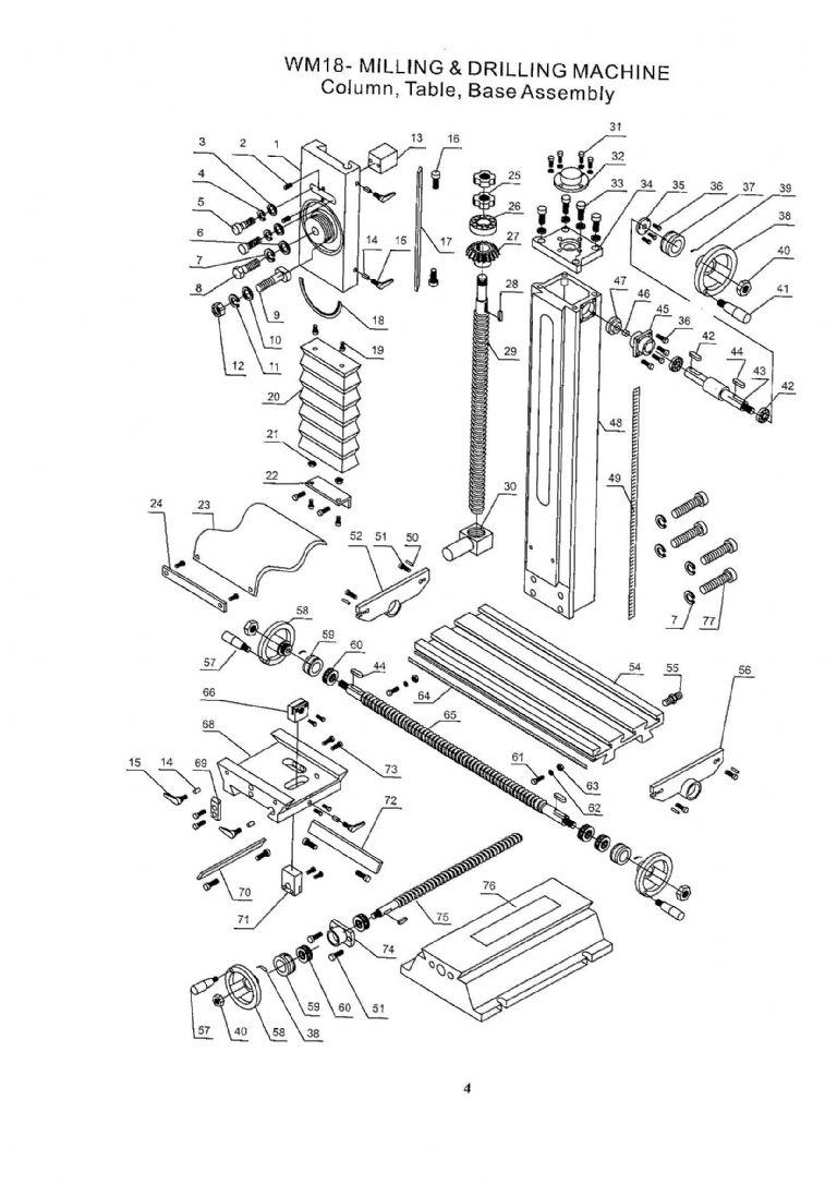

                I've attached a scan of the relevant page. Slightly unhelpfully, it appears to depict an older version of the WM18 but I think it does show the presence of a brass pin; at least that is what part no. 14 is described as so I'm assuming the y axis is the same.
                Is it possible the brass pin is in there but has dislodged from its correct position? If so, how would I go about getting it back into position and having an operable slidelock?

                  14 it is, you could make one out of a brass woodscrew in five minutes with a hacksaw and a file.

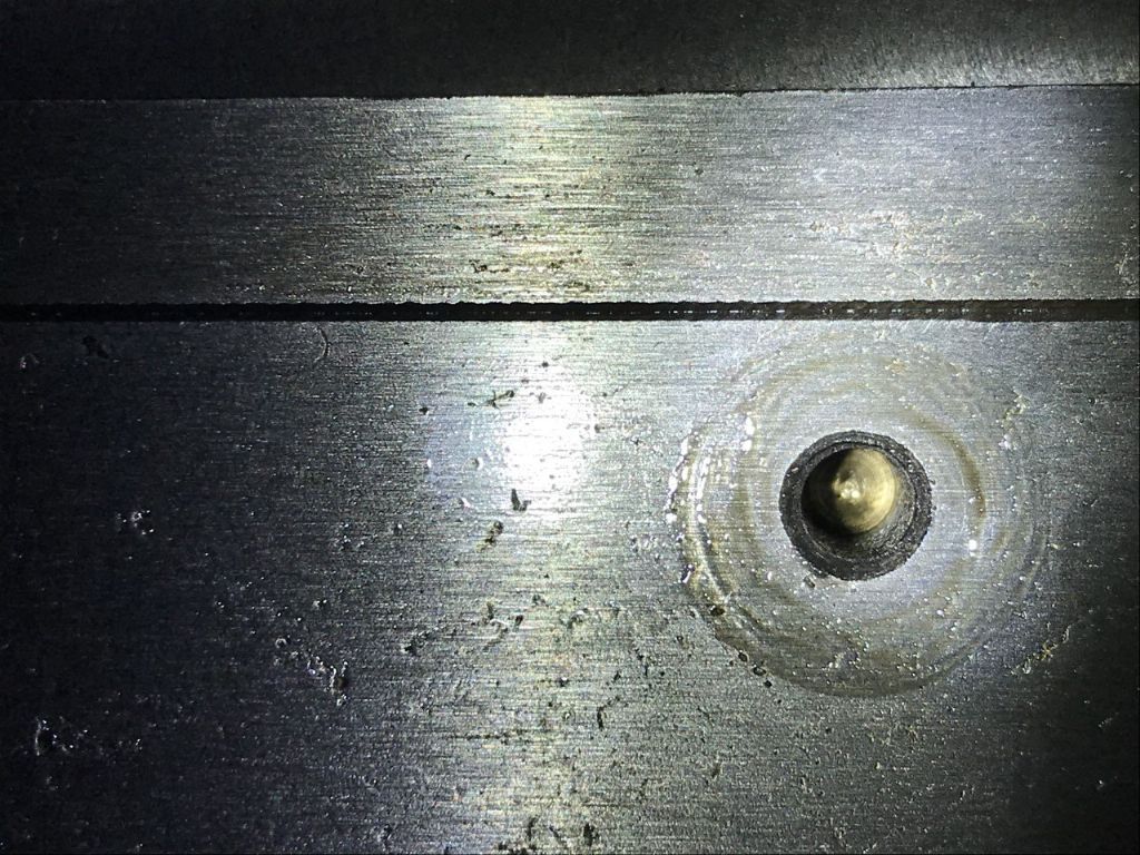

                      I've uploaded one photo of one of the x axis holes with the screw removed clearly showing the brass pin, and two photos of the y axis hole not apparently showing a brass pin. I couldn't swear to not being able to see it, mind you; my eyes are not that good down holes.
                      Obviously making a brass pin is not going to be any problem. An ongoing concern though is whether there is a brass pin in there somewhere but it has got dislodged sideways somehow only to jam up the y axis at some critical moment. Is this possible, or is there nowhere a brass pin could be hiding other than down that hole?

                          There does after all appear to be a brass pin in there, only it's very deep in the hole, so deep that it has apparently fallen into a recess in the gib strip. Not sure how to proceed.

                                  A short while ago I managed to persuade a much younger pair of eyes than mine to peer down the hole – the conclusion: I'm imagining the presence of anything brassy down that hole. Since, also, a long thin drill bit inserted into the hole appears to reach all the way to the near side of the gib, it's difficult to imagine where any brass pusher that may have been in there could have disappeared to, unless the pusher was for some reason ludicrously short.
                                  I'm going to try and get hold of the appropriate pusher from the retailer (sorry, Mark, I did buy new) and hopefully just get on with using the machine.

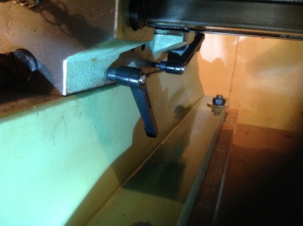

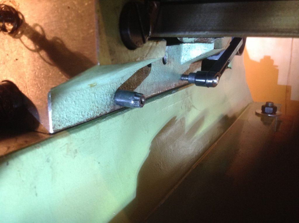

                                              This is similar to an experience I had when working on my WM14 mill, much smaller than the WM18 but from the same family. A quote from my website
                                              "When adjusting the gibs and clamping screws I had an interesting problem trying to get one of the brass pads in place behind the clamp screw. Every time I pushed the pad into the hole as it approached the gib strip it would tumble through 90° and disappear. Investigation revealed that the tapped hole for the adjustable gib screw had been drilled way too deep and had intersected the bottom of the clamp screw hole. After a bit of head scratching I overcame this by blanking off the gib adjuster screw hole with a short grub screw screwed in tight and then re-drilling and tapping the clamp screw hole."
                                              Don't know if this helps with your particular problem but may throw a little light.
