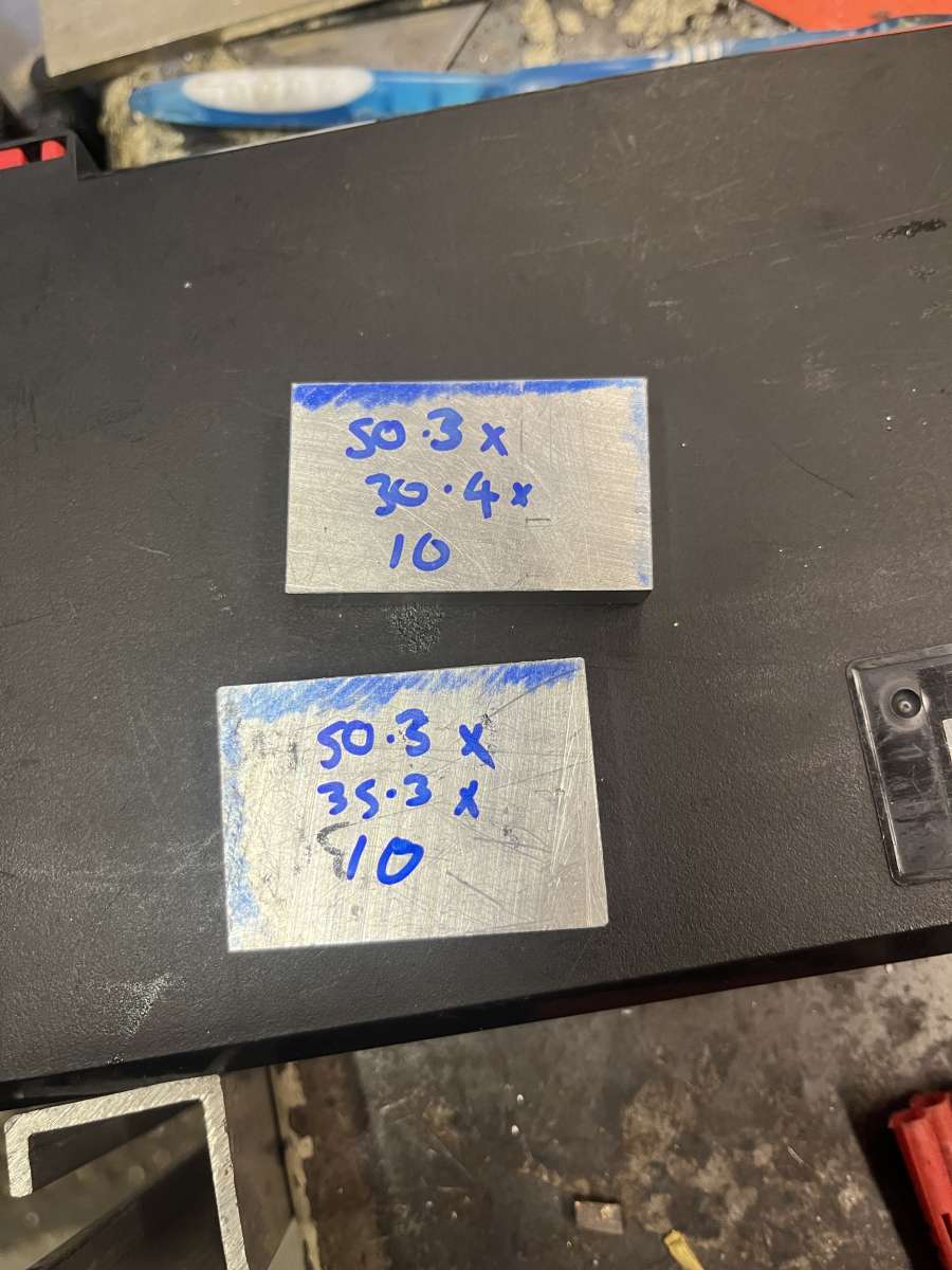

      Wondering how people using CNCs go about the initial stock problem?
      I have a part that’s pretty much 49x9x29mm (is not quite that simple, but for the sake of this it can be).
      So I’ve done the CAD and the CAM and in the setup I make the initial block 50x10x30mm
      All good, let’s go cut some metal…
      I hacksaw out a piece to use, whack it in the big mill to square it up and make it to size. On measuring it ends up at 50.3×30.4×10
      IMG_8153
      Do you:
      A) go back and change the CAM,
      B) machine the block a bit more, or
      C) just ignore it?
      Im leaning towards A as C feels risky – the initial cut is bigger than expected, and B could end up with undersized block. That’s less risky I think from the cut point of view, but more if the part now doesn’t fit.

          Just make the blank a tad bigger in the CAD model. You’ll cut some air, but that’s better than breaking taps.

                I usually make the blank a bit larger in setup, eg allow 2mm all round when I actually intend to use a piece that is approx 1mm bigger all round. This not only allows for the piece being a bit bigger but also less need to set it up spot on which can result in the first pass being deeper than you intended.
                Alternative is to just go back and enter the actual (relative) stock size and regenerate the paths.

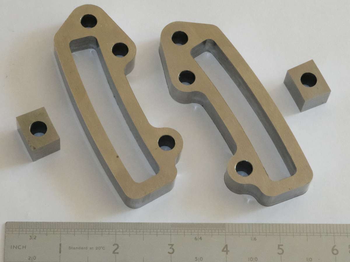

                    Not sure I have understood the issue, but I always use features on the part for aligning the CAM toolpaths rather than the stock? When generating CAM I add stock that replicates the overall dimensions of the part. The stock is only there to visualise the correct material removal and check tolerances.
                    There are two basic starting points. When the part itself is rectangular I mostly start with stock that is the correct size. I expect that general squaring up of stock on the manual mill will be within a thou or so of design size. For a part that has a non-rectangular profile I start with a rectangle that is a millimetre or two larger than the extremes of the part. On these of parts I pick up on a feature on the part such as a hole. The first operation will be profiling with multiple steps inwards so just add an extra step to the width of cut if needed. One will cut air for a period but for low part quantities it is not worthwhile spending hours fine tuning the CAM. Plus, when the CNC mill is running I can go and do something else.

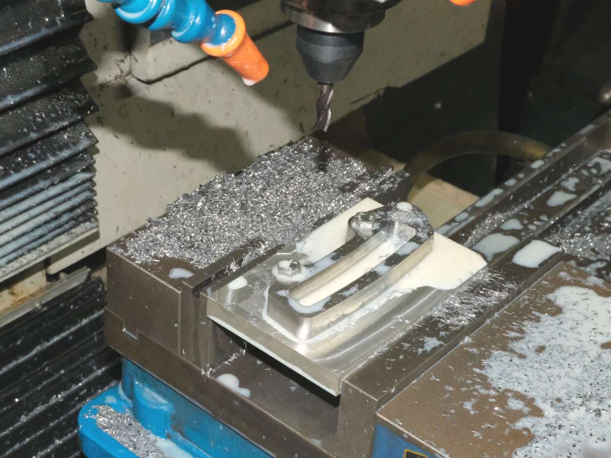

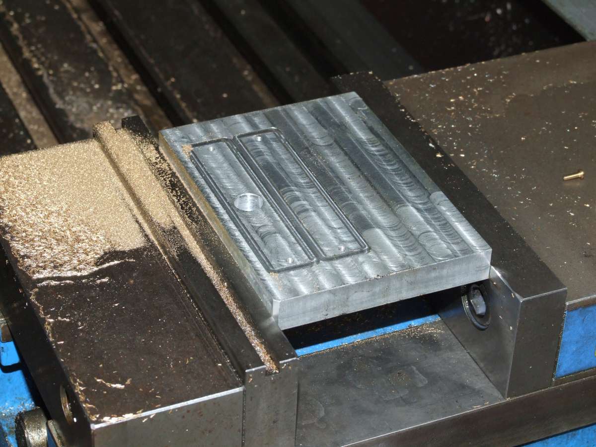

                    As an example these parts started as a rectangular blocks of hot rolled steel to within a thou of final size:
                    006
                    The position of the two holes in the lugs are the only critical dimension; all three holes were drilled in the blanks on the manual mill before CNC machining. The reference point on the part for each operation was the north west point and top surface. This was set with reference to the fixed vice jaw and ‘zero’ height set from the work with tool 0 so that the tool height table entries were correct.
                    For these expansion links the positioning of the three holes are critical and they were drilled/reamed on the manual mill using the DRO. The outline is anything but rectangular so I used the middle hole as the zero reference:
                    Embryo Expansion Links
                    The expansion links were mounted on a fixture with accurately drilled holes for bolts. Before CNC machining the oversize blank was mounted using bolts in the two outer holes and a co-axial indicator used to set zero to the middle hole. Then the third bolt was installed and CNC machining commenced:
                    Expansion Link - CNC
                    Profile first followed by roughing out and finishing the curve slot. The slot was left a thou undersize to allow for hand fitting of the die block.

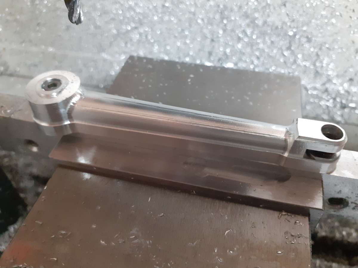

                      I don’t think there is any one right way that suits all, each individual part needs the approach that best suits it.
                      I’ve done parts that have no easily located feature so will allow the stock to be oversize and use it’s flat bottom as my height reference and the ctr of the stock for X&Y that way I know I will not have an uncut area on one edge and can set my tool heights when chaging tools.

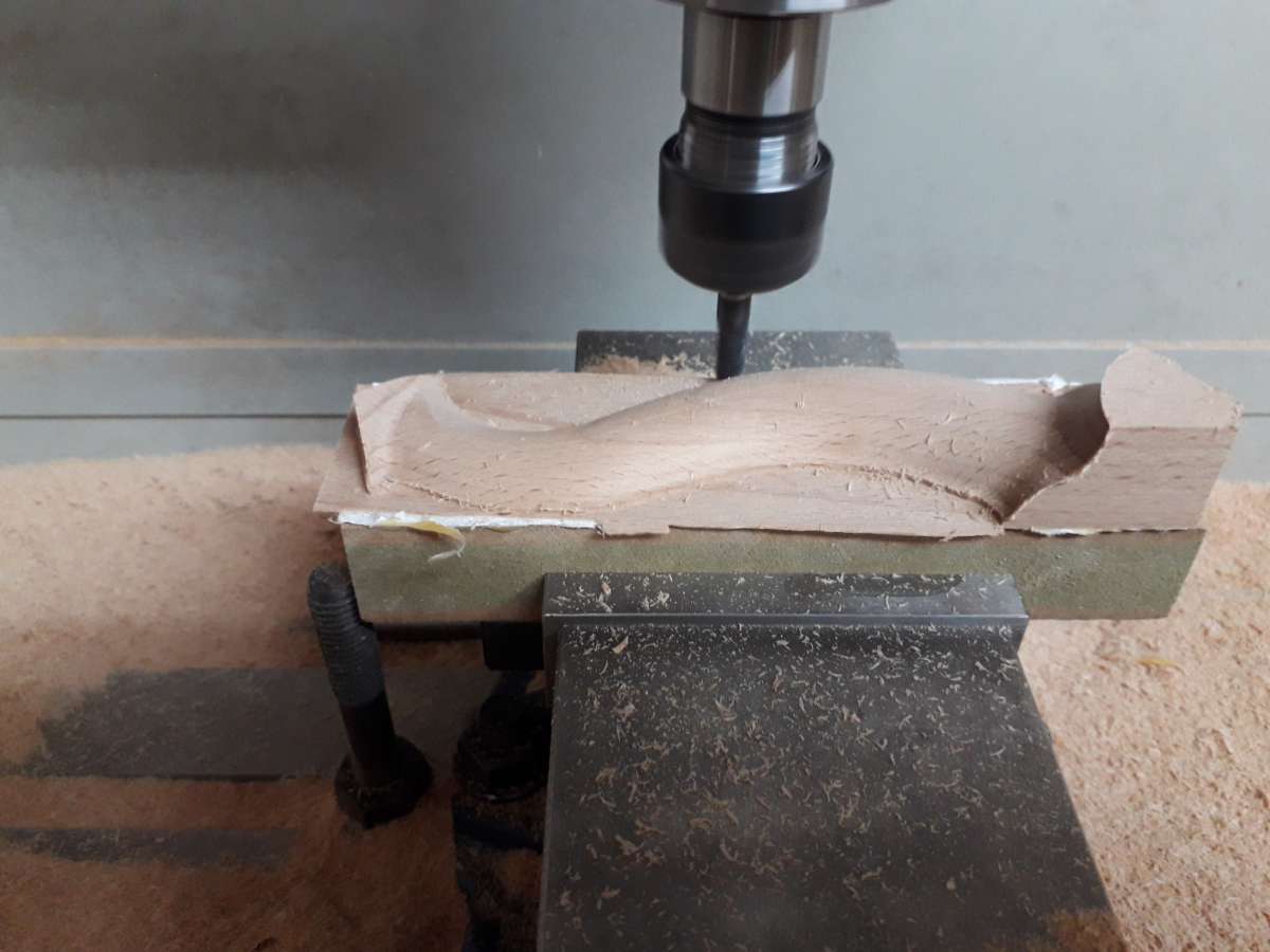

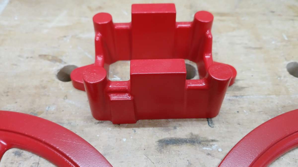

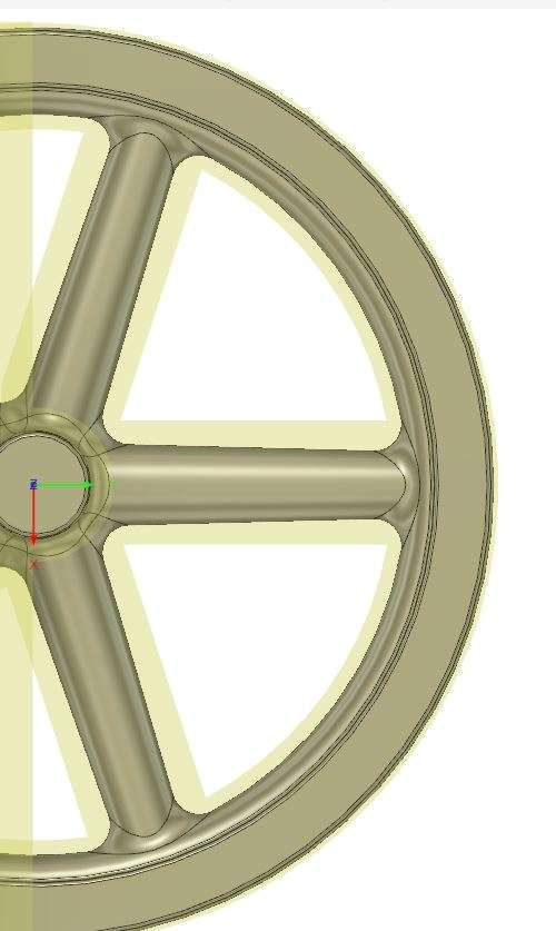

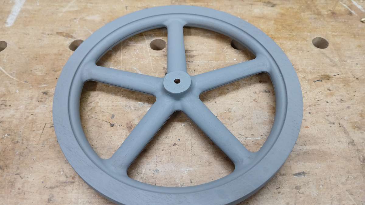

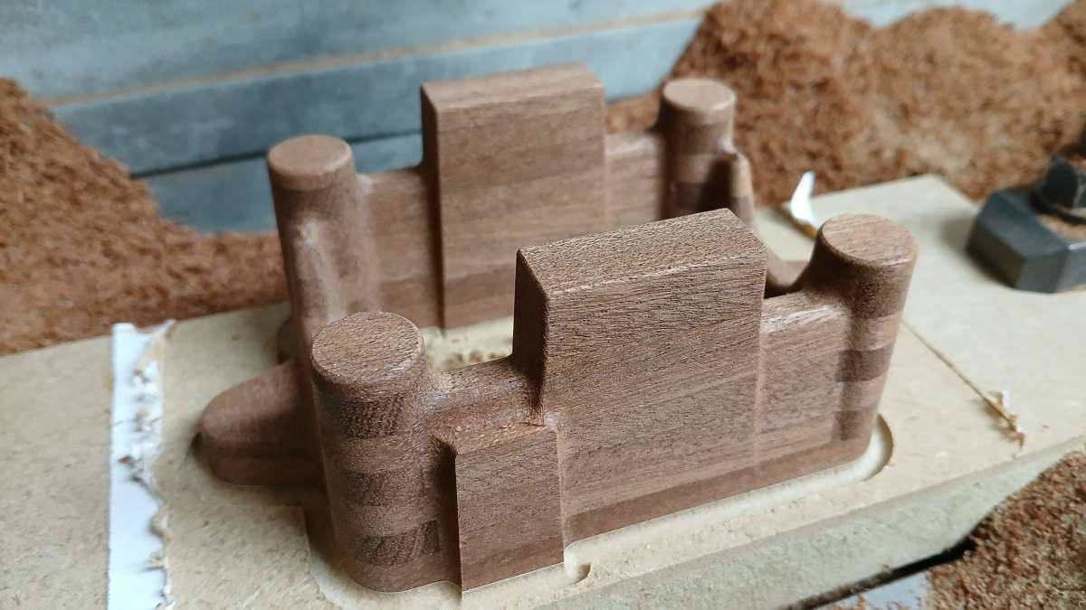

                      Others I’ll use a body as the stock to more accurately represent what I’m starting with then the CNC won’t waste time cutting what is not there. This flywheel pattern for example was jig sawn to the pale transparennt yellow “stock” shape before going onto the CNC. Ctr of the flywheel used as datum and half cut at a time as I could not get it all in the Y axis
                      flywheel stock
                      20251110_091523

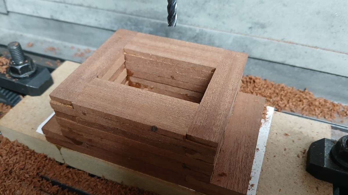

                      Another similar job the pattern was glued up from strips into a hollow box so my stock body had that same hole and foot material, sized as measured from the glue up. No need to use the CNC to cut out with a profile and leave a potentially loose piece of material to catch the cutter. Bottom of the MDF and ctr of the glued up blank used as datum.
                      20251021_090628
                      20251021_120819
                      20251110_091458

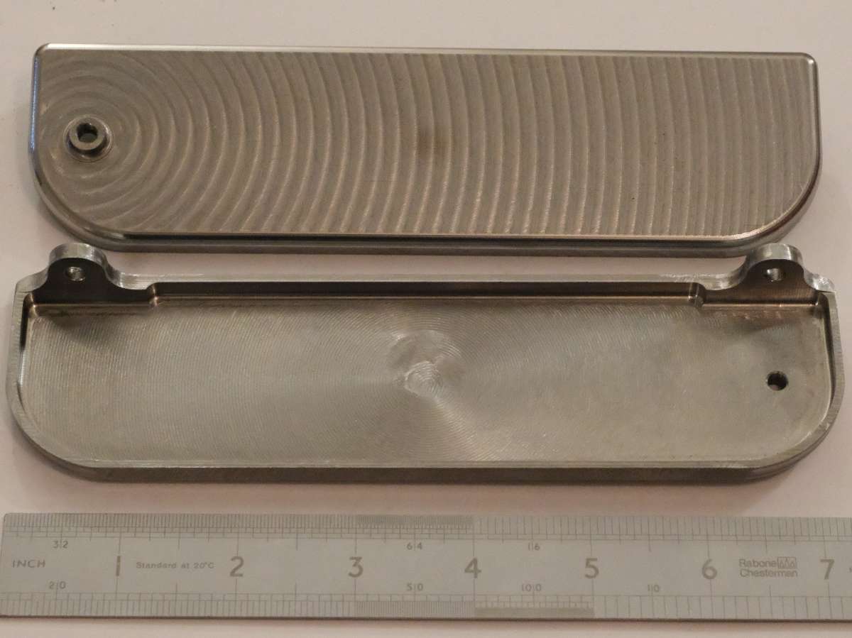

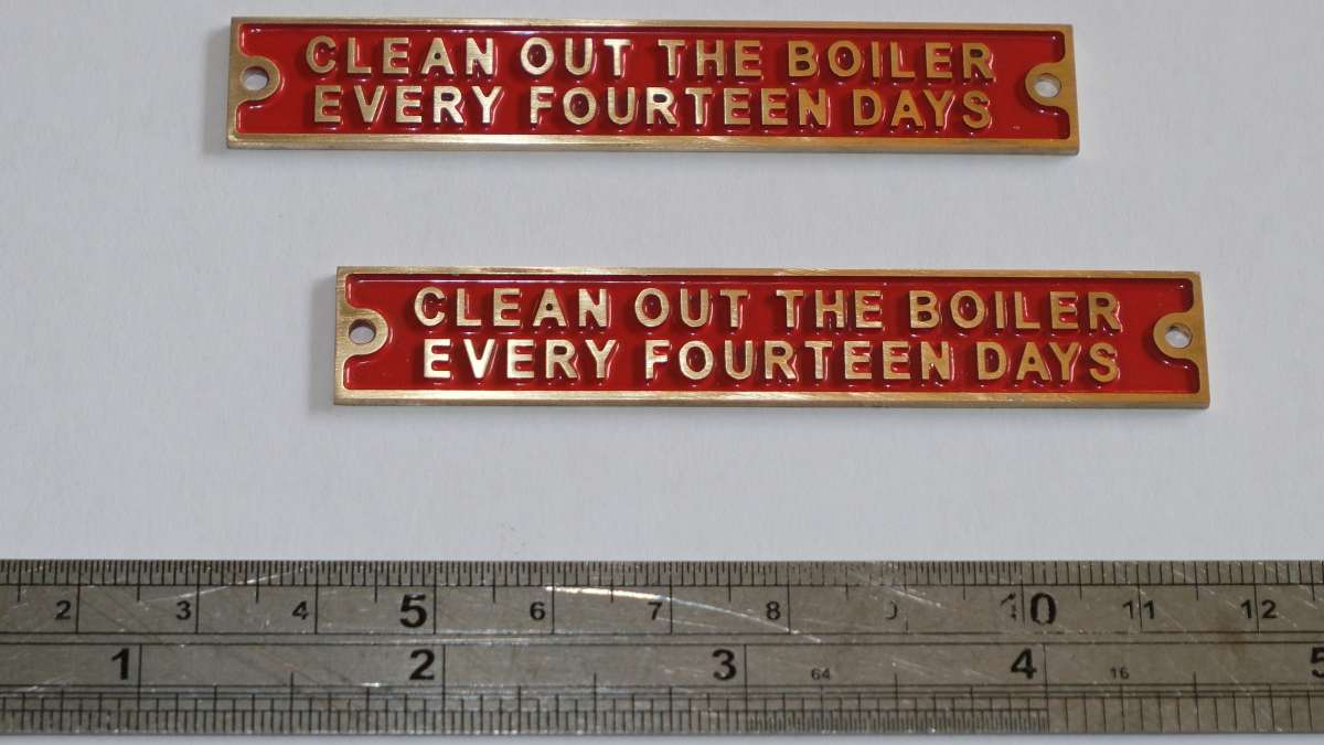

                                Using the centre of a part for reference can be useful where mirror symmetry exists and/or when there is no point to pick up on the blank.
                                For these two name plates I wanted to CNC mill the outline, and pocket out the lettering, with seperate programs, and make two parts without moving the blank material:
                                Washout_Plates
                                Here is the fixture used:
                                2023_05060010
                                There are two sets of 8BA holes, spaced 25mm apart in Y, for fixing the work down and one central hole to set X/Y zero. The Z zero is the fixture top surface. After picking up the zero positions a blank sheet of engraving brass was attached to the fixture with 8BA screws. The first outline was machined with a 3mm cutter, then the Y reference moved 25mm and the program run again. Then change to a 0.5mm cutter, move back 25mm and run the second program. Finally move the Y reference 25mm again and repeat.
                                Like Jason I rarely mark out for general machining, just use micrometers and the DRO. The only time I regularly mark out is when doing sheet metalwork.
