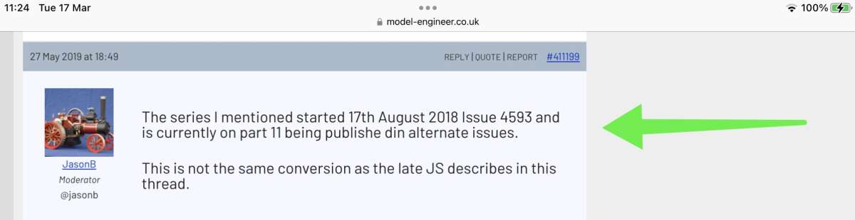

      Hello,
      I’m looking for the ME or MEW series starting 17 Aug 2018 for the Sieg SX2PG milling machine cnc conversion. If anyone has a copy/copies, I would be grateful to hear from them.
      Thanks,
      Mark

        Hi Mark, If it’s in ME then I may be able to help. Give me lssue numbers Etc.  Noel.
        #841149
          This thread may be of use https://www.model-engineer.co.uk/forums/topic/cncing-a-sx2p-mill/
          A digital subscription will get you what you want.

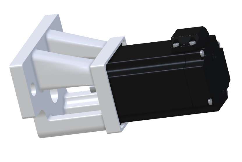

                      Russell,
                      Yes, that’s another angle of attack, but I was trying to get away from the use of toothed belts andpullies because of the implied backlash involved.  I would prefer to drive the ball screws directly from the stepper motor.  I have designed a mount for the X-axis, which I have printed out in ABS-GF filament, and this is a screenshot from Alibre Atom:
                      X-axis mount and stepper
                      If I use it, I would investigate having it 3D printed in Aluminium, having been impressed with the quality of the results displayed in the thread on this subject.
                      Perhaps I should add that I’ve also considered throwing even more money at it and ordering a Makera Carvera cnc mill, and just keep the XJ-12 for “everyday” jobs! It’s only money, you can’t take it with you, and I have a willing beneficiary to leave it to.

                                    Thanks for all the information. Noel I’m trying to get the issue number. If so, I’ll post it on the forum here. Thanks, Mark
                                    #841380
                                      Issue No is in the link I posted in my first reply, 11 parts in alternate mags.
                                      #841428
                                        For convenient reference:
                                        IMG_1488
