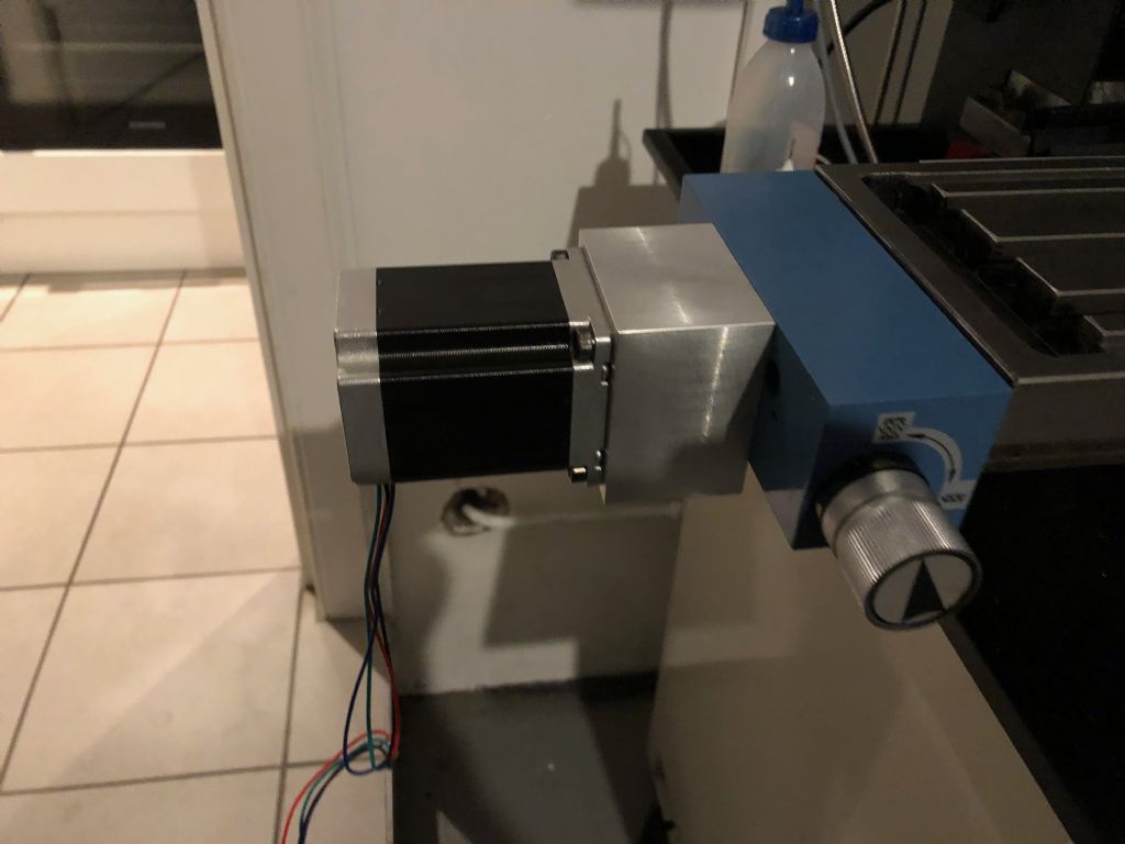

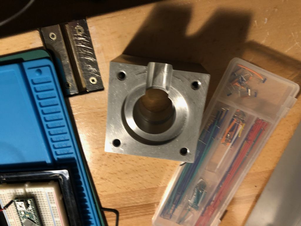

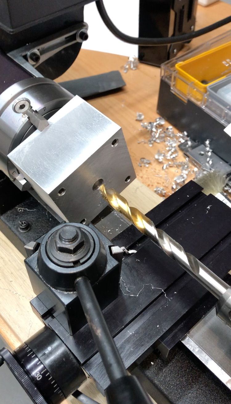

          This is the mounted clutch, stepper & motor mount
          Stepper Mounted on Clutch
          Motor Mount

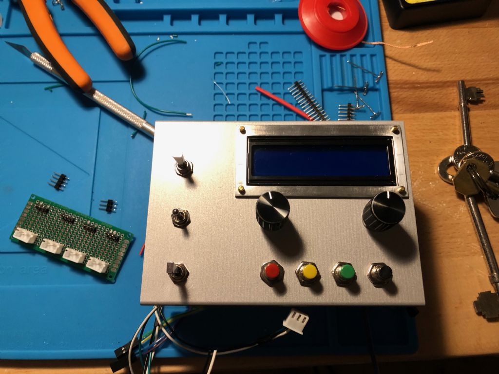

          This is the control box design I came up with:
          – momentary toggle for z-axis
          – momentary toggle for x-axis
          – static directional toggle
          – 2x rotary encoders for various input
          – 4x buttons to control various functions
          – 16×2 LCD

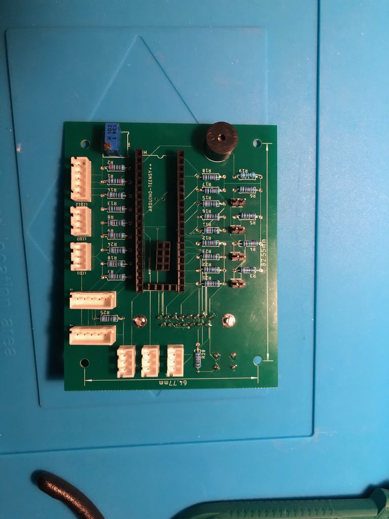

          1. The main control board houses a Teensy 2.0++ board which is an Arduino compatible board but with a large number of IO pins.
          2. DB15 interface for main logic to stepper driver enclosure

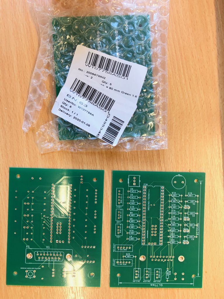

          This is a close up of the control board I designed.
          Boards from fab
          Completed Control Board

          #446371
            Ben, did you make the clutch unit or is that a sieg item as it looks very much like the factory one?
            Also what sort od slow feed can you get as the standard one can be a bit fast for heavy cuts?
            Edited By JasonB on 13/01/2020 15:28:43
            #446372
            Benjmain Poweski
              @benjmainpoweski98989
              It's the factory one. The price was quite reasonable so opted to purchase.
