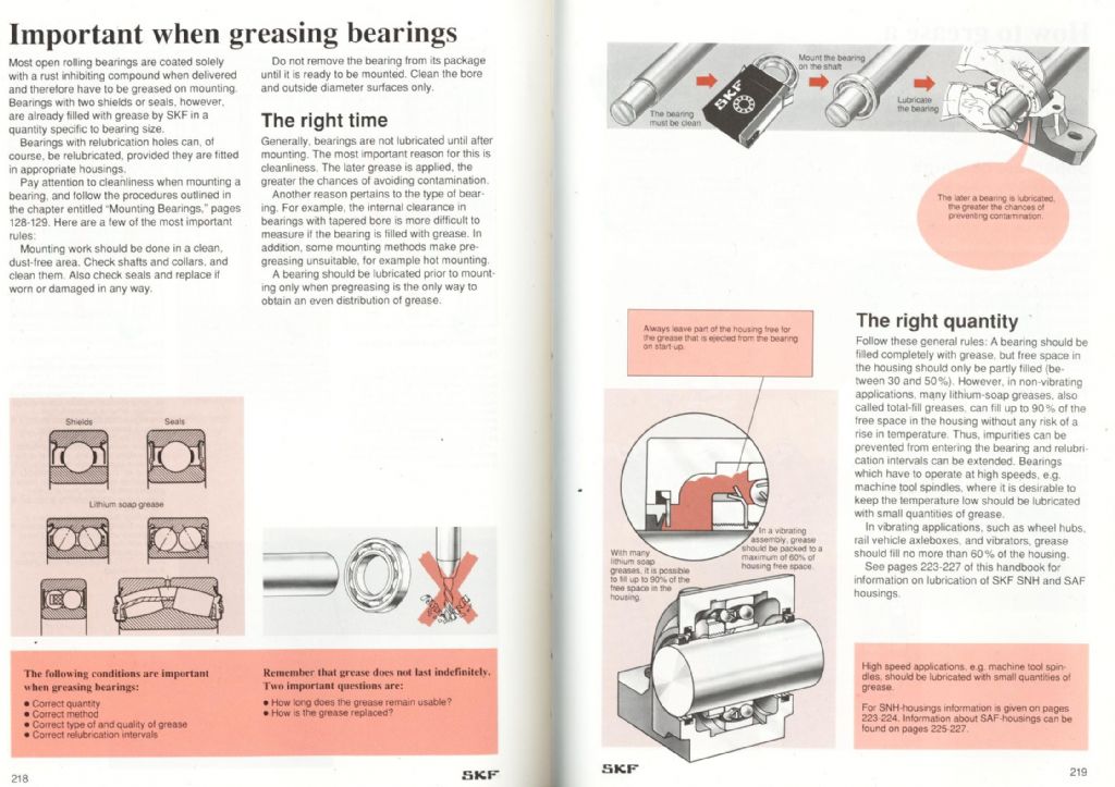

                            Hi, below is an extract from a SKF bearing maintenance handbook.
                            Bearings in general should be copletely filled with grease, but space must be left in the housing for any grease that the bearing does not need onece it is first started.
                              Not the case with machine tool spindle bearings, though. It is usual to fill 20-30% of the airspace within the bearing, as excessive grease leads to overheating. I visited the Bridgeport works in Leicester some years ago & their spindles were assembled in a clean room, with the grease pre-weighed in syringes that were used to evenly fill the spaces between the balls. The completed spindle assemblies were then run-in on a special test rig that built up speed gradually while monitoring bearing temperature – if it got too warm the spindle was stopped, allowed to cool then run again at a lower speed for a while before the speed was increased again.
                              At my last employment (machine tool rebuild & retrofit company) we worked in a similar way, though the grease insertion was not as precise as Bridgeports. We used Klueber grease (not all greases are equal !) & followed Klueber's recommended running in proceedure, keeping a temperature log to monitor running in. Starting by running at a low speed for 15 minutes, the speed was increased in stages for 15 minutes at a time & the temperture monitored (measured as close as possible to the bearings – usually up the spindle taper). The temperature was not allowed to exceed 50 degrees C – it it got close to that, the spindle was stopped, allowed to cool completely & then the running in started again at the speed below which the temperature had increase. The running-in procedure could take two or three days to complete on high speed (12,000 rpm) spindles, but if too much grease was used then the running-in period was either excessively long or it was not possible to complete it at all – then the only recourse was to strip the unit, clean out the bearings & re-grease more sparingly.
