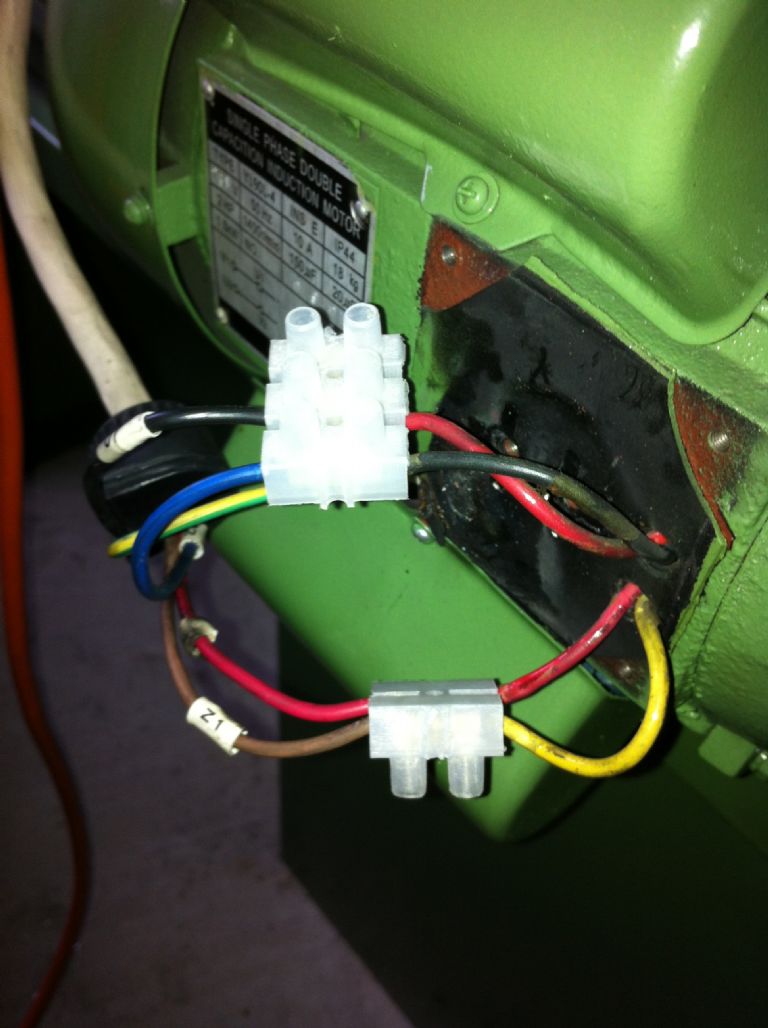

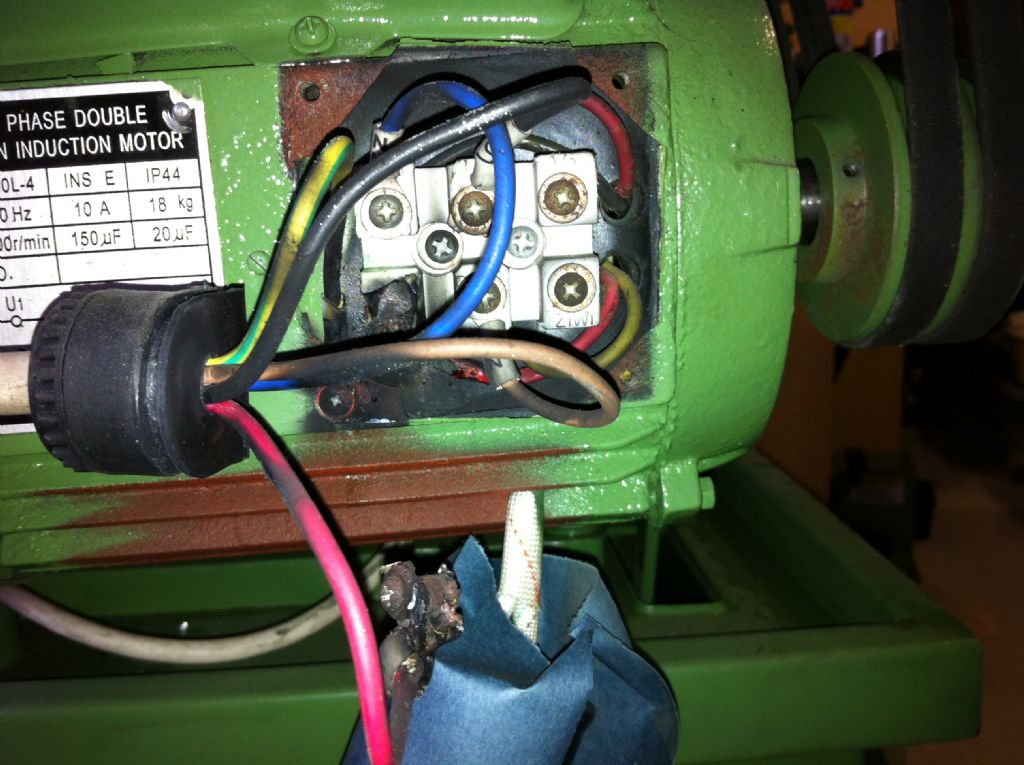

        #116775
        Sub Mandrel
          @submandrel
          Hi Mobnd,
          Is the motor actually blown, or is it just that the red wire worked loose and has sparked to create the mess?
          #116778
          M0BND
            @m0bnd
            A good question.
            I am not sure, but there is no longer a way of attaching the wire to the motor as I see it. I remember looking here when I first started using the lathe and checking all connections as the motor has never sounded correct since I have owned it (about 2 years now)!!!
            There are a couple more photos in the album I have created which may or may not show more detail.
            Andy.
            #116779
            Keith Long
              @keithlong89920
              Hi Andy
              It looks from the photos as though the wires down into the winding are fairly intact so with a bit of luck most of the problems will be in the terminal block and housaing. Make a note of what wires are still connected to what and then do continuity and earth checks on the wires to the windings. If the checks come out OK you should just need a new terminal block, which shouldn't be a problem really as all it is, is a means of connecting the wires up to the mains. I'd go for a ceramic connector personally which are readily available from most electrical merchants. If yo're not confident about checking the motor yourself have a look in the local directories to see if you've a rewind shop close by and get them to give you a quote for a quick inspection followed by repairs. It could well be cheaper than the new motor that you highlighted on EBay. I had a 1HP sigle phase motor done last year, full check over, supply and replace bearings, and some rewiring, £200 with a guarantee on the work.
              Keith
              #116780
              M0BND
                @m0bnd
                Hi Keith.
                Thanks for the reply, I didn't contemplate using a repairer but I will call a few 'local' motor menders on Monday – they may offer an exchange motor? They all seem around 25 miles away from where I am in a quick Google search. The replacement motor on eBay is 'only' £127 delivered so a bit cheaper than the £200 as you have paid previously. If, however it is a little ceramic or similar insulator that is required then I could easily do that work myself.
                Andy.

                    #116788
                    Speedy Builder5
                      @speedybuilder5
                      The motor plate says capacitor start + capacitor run?? Are the capacitors OK, and were they the cause of the burn out ?
                      #116798
                      M0BND
                        @m0bnd
                        Hi Speedy, all capacitors appear to be ok – clean with all contacts etc in one piece.
                        Neil (stub) – I showed the photos to a retired engineer who has their own machines and he suggested someone very close to get an insulator block and suggested the very same as you about a loose connection. I will try that first as it will be the cheapest at the moment.
                        Andy.
                        #116802
                        Andyf
                          @andyf
                          If I were you, I'd experiment, taking careful note of what connects where and to what else, then wire the whole thing up with chocolate block connectors and give it a brief trial run. If it works OK, then all you need is a connector block which is more heat-resistant than a choc block.
                          If uncertain about working with mains voltages, ignore what I just said, but if you can wire a plug you should be OK.
                          Andy
                          #116803
                          M0BND
                            @m0bnd
                            Thanks Andy F.
                            I have already taken more detailed photos and drawn the wires on paper. I am ok with mains voltage and I am prepared to buy another motor if all fails!!! The chocolate block idea is a good one, I just need to convert the crimp terminals to get them into one chocolate block hole…. Should be easy enough – maybe just buy some really big chocolate blocks!!! Thanks for the idea and tip.
                            Andy S.
                            #116806
                            Andyf
                              @andyf
                              Andy S,
                              Well, it needn't be choc blocks. If physically possible (in the sense that there's enough spare wire) a lump of wood with woodscrews through the connectors which need to be mated would work, though the screws shouldn't stick out of the back of the wood in case of -zap!-
                              I suppose that' would be breadboard construction at its simplest.
                              But from the photos, it looks like only one connection has blown. The rest of the discolouration may just be magic smoke condensate. Try connecting the loose red wire to the wire it mates with and leave all other connections in place. Maybe use a short screw and nut through the two connectors, and plentiful insulating tape.
                              Andy
                              #116807
                              Jens Eirik Skogstad 1
                                @jenseirikskogstad1
                                The rule: Bad contact -> high resistant -> fire. After you has fixed the problem, be sure all connections is secured good contact (clean surfaces), turn firmly at all contact screws (do not overturn then treads is stripped of)..
                                #116816
                                Brian Wood
                                  @brianwood45127
                                  Good morning all,
                                  Not a direct comment on the thread as it stands, but how many of us have rectified 'failures' with domestic appliances on non moulded 13 amp plugs, in that most are caused by nothing more or less than just loose terminal screws on the pins?
                                  And for that matter, why is it that the Neutral leg seems to be the one most often affected?
                                  Any answers?
                                  Brian
                                  Edited By Brian Wood on 14/04/2013 10:39:54
                                  #116824
                                  M0BND
                                    @m0bnd
                                    Temporary (or maybe permanent?) repair…
                                    … and she runs again…
                                    …just one last problem to sort out…
                                    This horrible banding – ew!!
                                    A massive thanks to all comments on here, as without them I would have blown £127 on a motor that was not required.
                                    Andy.

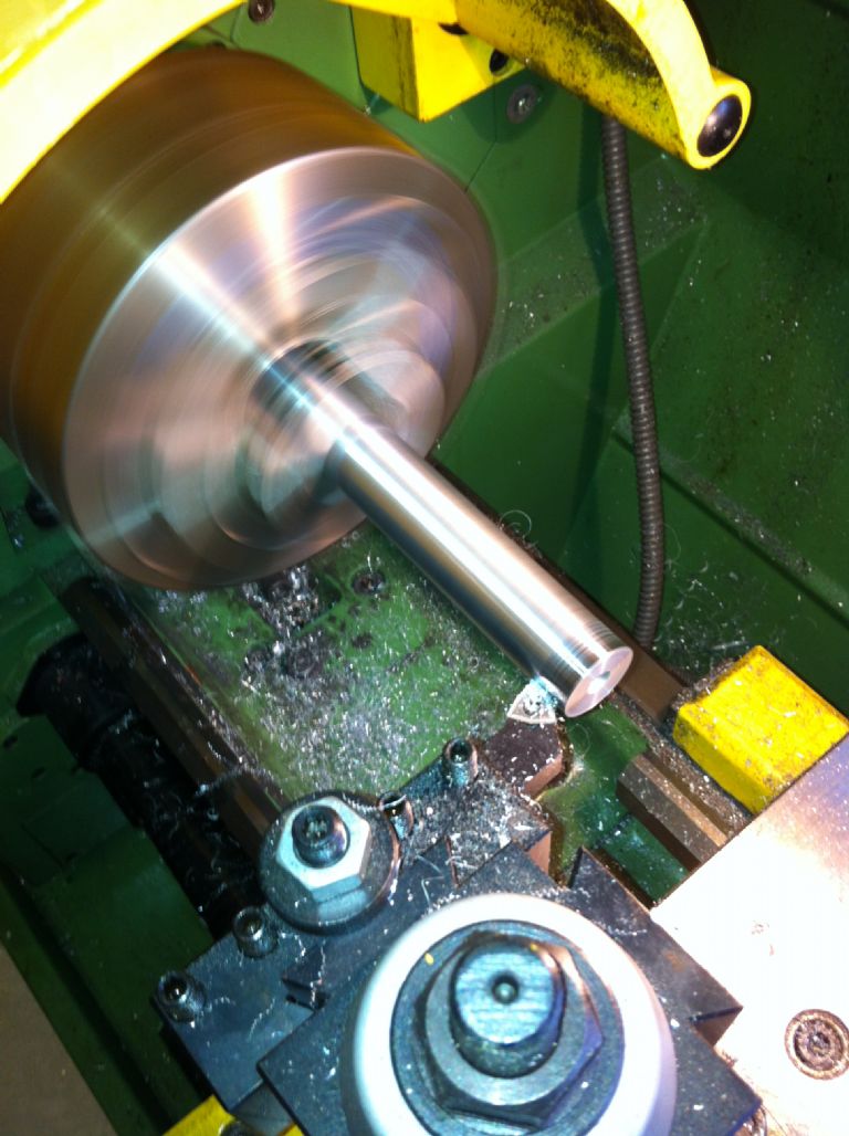

                                    #116829
                                    Anonymous
                                      I had multi-start banding like that on silver steel and stainless steel; turned out to be a badly worn hold down bolt on the compound slide.
                                      The first question would be; did the lathe produce the banding before, and if not, what has changed?
                                      Regards,
                                      Andrew
                                      #116836
                                      M0BND
                                        @m0bnd
                                        I think I will start another thread as this will get mixed in with a different subject matter.
                                        Andrew – When you say a badly worn hold down bolt, what do you mean?
                                        Andy.
