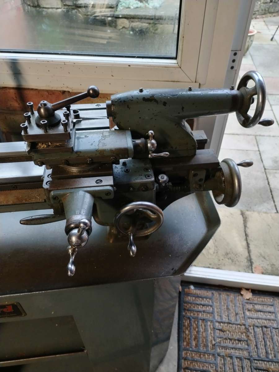

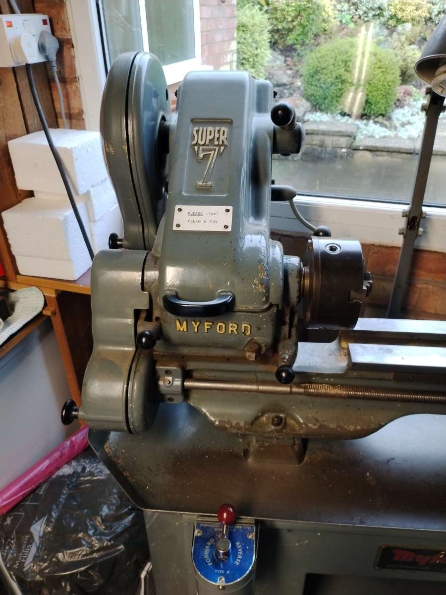

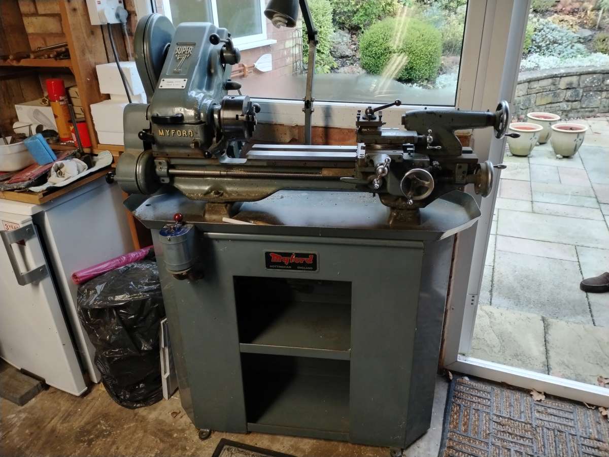

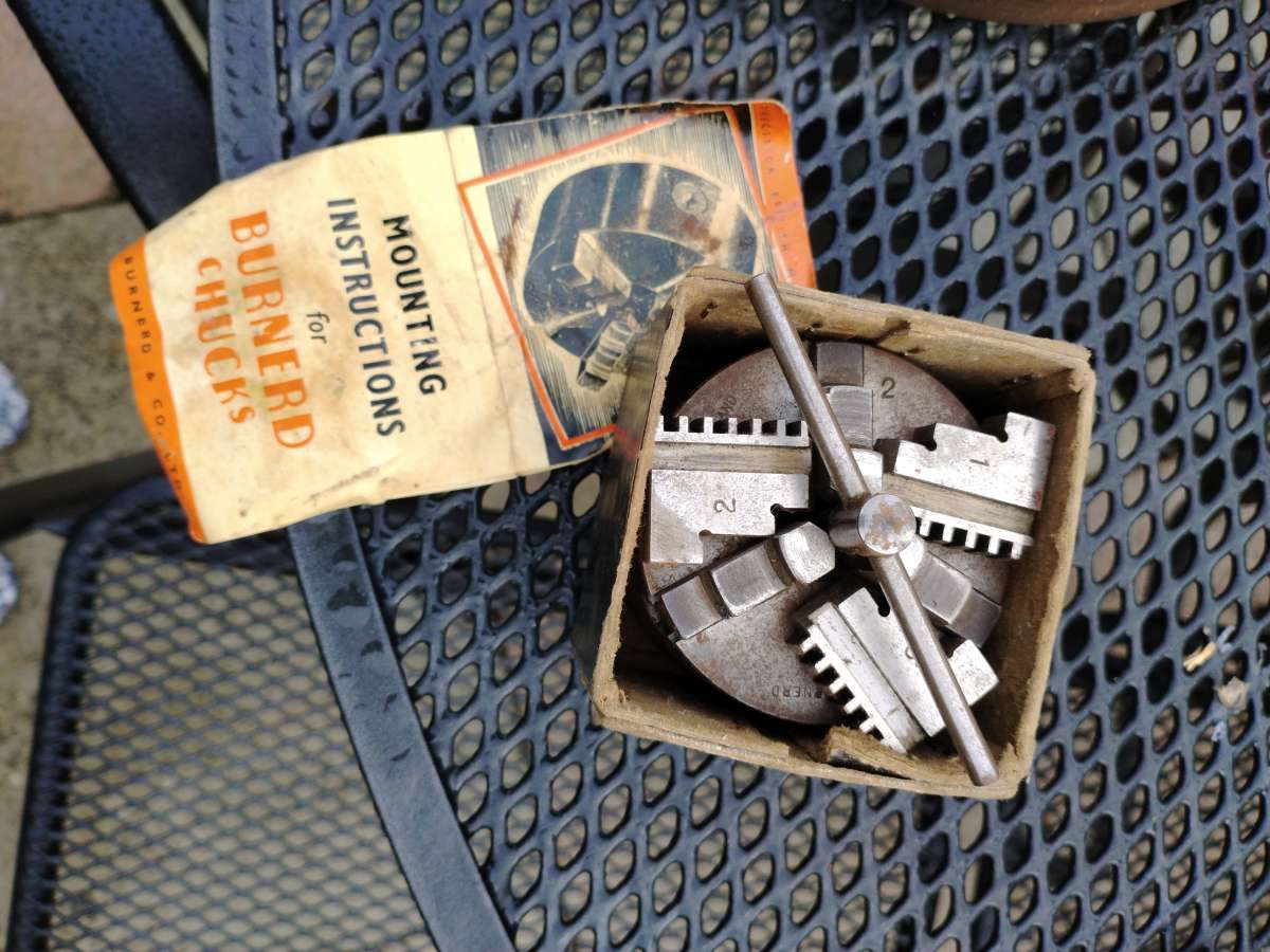

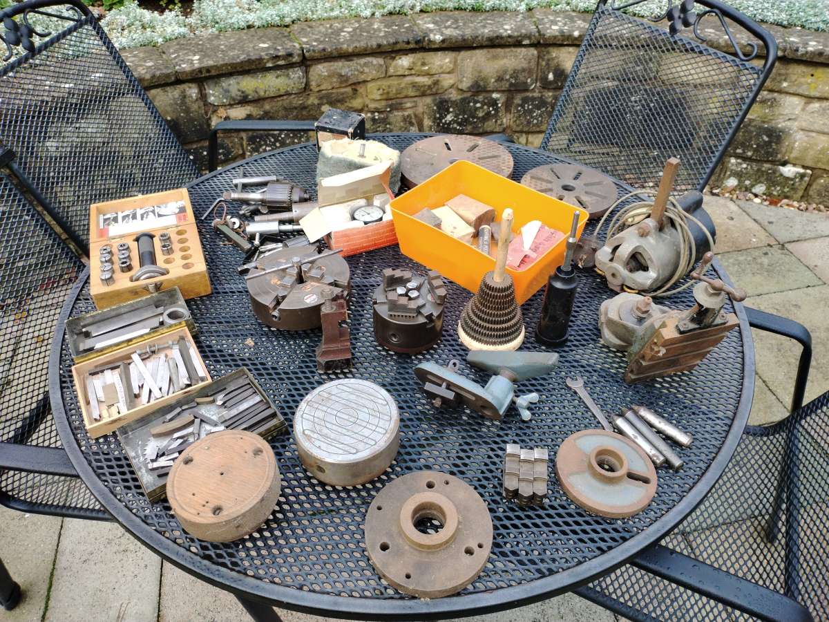

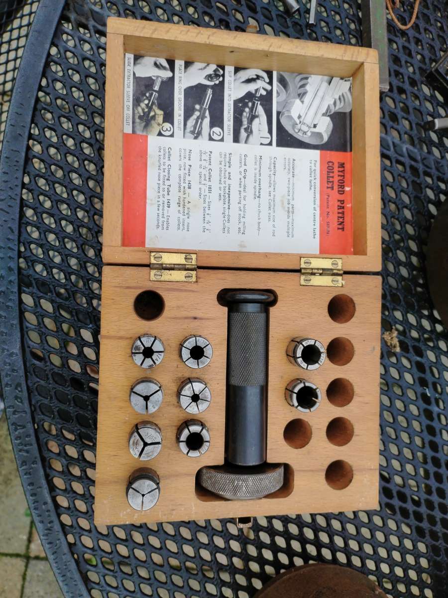

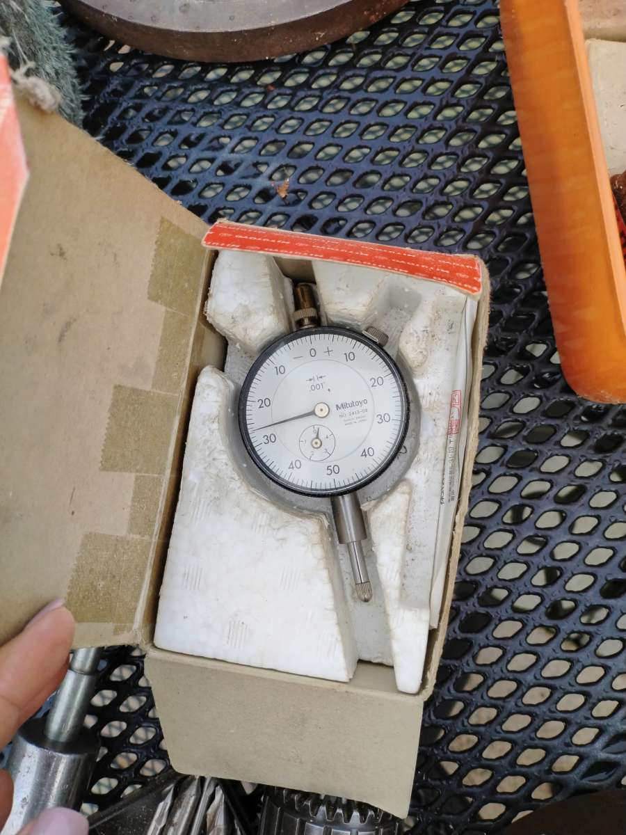

      I am looking to see my father’s lathe, but we really don’t know where to start! He’s had it for over 65 years and it’s still in good working order with lots of accessories (as per pics). Any advice would be most welcome in terms of what we should ask for it and where to put on sale. Thank you!IMG_20251109_093458IMG_20251109_093511IMG_20251109_093828IMG_20251109_093853IMG_20251109_093915IMG_20251109_093927IMG_20251109_093937

            The lathe in the picture would not be a particularly desirable one without the gearbox. We would struggle to sell it for a meaningful price.

              Accessories and a stand bump the price up. so list them carefully.  Many buyers will want to see and test the machine before buying, so have it plugged in ready to go, if you can.
              Condition is hard to assess from photographs.   Not seen one for a few years, but tarted up Myfords used to be a hazard – badly worn and damaged machines stripped, cleaned and painted by chaps with little experience of machine tools.  Conversely, lathes in good mechanical condition often look tatty.  What you have looks like an honest machine to me.  Less likely to be worn if dad used it infrequently.

                Looking at it from a different angle. You need to list it’s serial number which starts SK????? (?=numbers) which is stamped under the bed rails at the left hand end. A picture of the lathe bed under the chuck for any damage is also called for. It’s power is via a Dewhurst switch which is now obsolete and prone to failure. It has raising blocks under the feet which is an add.
                It does not have a gearbox which is a minus, but it does have cogs. You need to open up the door at the left end and picture what is inside which I guess is more cogs on a quadrant piece (a holding frame in literal terms).
                It has basic tool holding facilities only which is a minus, but lots of high-speed-steel (HSS) cutting tools to get a beginner started.
                Within the other bits in the picture on the table, There is what looks like a chuck back-plate at centre bottom. The round item to it’s right is a catchplate and there are two other round Faceplates at the back, 6inch and 9 inch. At about 2 o’clock from the back plate are the 3 external holding teeth for the cog fitted to the lathe. At about 10 o’clock from the back plate is a magnetic chuck which has value itself. At 3 o’clock on the table is an old style 3-slot Swiveling Vertical slide which does not have much value, and towards the centre behind the backplate is a toolrest which could be used with a gravure for metal scraping or a wood turning accessory.
                Behind the Vertical Slide is something electrical. It seems to have a square fitting to go into the square tool holder on the lathe. You need some better pictures of that and the plug end suggests it is not mains driven so may have a separate power supply somewhere.
                The dial gauge in its own picture needs to 0.0001″ to useful and have value.
                Any other feedback like this would help ruthw.

                    Two mag chucks !!!!!!!
                        Dennis
                        Why? I’ve got a tenths clock, it hasn’t been out of it’s box in years
