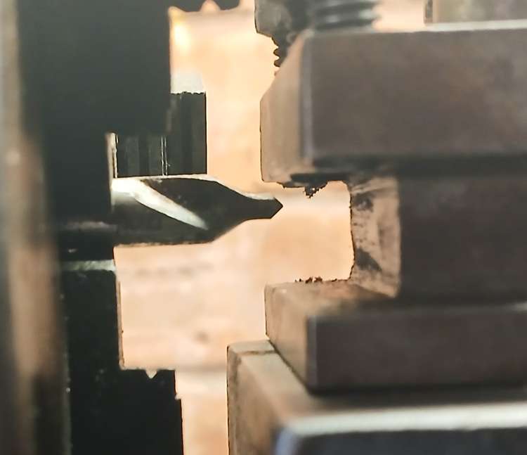

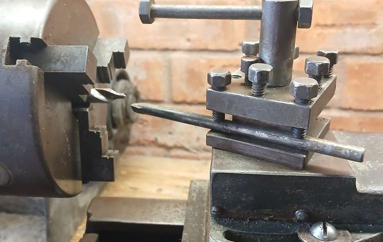

      My lathe (Myford ML4) came with very minimal tooling so I need to buy boring bars etc. There’s a wide choice of shank sizes to choose from, but how to determine what size I need? Obviously it’s more of a pain if the cutting edge is too high, so my presumption was that I shouldn’t use the largest size that would fit.
      As a demonstration of relative heights I’ve put a centre drill in the chuck
      lathe ctr 1
      lathe ctr 2

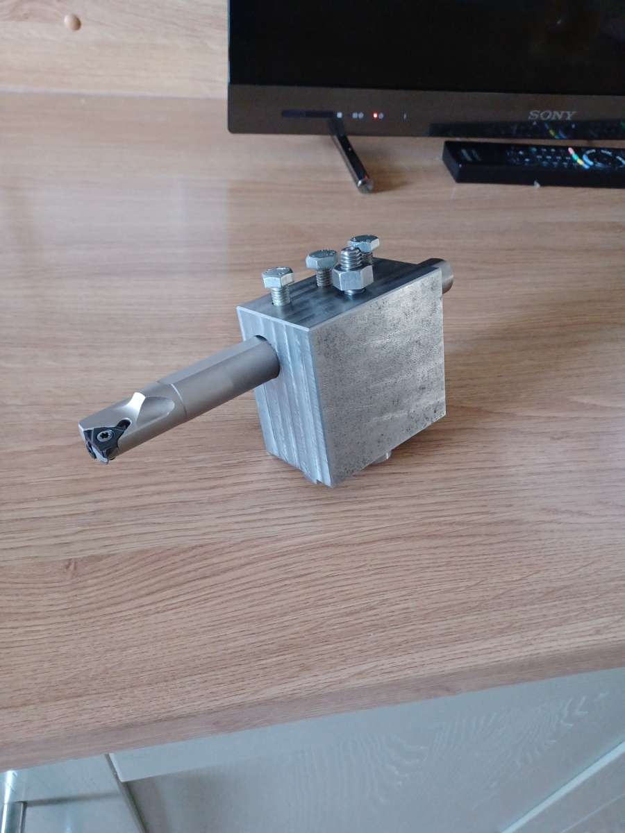

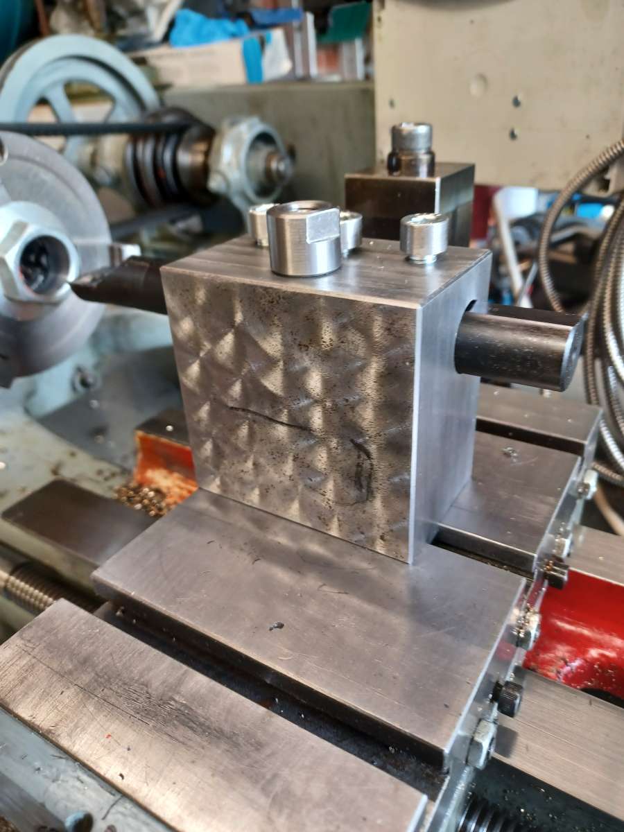

                        David George 1
                          @davidgeorge1
                          The tool height on a boring bar for exchangeable tips are on the centre height i.e. centre of the shank diameter so if you drill and ream a holder using the drill in the main spindle the tip on a boring or screw cutting bar will automatically be on centre height. Recently I needed to bore and internal thread a 1.250″ thread and the thread insert and the smallest shank diameter is 20mm  so I made a solid block to replace the tool post drilled and reamed a hole using the spindle which makes it perfect for larger jobs as well with a larger boring bar as well the clamp screws on top hold the top clamp the boring bar strait and flat. It only takes a couple of minutes to swap the tool posts on my lathe or if you like put it further along the top slide to use it.
                          20230702_201251
                          20230811_160611
                          David
